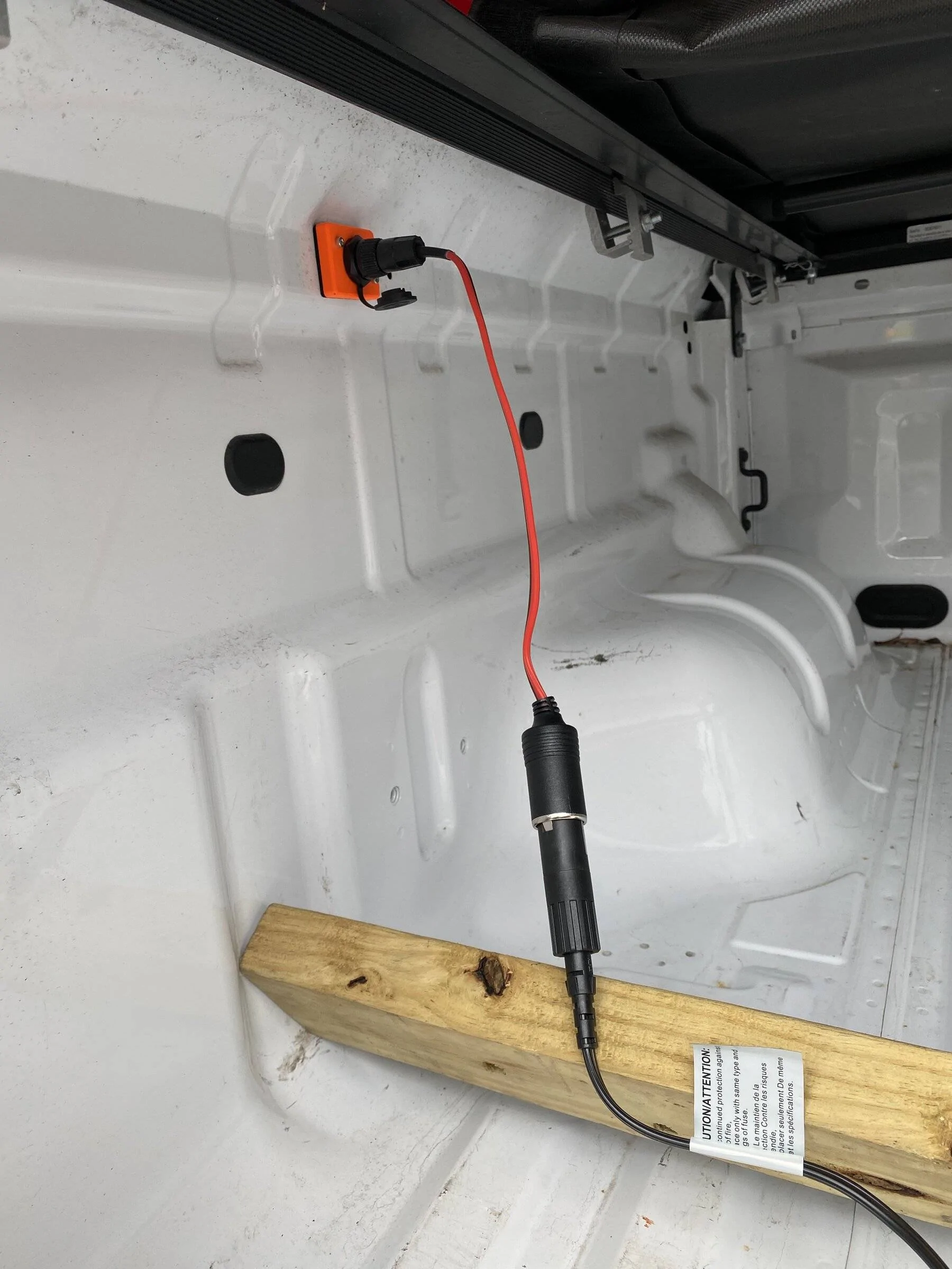

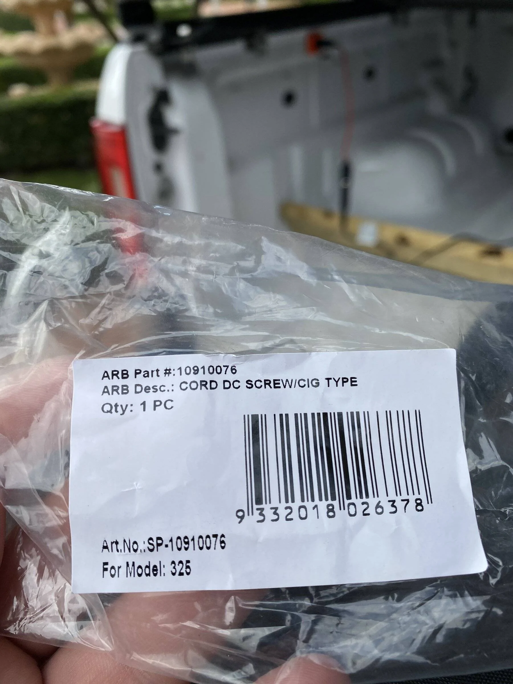

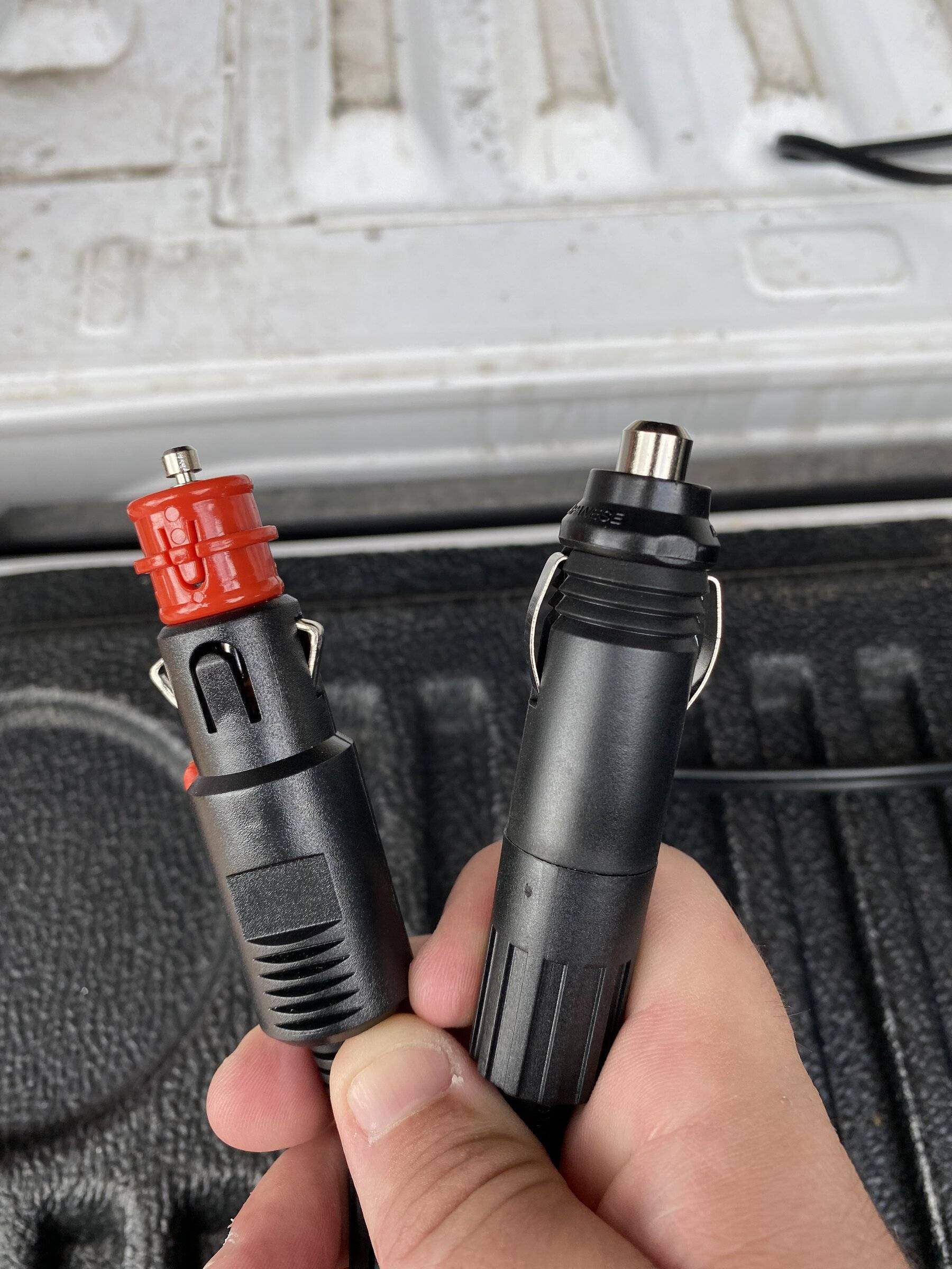

There was one issue I forgot to mention with my Iceco refrigerator, and it’s the cheap 12v Cigarette cable that comes with it. Some of the reviews mention a similar issue with it being able to be nudged loose and the fridge losing power. I noticed the same issue with my brothers light, they both share a similar male end that doesn’t hold well inside the female end.
Luckily I read that the ARB cable can be used as well, and that one has more resistance when hooking it up. I’ve attached photos comparing the two(red is the one that came with the Iceco), and the part number for the ARB.

Thanks for the reminder about the cruddy plug from IceCo and a much better fix than what Jasonoid suggested - he spliced his cord. This is a much better solution. And another $30 gone lol.
