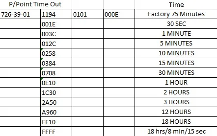

Here is my quick ref chart for adjustment
BCM: 726-29-01

Excellent. Thank you.
