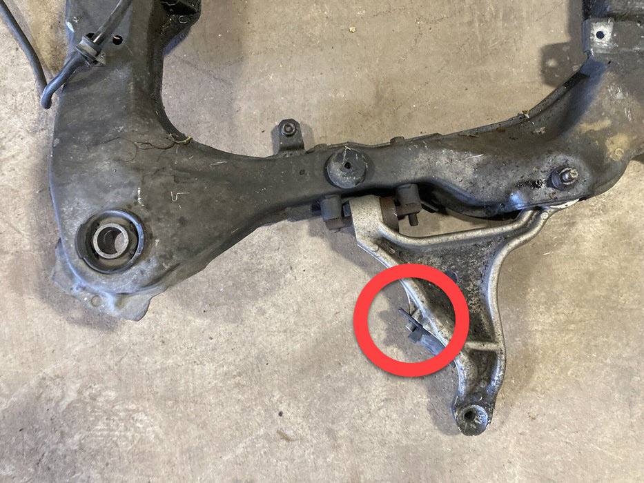

a cheap thrill of big tires without doing the whole thing right,
A rim with an offset might be a better way to go or a taller Lift like a 3.5
I have 285/75/17 and mine does not rub and I still have my crash bars
there is a little bumper flap that is bent back for whatever reason, it rubs on sometimes when backing....
and damnit it is loud!
you get the ground clearance you want from your tires, because that brings the axles up too, then you lift the body just enough to clear the tires from rubbing on anything ....
"a cheap thrill of big tires without doing the whole thing right" isn't quite my situation. I decided I wanted to go a bit bigger tire size from stock and researched options that would work with the Fox lifted I'd previously installed and no rub.
From everything I gathered, some folks experienced a rub at that size, and others did not, depending on the make/model of tire. Seemed rather hit and miss.
When I spoke with the Ford performance shop who installed the lift, they recommended the P285/70R-17 Yokohama Geolandar I referenced earlier as tires that would not rub.
I get my tires from Tire Rack, so reached out to them and asked if they had any data or advice on this model/size tire and they said it should be fine from their experience.
Tires were shipped to my local America's Tires for install and I asked them to let me know if there were any issues (I had to work out of town that day, my son dropped truck off for install)- they said after install everything cleared and there was no rub.
When I got home from travel, drove the truck to the store and pulling a hard right to get into a tight parking spot, felt the rub against the control arm right away. Chalk it up to my inexperience regarding load on suspension. Now I know better...
So now, I'm just trying to understand what my options are.

I think if you loosen the bolts on the crash bars there might be enough play to move them forward a 1/4 inch? then tighten them back up ...
Awwphooey
Jan 21, 2022
Northern Cali
19 Ranger XLT 4x4, 96 Ranger XLT (365K), 01 Explorer XLT (385K), 00 Mustang GT
Thank you. Tires are clear of the crash bars though, appears they're hitting the control arm when there's load on the suspension.
