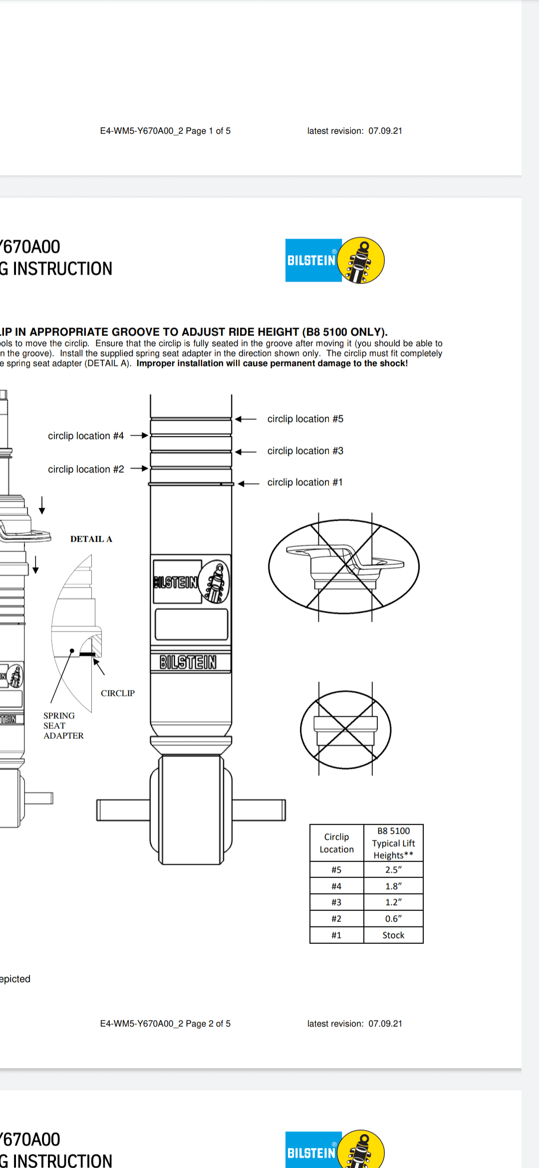

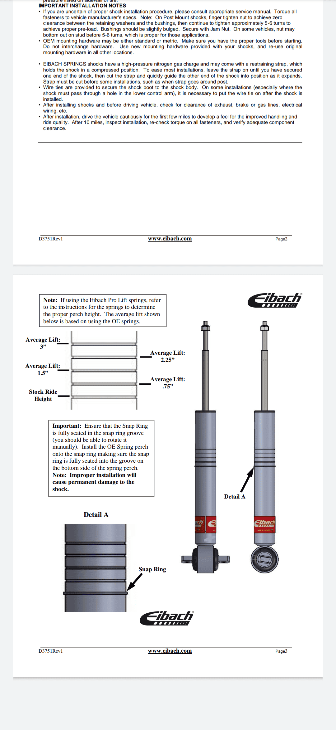

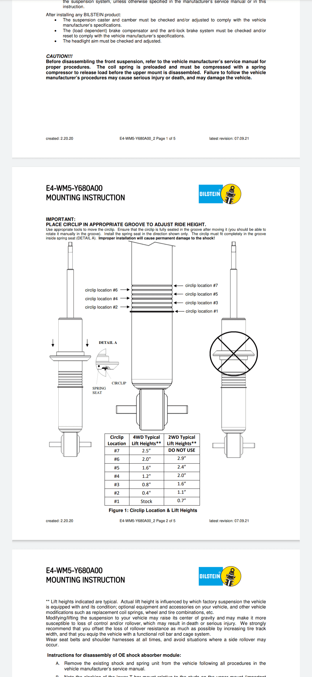

Fair enough. After taking a quick look at Eibach and Bilstein I suspect you are looking at the collar adjustment for height correct? To be more precise the stage 1? If so it does not look like the Eibach will get you where you want.
As for Bilstein you would have a chance. If you look at the pictures I just took it seems with the simple collar adjustment Bilstein may be a better bet and similar on price.

Now if you are looking at the stage 2 Eibach then its just taking the time to set the height with a.spanner wrench
