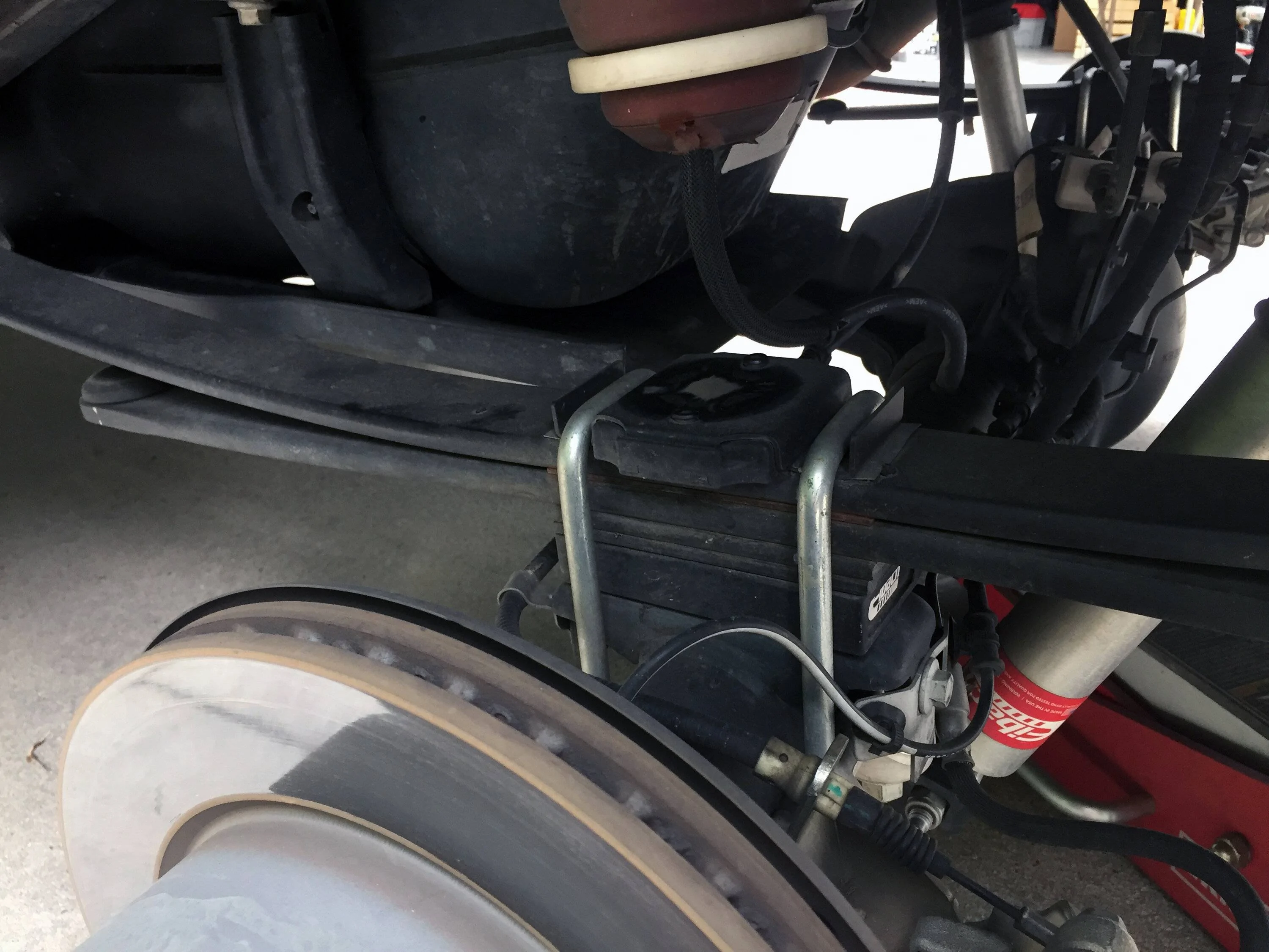

Hey Guys, considering lifting my tremor up a little bit for some more clearance. Currently running the 1.0 inch level with 33's but frame is still getting close on some cross ditches. I'm thinking about going with an 1 inch eibach rear block as well as a level spacer up front but was curious what size spacer to get to level it out.
The 1 inch i have didnt fully level it out so Maybe a 2.5?

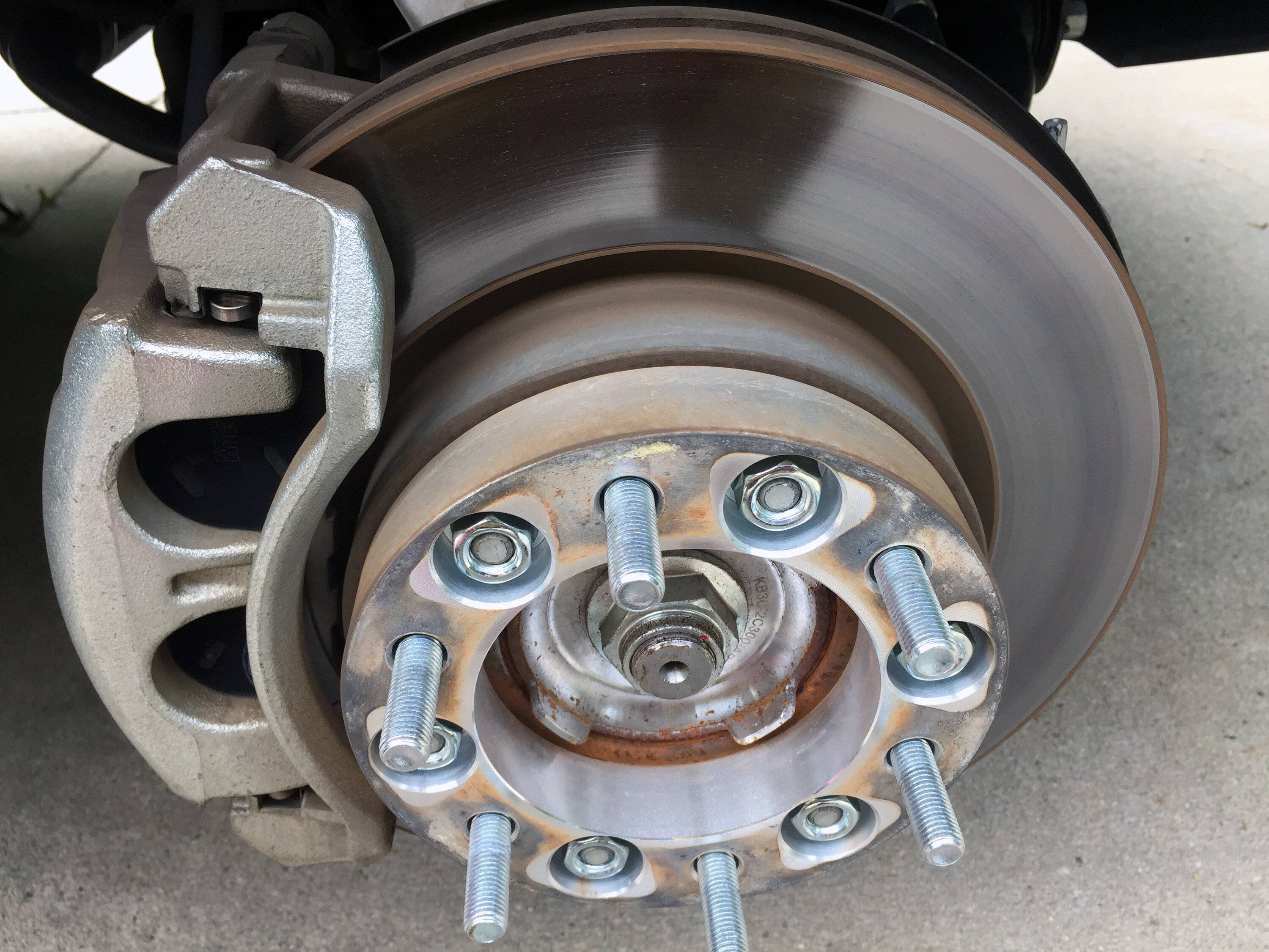

currently got a 1 inch wheel spacers and 1 inch FRL level in the front. Which is more like a half inch plate !

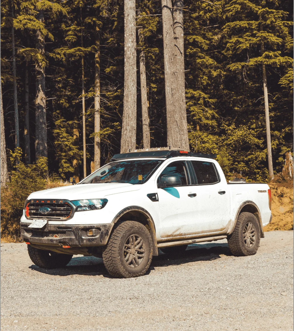

Personally I would get rid of the wheel spacers first. That will help you gauge where the wheel and tire are with the leveling kit. To my understanding the Tremor wheels already poke out more than the Factory Sport wheels. I know the Sport wheels are +55. If I remember correctly the Tremor wheels are +42(could be a little off) Wich is roughly 1/2 an inch difference for each wheel.
Where am I going with this? Well I'm suspecting if you remove the spacers you won't have the clearance issue you are having now. I had my 2019 with the Old Man EMU Lift(2.4 lift front and 1.6 rear) with 285/70-17 Firestone Destination XT's on the Factory Sport wheels with no spacers. I only had minor rub at full lock. With the Tremor wheels it is possible I wouldn't of had the issue with the rubbing. This may be the same idea for you.
Pictures of the 2019 I had below

Something to also understand is the Factory shocks may not allow for much lift if any. Sometimes you can get away with 1 inch of lift, but not always the case. The front is a little different since the spacer is between the strut and frame. In the rear it doesn't change the shock mount.

If im understanding this right, if youre adding more space between the axle and the leaf springs you will introduce more axle wrap, guess it depends on what type of offroading youre doing. Be mindful of too much lift up front in regards to your cv axle angle to the hub.
