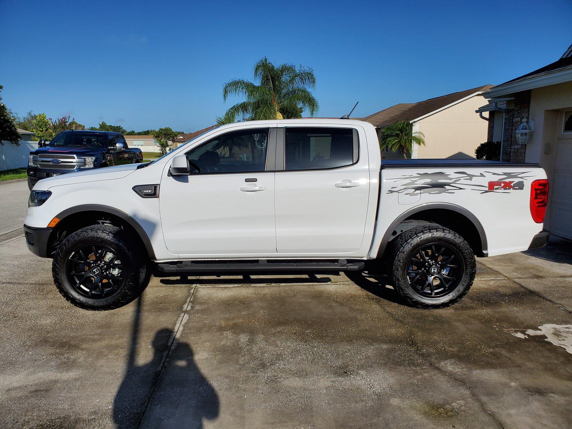

Looks great! Can you share how the install process was and the method you used for painting?
I didn't personally perform the work, the dealer did. I just supplied the parts.

Thanks. Looks great.

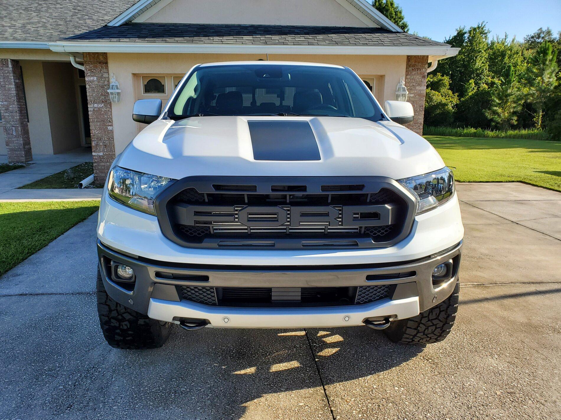

Looks awesome. I’ve thought about doing something similar but painting the mirror caps and handles in Magnetic to match the rest of the Sport trim similar to the Ranger Raptor look. The Raptor uses “Dyno Grey” for the trim pieces instead of Magnetic.

Damn Todd - just as I am finishing my mods you show me a new one!
I don't like the painted bumper parts on the painted trim package, but the door handles look great. I already have painted skull caps as I now have Lariat mirrors, but now I need to look into painted door and tailgate handles!
Thoughts on leaving my current handles off while they get painted? I have an auto windows module so I can use the remote to lower the windows and reach inside to open the door while the handles are off.

Painting original black plastic parts is actually a more difficult process than most realize. Usually the black plastic parts have a texture to them that if you simply paint/clearcoat them you will still see this texture and it looks bad. A person can carefully put enough Epoxy primer sealer over the plastic to fill in the texture before paint. What many end up doing is purchasing ready-to-paint plastic parts that have No texture.

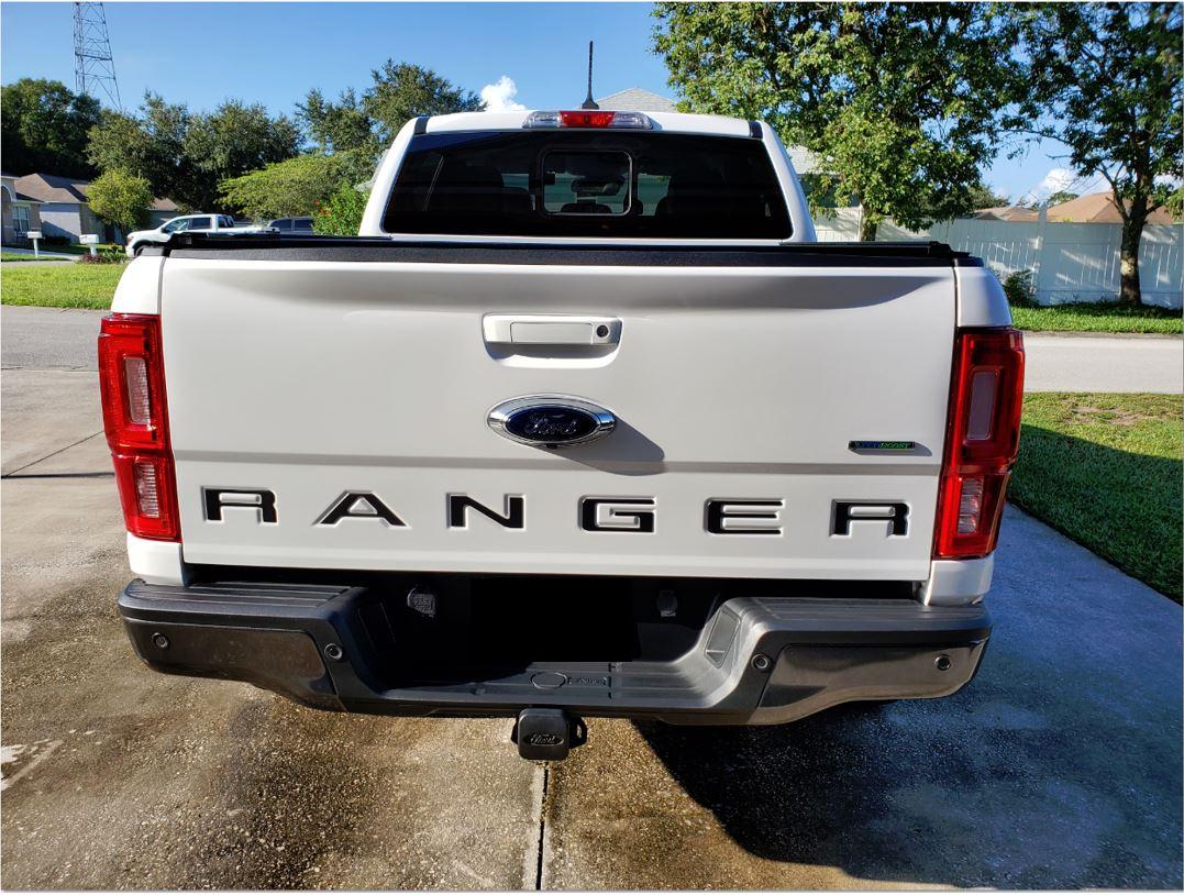

I purchased the XLT mirror covers and door handles and had them sanded smooth to remove the texture to avoid this issue. The tailgate handle is available smooth if you purchase once for a Lariat.
I wouldn't recommend it
