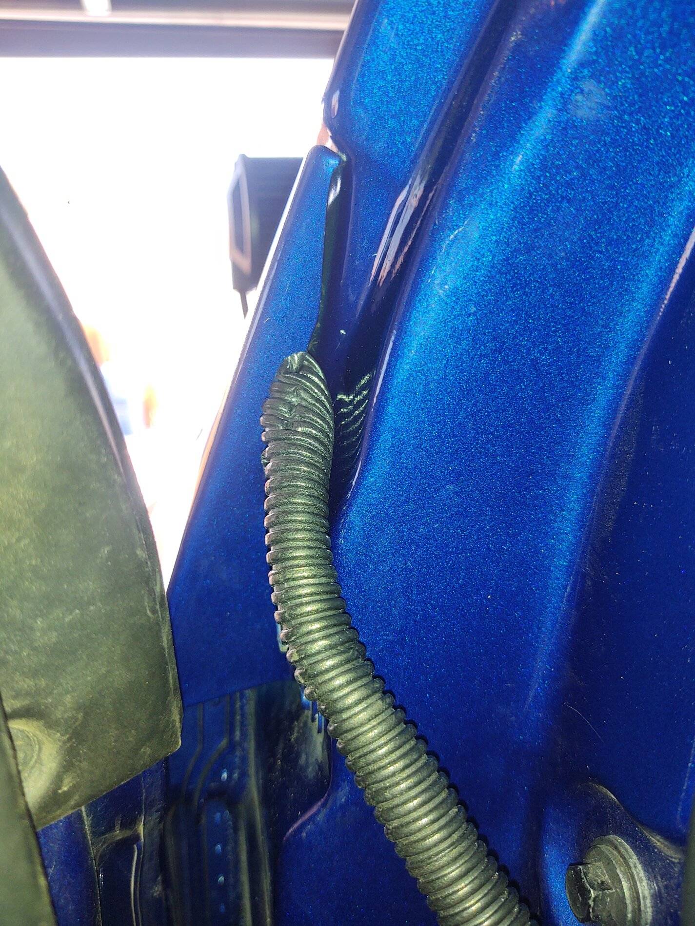

Where can you get thru the firewall for wiring up off road lights/switches?
The main wiring seems to be under the brake booster, and tights as hell on the inside.
I can't find a way thru.
This is not gonna work. Gonna year it out and start again.
Any help would be much appreciated.

Where the steering wheel goes through the firewall there is a rubber boot. Most go through that. There is a tool made for making the hole and then feeding a leader line through. Then pull your harness through. Another mentioned on here a grommet on the passenger side firewall that they went through

Thx. I shall look. Decided to head over to the glovebox area to see if there's a way thru. But the steering boot just caught my eye. Looks doable
