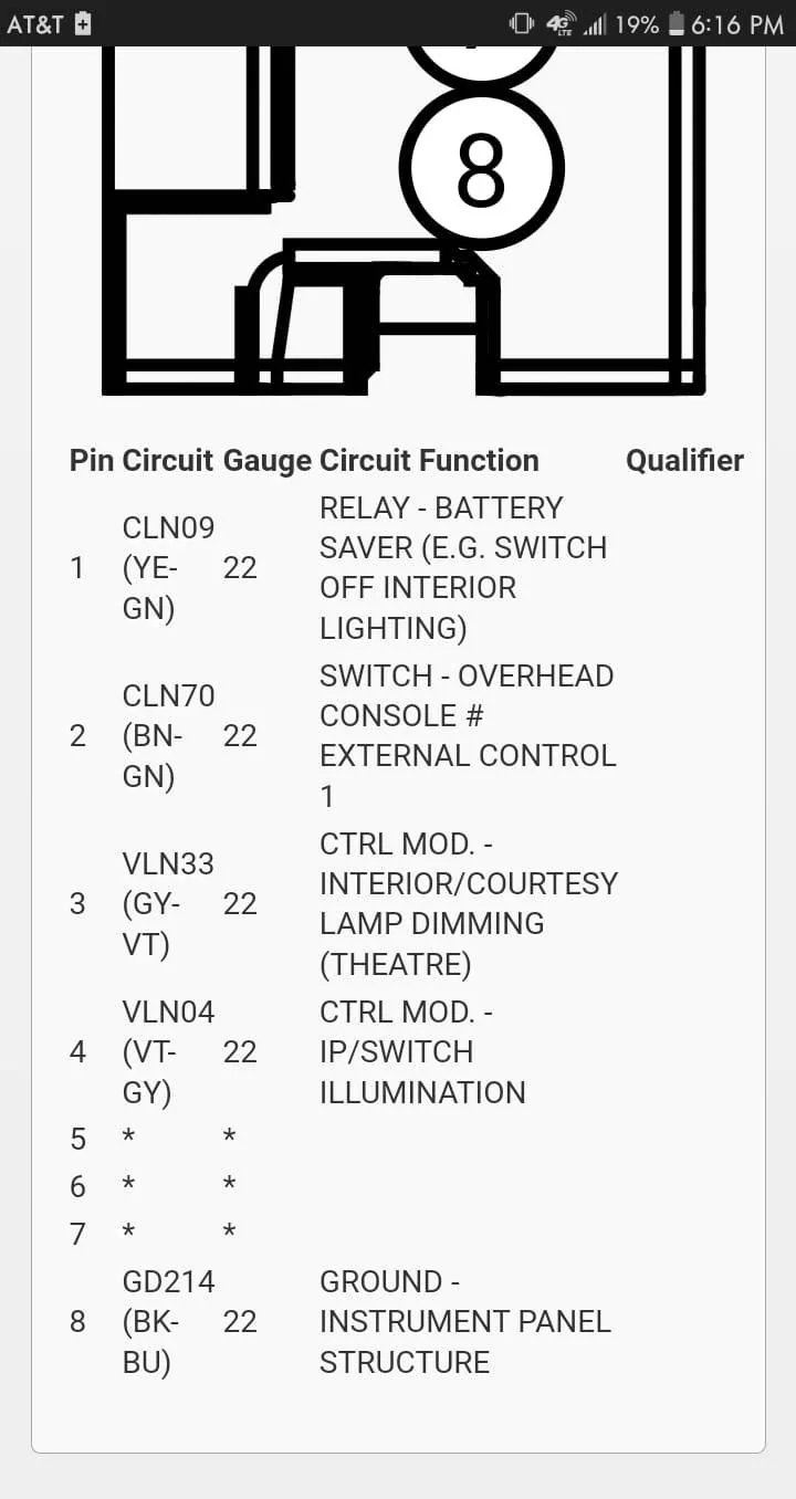

I am having a hell of time finding a diagram for these two items.
The dome light is 3 prong, we can assume two are power/ground, I don't know what the third one is.
The factory roof console is 5 prong I believe (maybe 6). Again, we can account for two of the wires, but what about the rest?
Any help would be greatly appreciated.
Where are you finding the 3 and 5/6 prong connectors? At one point I found the factory service guide on the forums but there were some links in it to the wiring diagram and troubleshooting procedures that didn't work.
