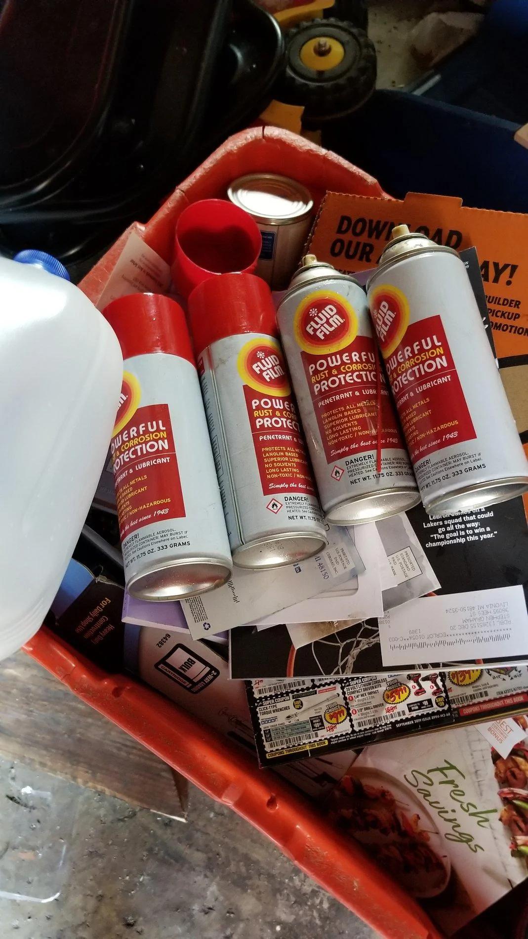

Used almost 5 full cans. Another can on hand to touch up just before snow starts. Fresh oil and tires rotated. Locating and greasing zerks tomorrow morning.
