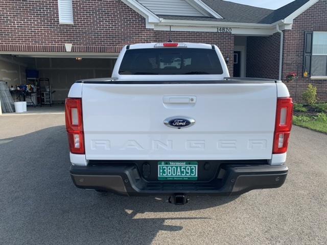

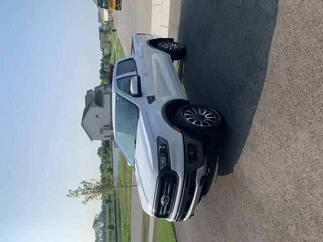

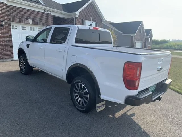

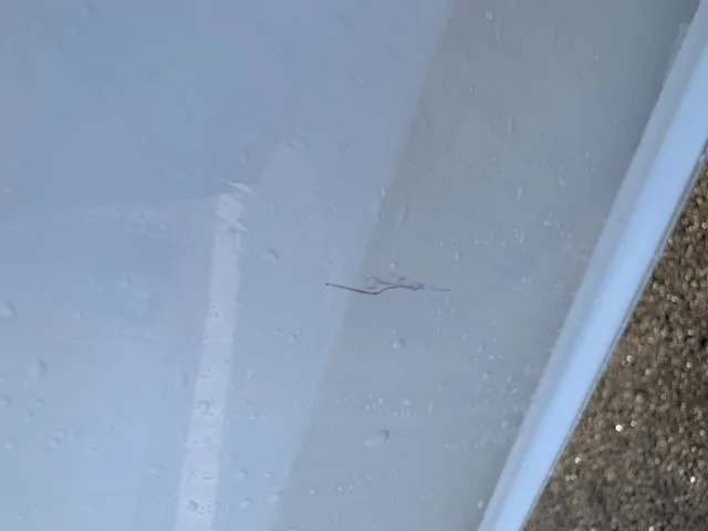

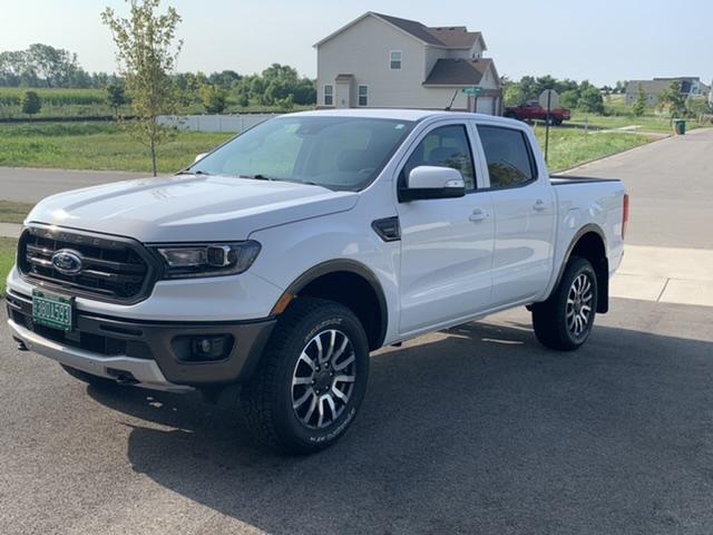

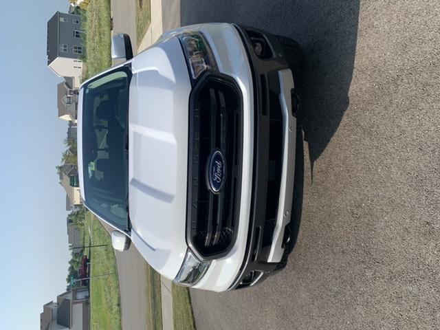

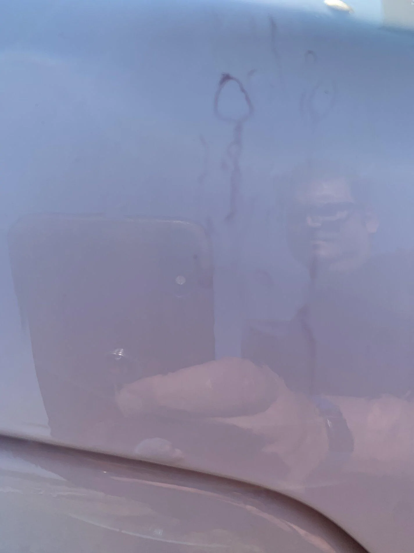

Finished paint correction after dealer ran truck through brush car wash prior to delivery. first I spayed truck down the truck with P&S iron remover then used stripper wash to remove whatever dealer put on paint. Used meguiors m110 with a Lake County microfiber cutting pad followed by a white closed cell faom pad with m220 polish. Washed truck again then used paint prep spray and ceramic coated entire truck and trim with wolfgang concours ceramic coating. Let cure overnight and then put P&S beadmaker over the entire truck and trim. The purple streaks in the closeups are the iron residue in the paint, truck was covered.
