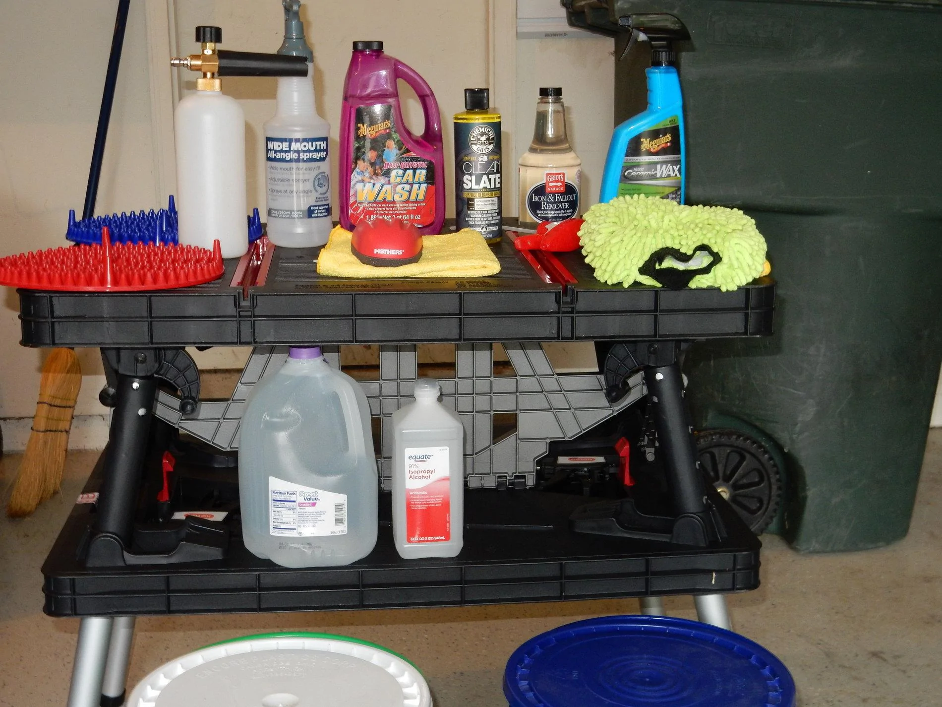

Talk is cheap but a picture is worth a thousand words!
First pic - Tools of the trade.

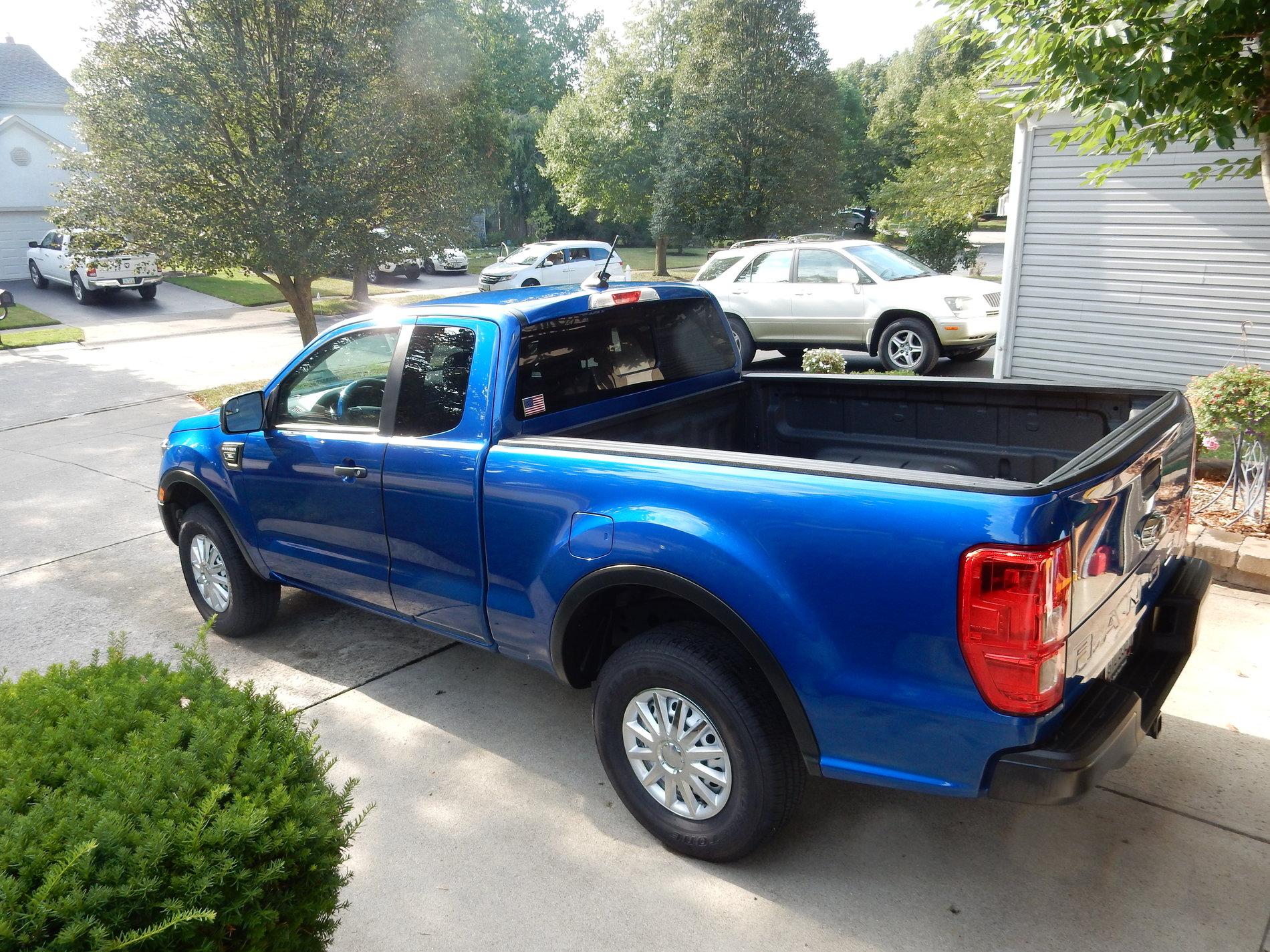

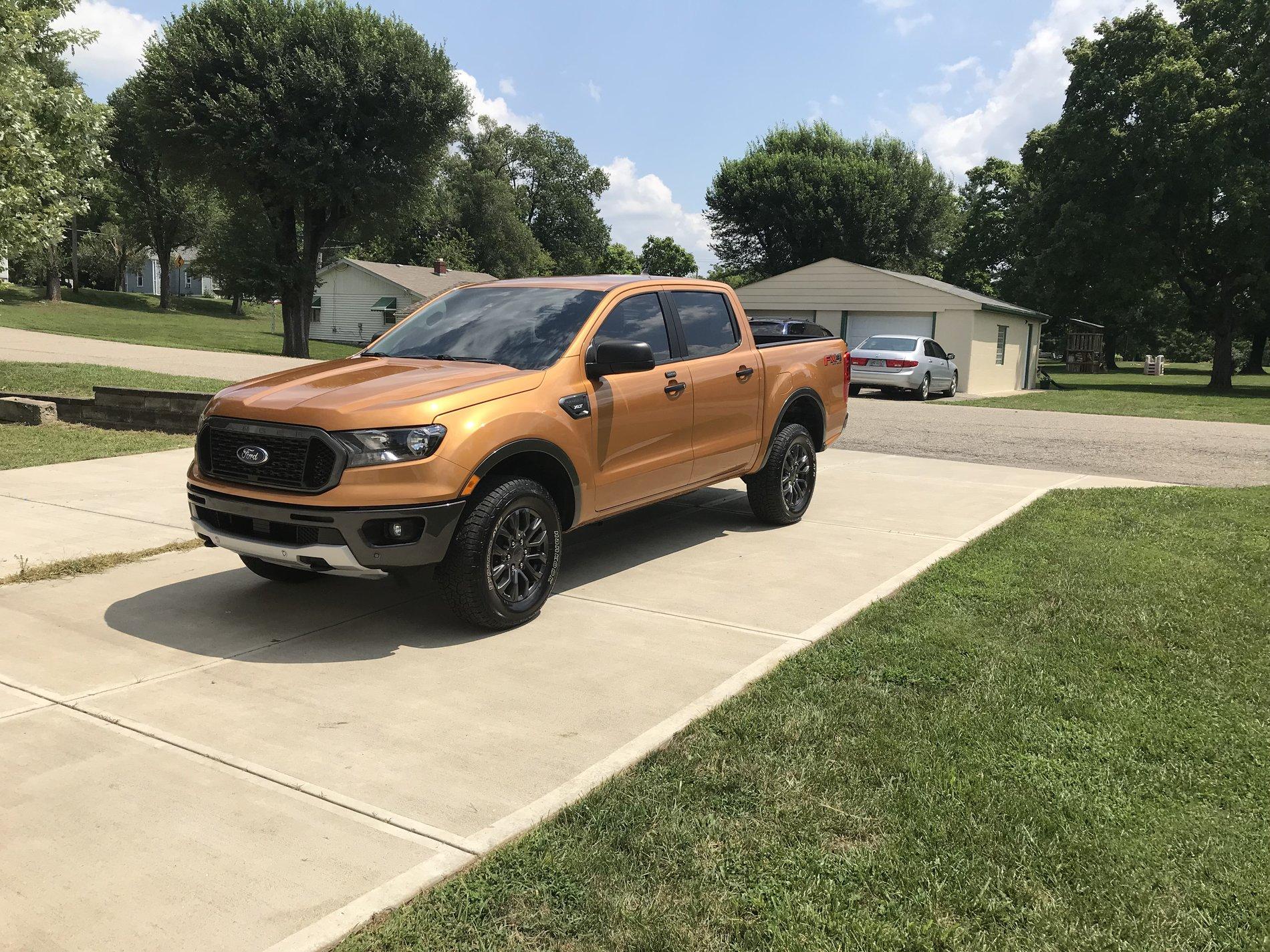

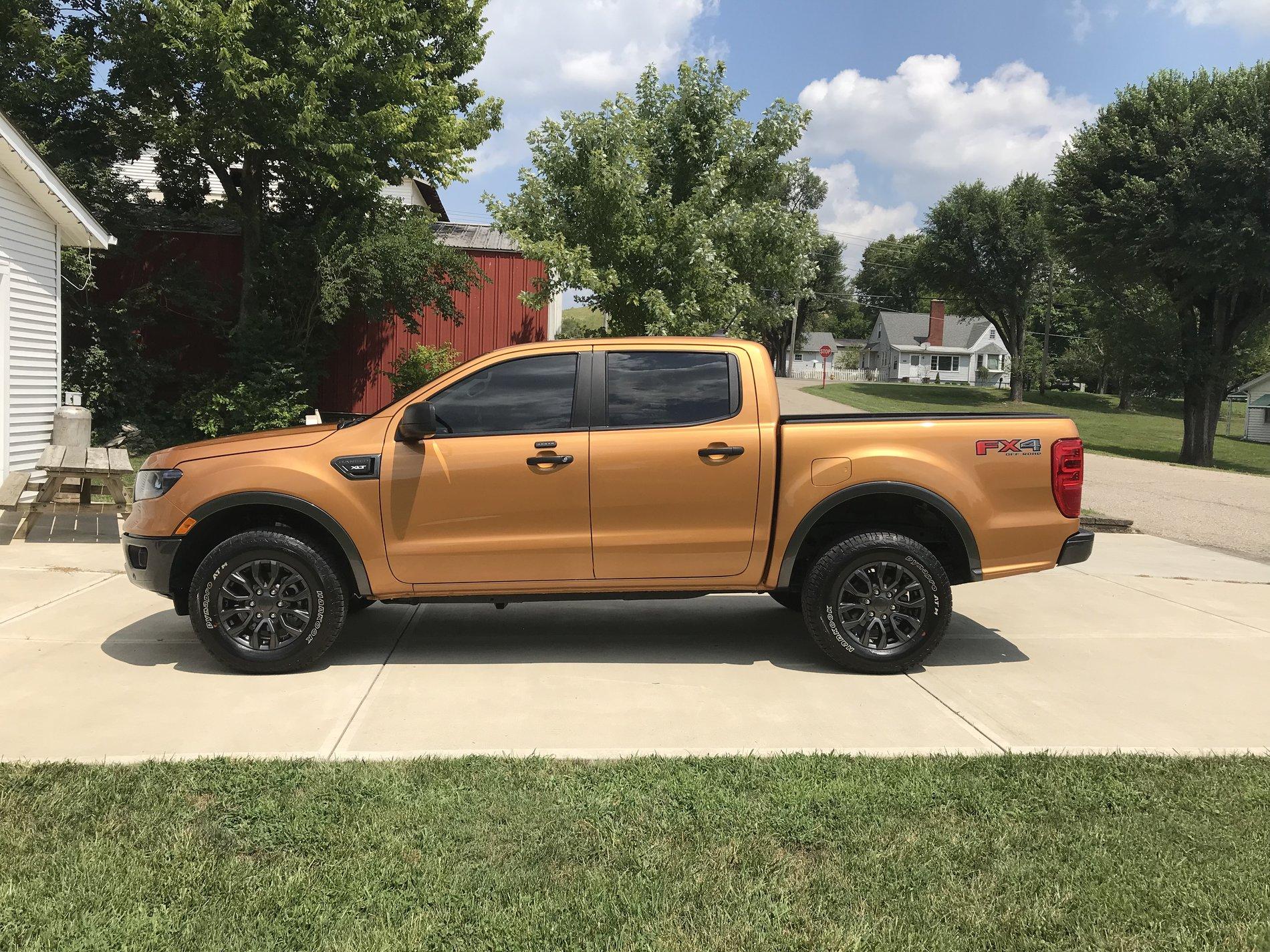

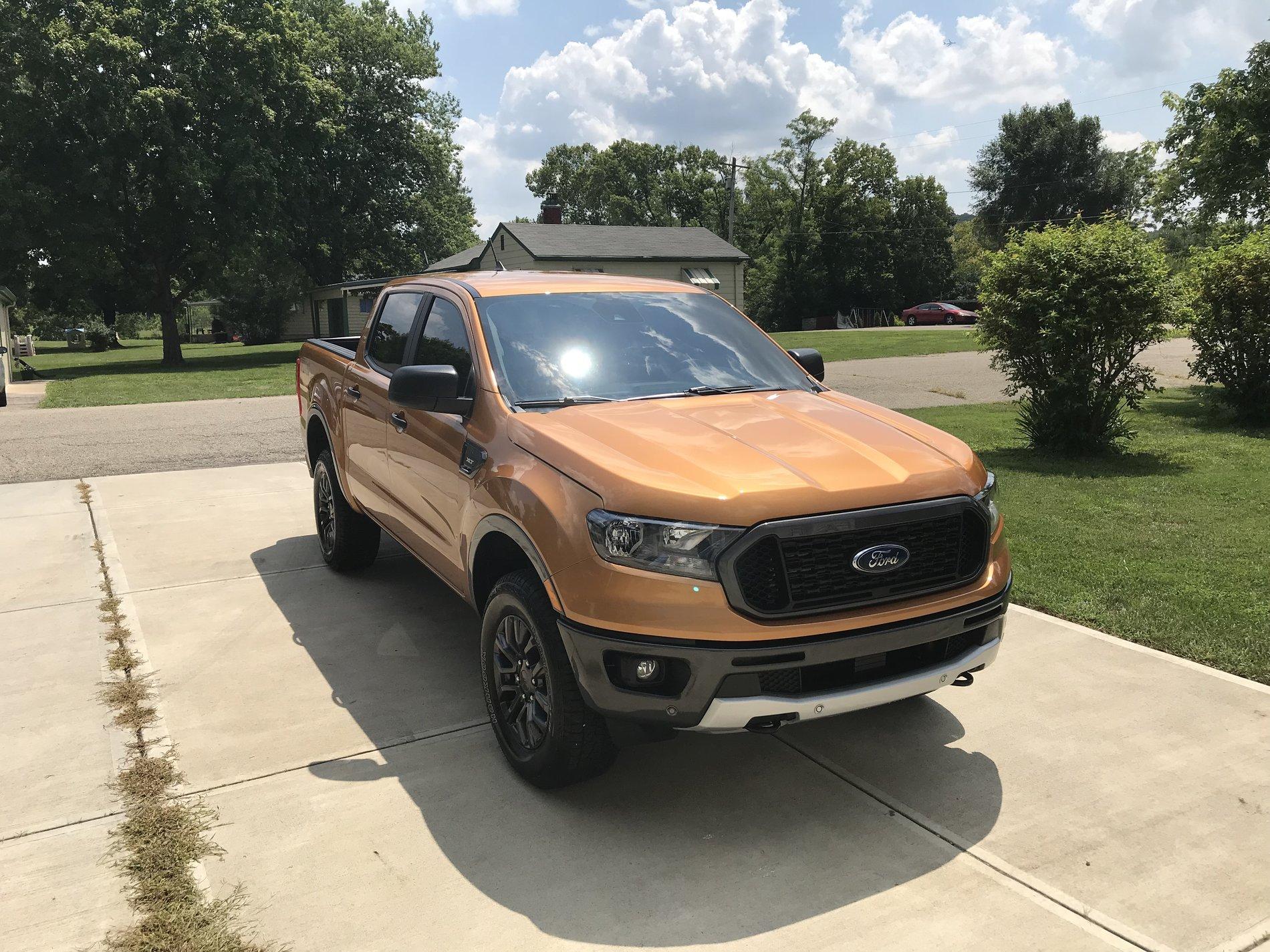

Second pic - my (metallic - paint code N6) Lightning Blue XL Ranger with only one coat of Mequiars (base coat)
Be sure to put your sun glasses on before viewing this picture or you might go blind!
