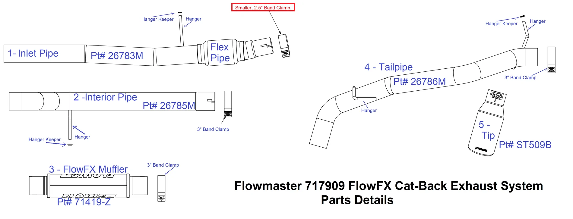

Purchased Flowmaster 717909 FlowFX Cat-Back Exhaust System (Best price @ time here WAS ABOUT $470 IN s&h: https://www.amazon.com/gp/product/B07YDYTYNQ/ref=ppx_yo_dt_b_asin_title_o03_s00?ie=UTF8&psc=1 . Amazon says it does not fit my truck. They are wrong Flownaster site says it does and indeed it does.). This is a 3.00-inch Mandrel-bent system made of 409 Stainless Steel Tubing. Not ridiculous huge, but larger than stock.

Installed per Flowmaster instructions. NOTE 1: There is one clamp smaller than the others. This 2.5" Clamp is used to clamp secure the Inlet pipe to the down pipe. Instructions re this are not super obvious. NOTE 2: I cleaned then lubed the rubber hanger thingys with silicone grease to help the hangers slip in easily, and to make then last longer.
