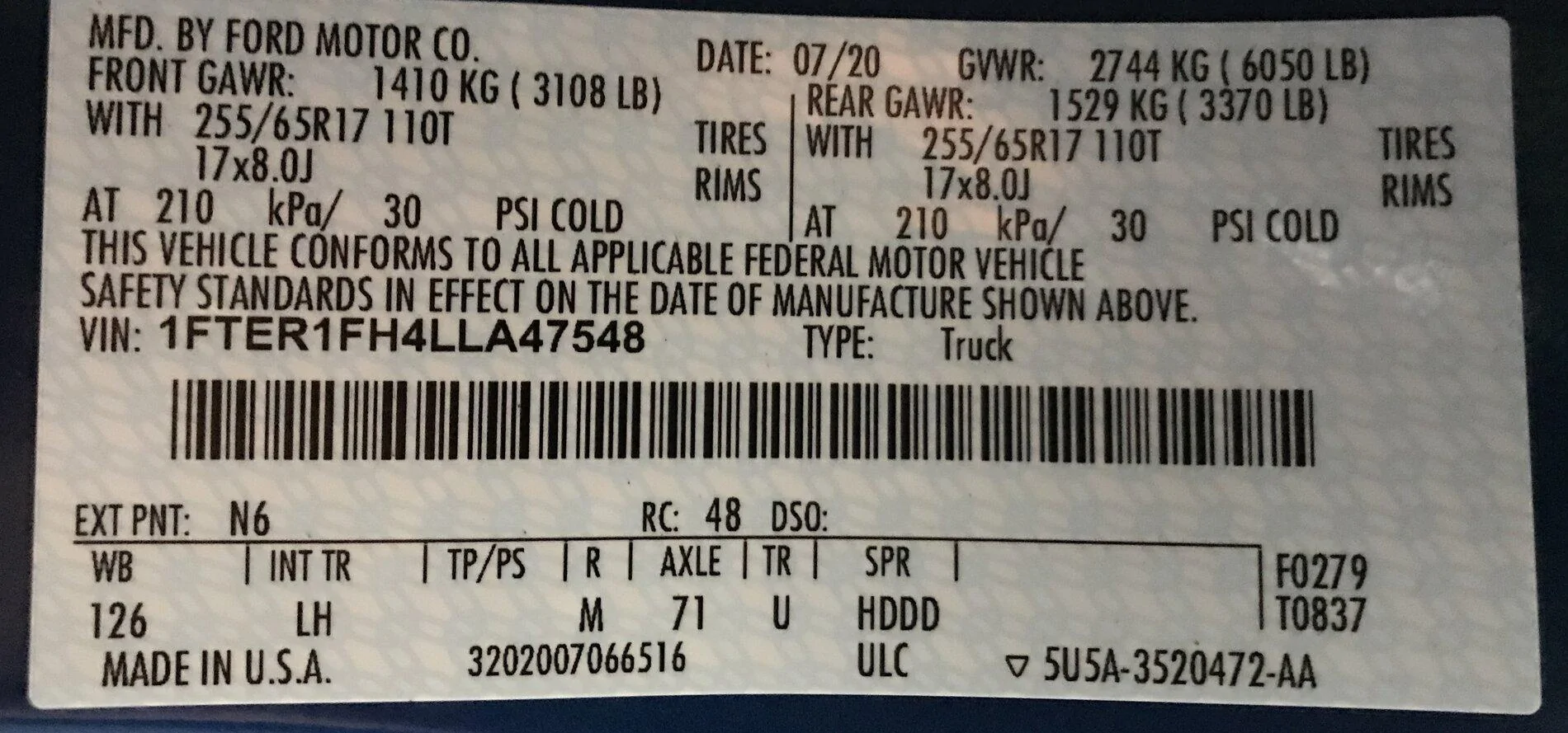

Looks like my manufacturing date is 7/2020? So, I’m not sure if this could still be the source or not. But, I will certainly mention this TSB at dealer tomorrow, for what it’s worth.
I was mainly getting at the speed your noise was heard at versus how they say to test for it.
Your truck was built on 7/6/2020 - you can see it in the number at the bottom of your sticker (3202007066516) - the number in bold is the actual build date. The last 4 are a sequence number Ford uses for scheduling - I'm not sure what the 3 is for.
