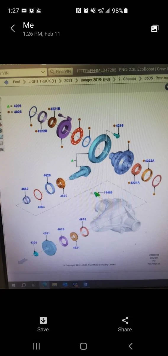

This is the exploded diagram I just got from my parts guy at Ford. Apparently the items with little circle attached to them come as a group, and the ring and pinion come as a group as well.
Curious to hear from anybody who has spent some time inside the diff to let me know what I should expect to find before I go tearing it apart.

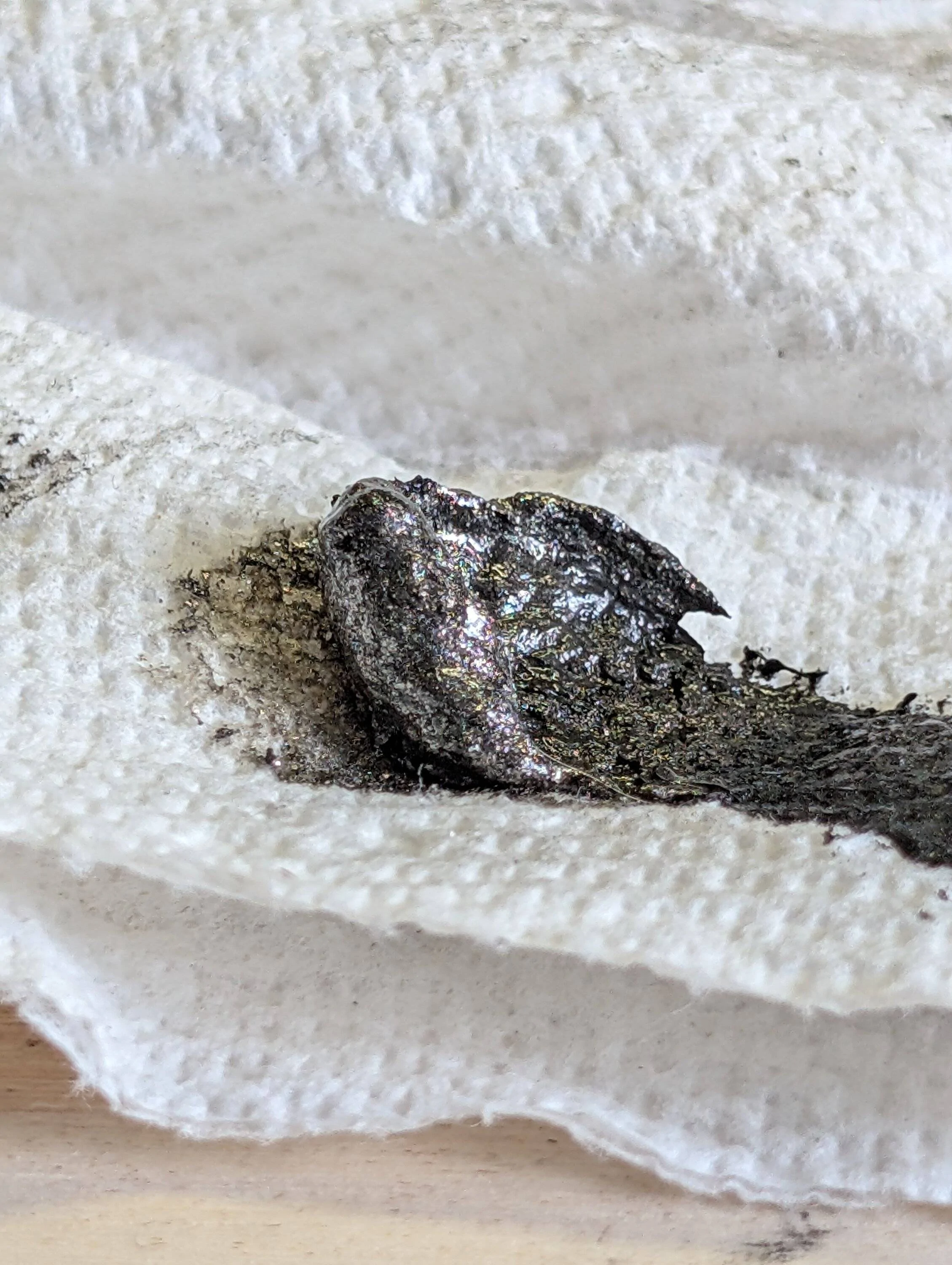

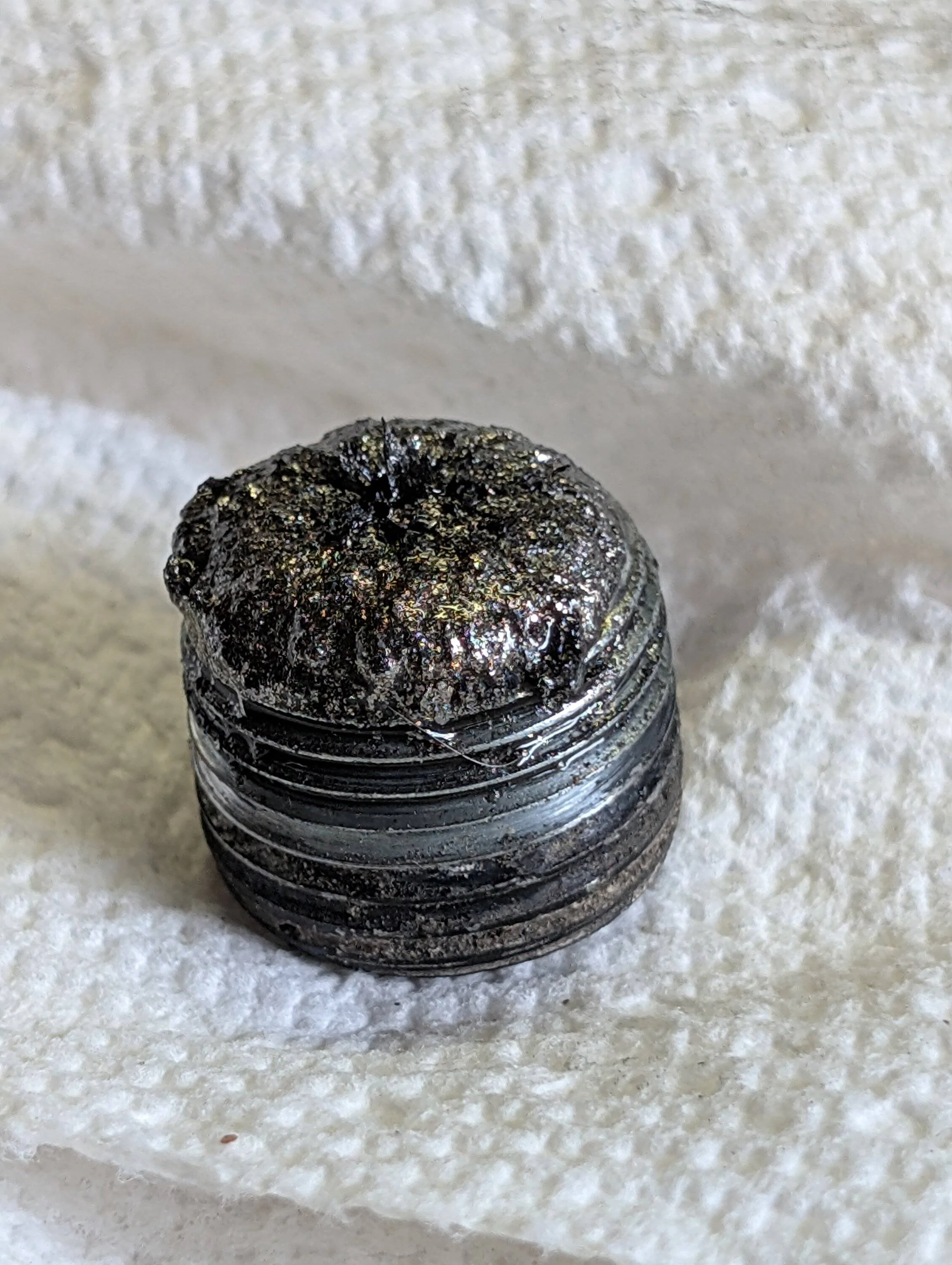

So the good news is that our Ranger has probably the most common rear axle on the planet. A Dana 44 is used in most every vehicle of this size. If you want to dig around YouTube I'm sure there are plenty of good tutorials on rebuilding this diff. If you wanted to be fancy now would be a good time to change the diff to a different style if you were interested, i.e limited slip or air locker etc.
The bad news is with a drain plug like that, I would guess you need to get this addressed ASAP and it is currently in-process of grenading. Some metal shaving are normal, but usually just a very very thin surface amount on the plug. That looks to be pretty excessive, especially if you've already changed the fluid.
