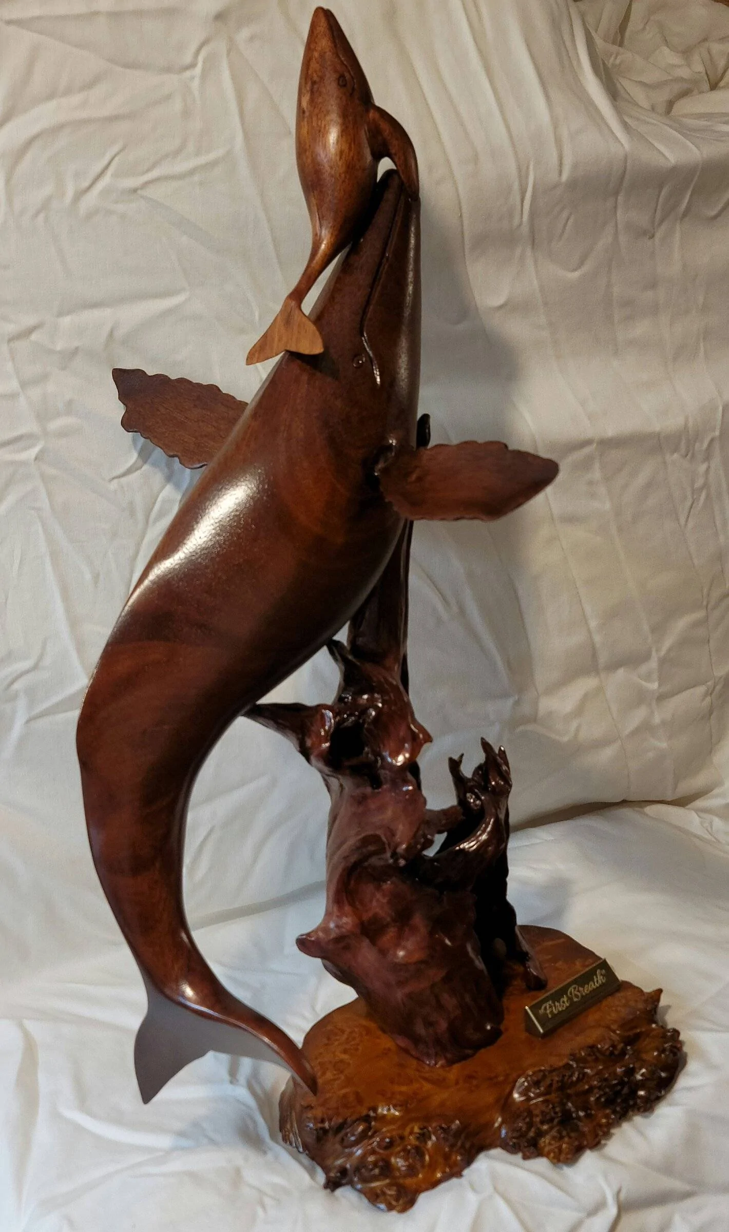

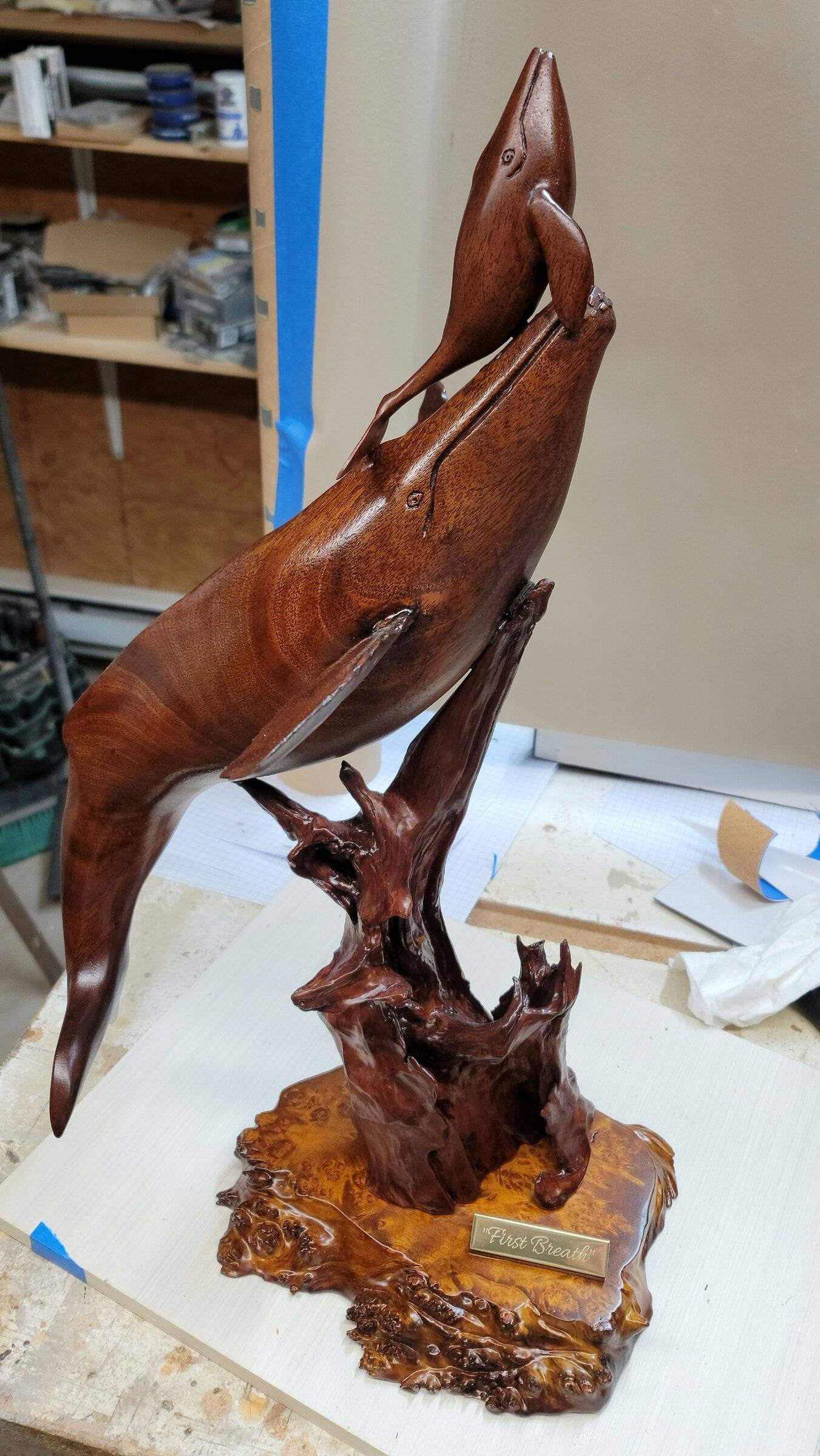

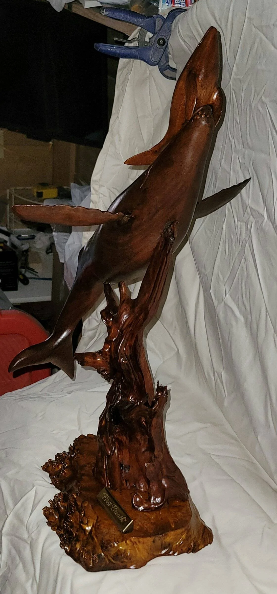

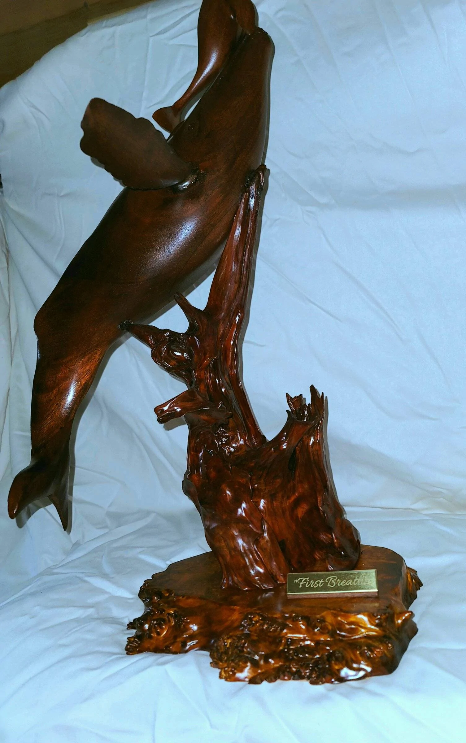

Well she's finally finished, tried a new finish and the sheen was off so I had to strip the whales , resand, dye and finish. Then even though I counter balanced the middle pedestal by drilling a big hole in the bottom and adding lead weight, it was still a bit unsteady when I put the whales on it so I drilled 3 big holes in the base and epoxied more weight in the holes and added a peel and stick cork bottom to cover them up. Then my 5 minute epoxy was taking an hour to set so I added thick super glue and shot it with the accelerator and it's set.
NO idea how I am gonna wrap this thing!
