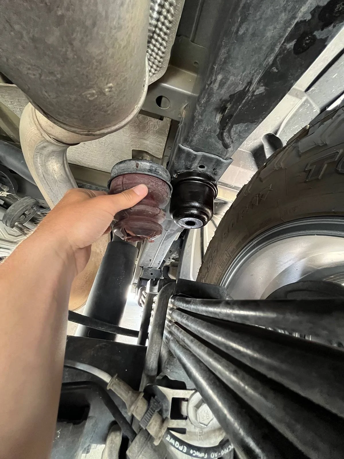

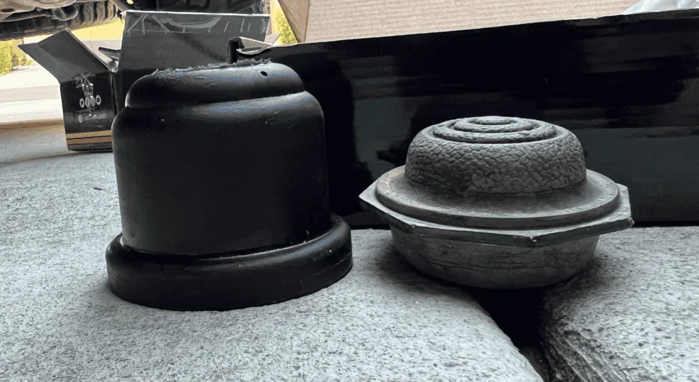

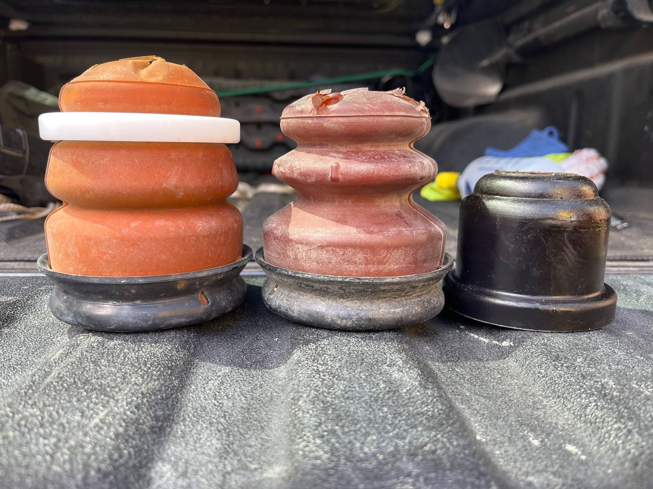

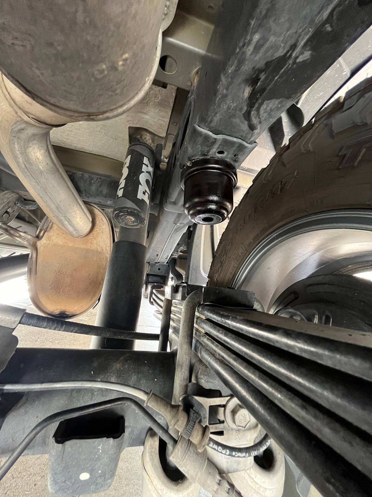

Been playing with it a lot and haven’t found any downsides. More useable leaf spring before contact is made. Loaded about 10 cases of beer in the bed and hit some hefty bumps faster than I would have liked to see if I would “end up in the weeds”. Nope. These are softer and more compliant than stock. Don’t get me wrong, you feel when you hit the stop, as you should. However, the material is way more compliment yet supportive. You don’t get a harsh hit like the stock stops that have you say, “ahhh my kidney.”
After I drank all the beer, the ride was even better. Kidding again.
Unloaded the bed so I just had my shell. Drove even faster through some small whoops. Continuous cycle of the suspension and continuous contact with the bumps, no bucking of the rear end and certainly smoother. Better yet, I have about 1.5-2 more inches before my shock bottoms. Go me.
Now I’m clearly no profession, I just tune, rebuild, and sale suspension for other people’s money. I will say that these would be not good for towing with a high tongue weight. You would have a pretty significant amount of squat and your leaf springs may shed some tears. Would it work? Yep. Would it be comfortable? Probably not.
Something else to note: Raptor bump stops also work great on our setups. I was torn between those and the superbumps. Although, the Raptor bump stops (I believe they are timbren) are shorter. These are the bumps sold with a very prestigious set of leaf springs. I wanted a bit more contact and a slower ramp up, so I went with the superbumps.
I’ll keep proving people wrong with updates on the terrible performance of these crappy Toyota bumpstops.
