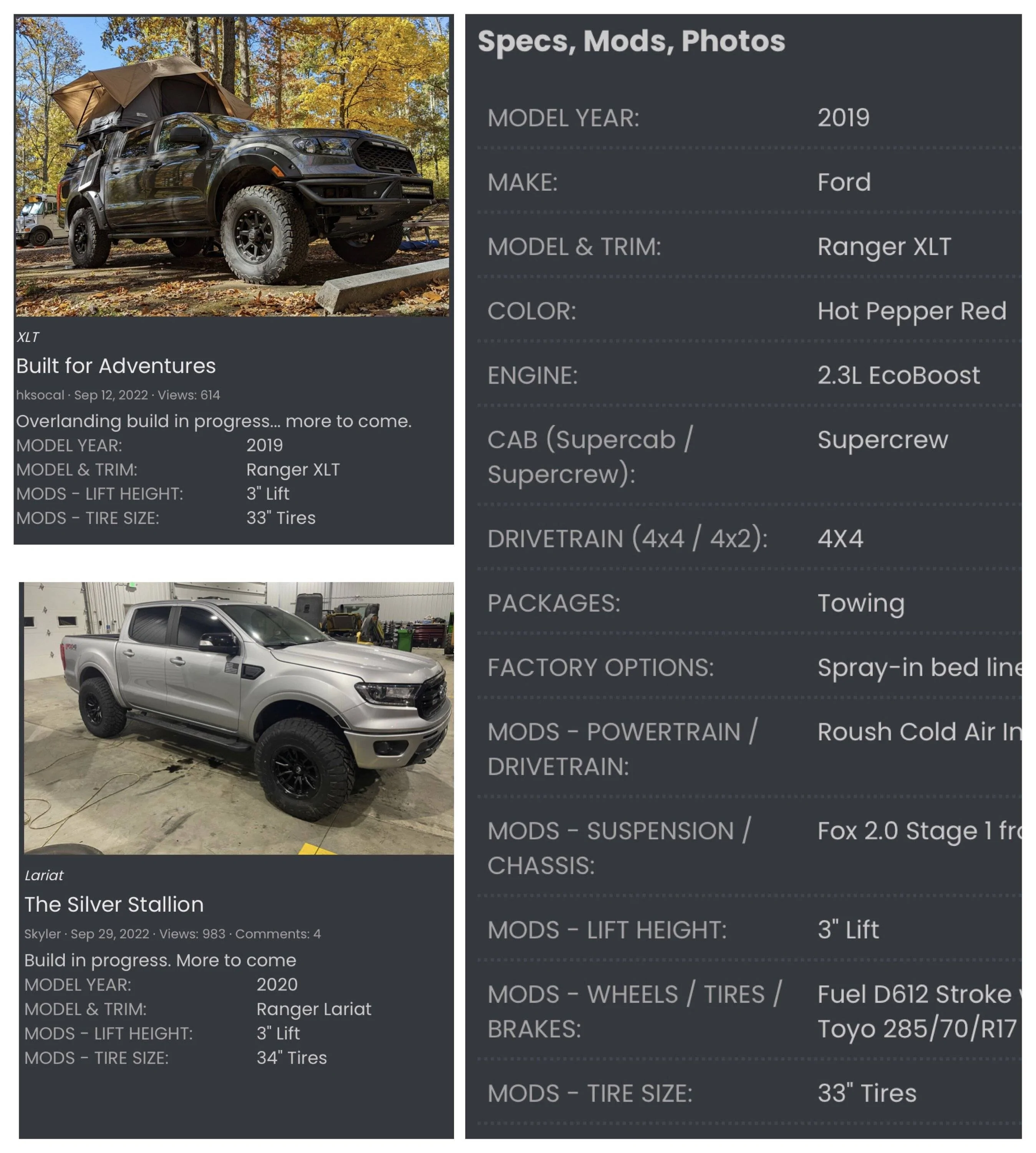

XLT
It will be a lot easier if you go check out the Showcase section of the forum. Each page of that section features pictures of 15 vehicles and lists some details including lift and tire size. Clicking on the image takes you to the owner’s showcase, where further details are listed, often including wheel and tire specs. The comments sections sometimes include information regarding what additional trimming, cutting, or modifications were needed to make the setup work for the owner.
