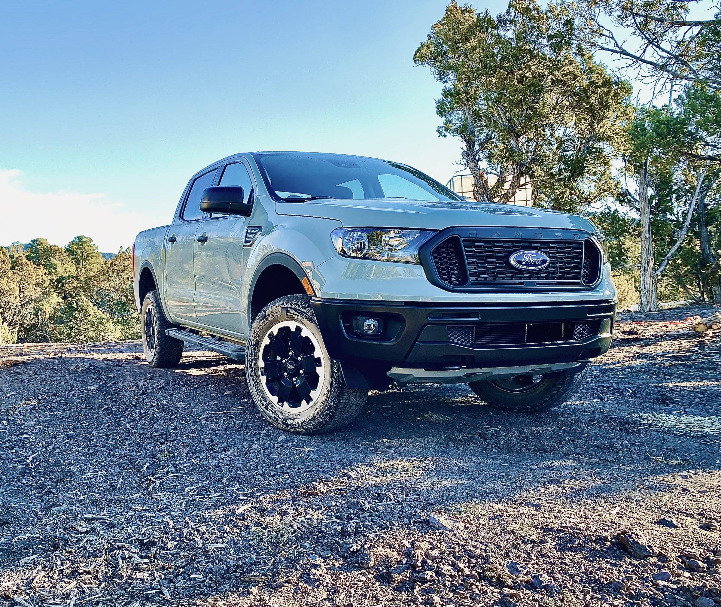

I just bought a 2021 Ranger SXT FX4 Crew Cab (Cactus Gray FTW). I have the 18"wheel. After reading a bunch in this site I have come up with this plan. Please tell me if I am off base!
Desired Tire Size: 275/65r18 (32.07x10.83)
Desired Wheel: Current Factory (With 1" hubcentric spacers)
Suspension: Fox 2.0 Stage 1 Suspension Package. Front set at 2.5" Lift.
Will I be rubbing those crash bars? My goal is to fit the tires in there but keep everything as close to stock as possible without cutting. I am concerned I will hurt my warranty if I get too swanky!

I think you will be close but should clear no problem.
