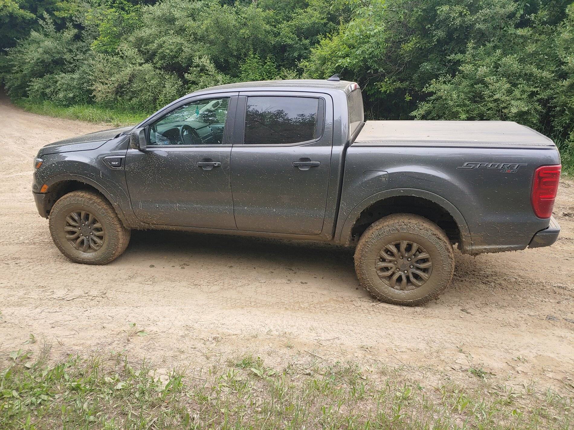

So I cant speak too much for the Eibach as I do not know too much with that particular brand. Bilstein is a totally different brand and the basic 5100 kit is designed to use the factory springs.
Now to Old Man EMU!!!
Small disclaimer here: I do not work for them nor am I sponsored by them but I do know quite a bit!!!!!
To start off with I always recommend matching parts with the same manufacturer. Why you ask? Well they were designed to work together. That doesnt mean you cant mix some parts like shocks and springs as long as the parts will "work with each others parameters".
As stated earlier I recommend matching and therefore still recommend the Old Man EMU lift kit. Not wich kit do you get? Well first off how much do you want to spend? The BP-51 kit is really nice and I plan to go to it but it has a hefty price tag. The nitrocharger kit both light and heavy-duty are a much lower cost and still do well. Second is how much weight will the truck have normally? If you have a bumper and winch(or plan too very soon) and or have a bunch of weight in the bed then the heavy-duty kit will be your freind. If not then light load will do just fine and you keep factory tow capacity and payload capacity.
I myself have the standard light duty kit and I have yet to have any issues with it. How much of a lift does it provide? 2.4 front and 1.6 rear. It is very close to a 1 inch level. I also have Firestone Destination XT tires on 285/70-17 on stock wheels with no spacers and have no major rubbing issues. I can make promises for other tires.
Now I have been Offroad plant along with on the street to say the least. I have also towed with this suspension and it does just fine.
Last but not least you can buy the rear leaf springs by themselves but make sure that the shocks you buy can handle the lift they provide. If you dont you will run into problems.
Hope this helps.
