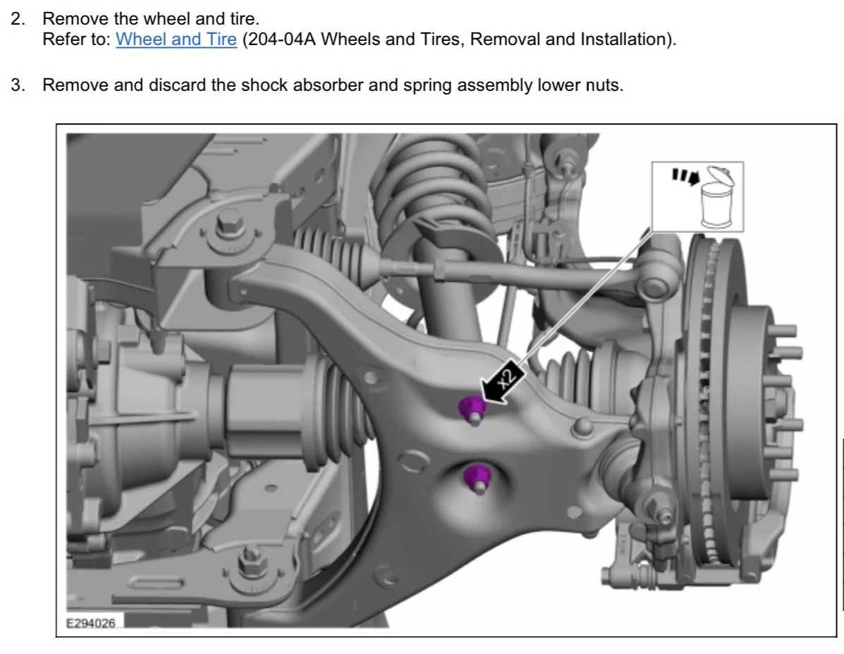

You can see that they say to toss these in the example below:
  • Strut Top Mount Studs - 3 nuts
  • Strut Bottom Studs - 2 nuts
  • Upper Ball Joint - 1 nut
  • Tie Rod End - 1 nut
  • CV Axle - 1 nut
