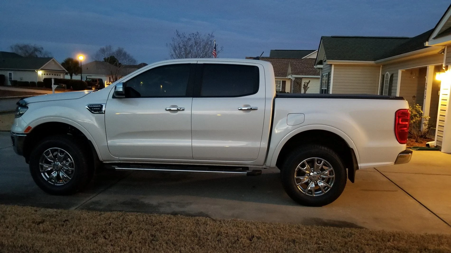

I originally installed the Rough Country 2.5 inch spacer kit. I decided instead to go for the Eibach Pro Leveling kit. Rake is one inch higher in back. That's what I wanted to achieve.

Is that the Stage 1 adjustable?

With the Springs you can go up to 3 in. If you don't want three inches, use the stock Springs and you can go up two point two five inches using the Eibach kit . I didn't know this but I think the Eibach kit can be purchased without the springs

Sorry to seem ignorant, but you can dial in the desired amount of lift just with the these struts?

Yes. The struts have indents to set the level height, I set mine at 2.25"

Yep you can buy the shocks and struts separately and save a few bucks that way.

Beautiful ride, hopefully, the 2.5 front lift kit I already bought from fordrangerifts will achieve the same evenness on my 2020 S/Cab 4x2.
I see you're a chrome aficionado also, good man! :thumbsup:

On the Eibach’s struts can you adjust them on the truck or do you need to compress the spring?
