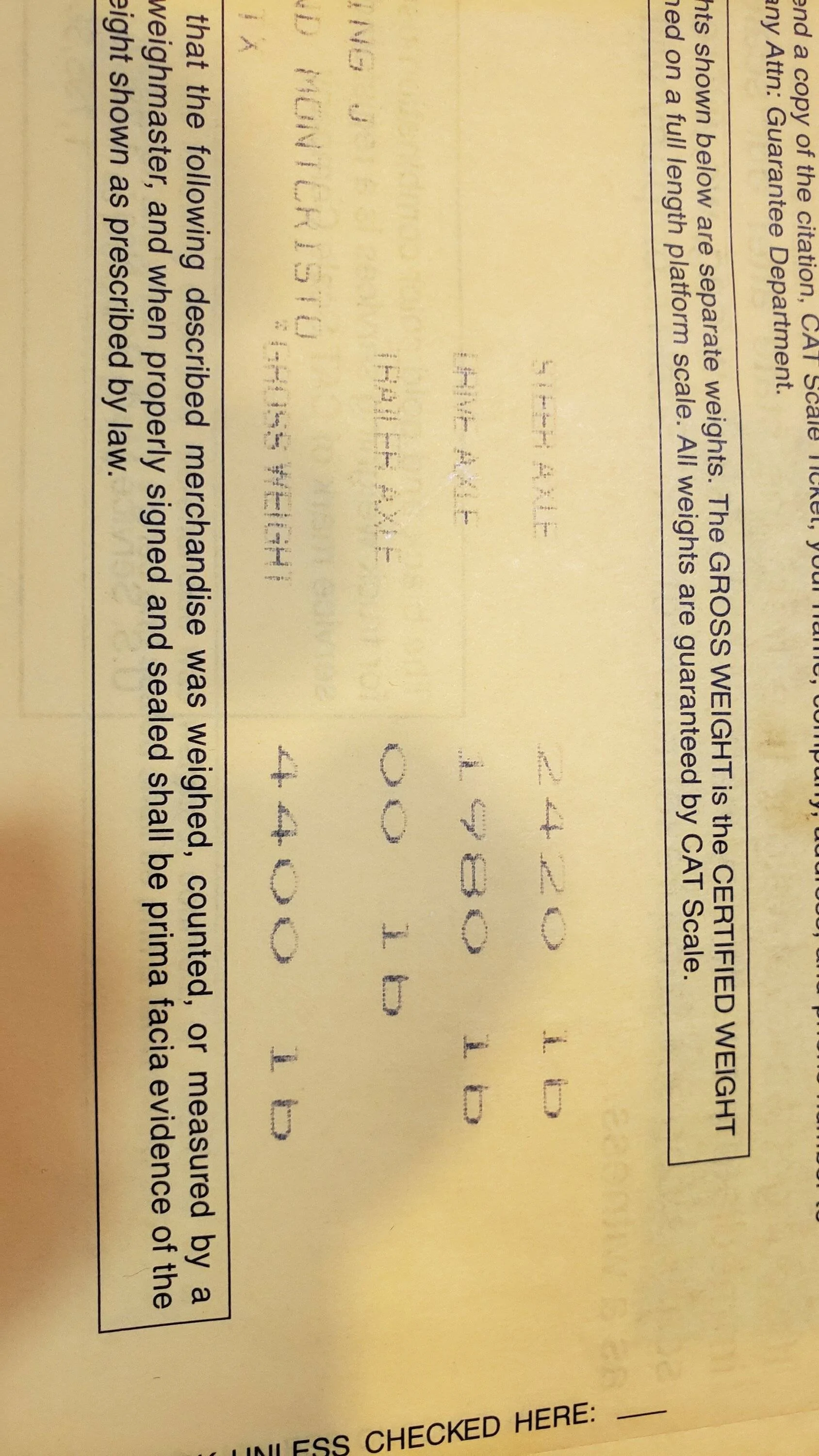

You are right on how to calculate your weight. This is my truck. Dont stress it too much. This is with full tank and all my edc junk i. The truck. Just be smart on towing and loading. Remeber, you are part of the cargo weight. And whatever passengers you have, and gear and so on.
2022 xlt fx2
