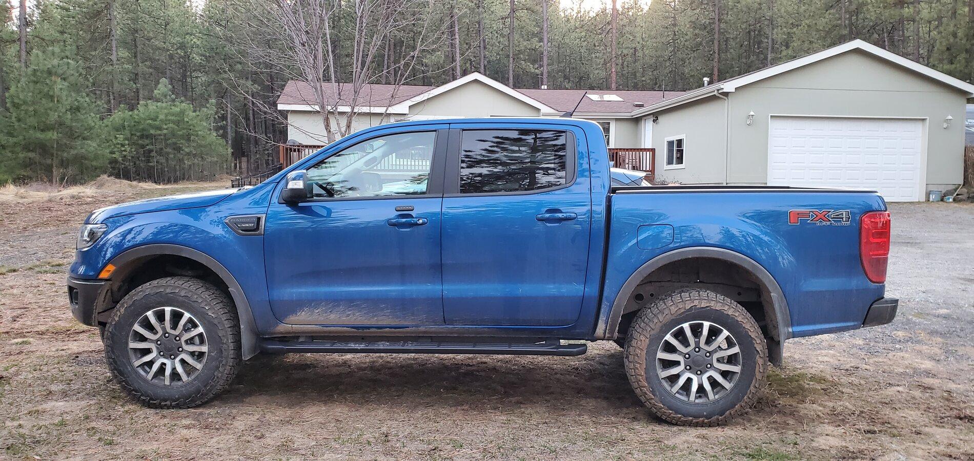

Just installed Eibachs as well. If the quick test drive is any indication, I gave myself a Gibbs Slap for not swapping these out a year ago. What an improvement and possibly one of the best investments yet. Ford needs a massive slap upside the head for the FX4 garbage.
Super easy install and thanks to @20scabstx comments I was able to keep the passenger side nut in place with a rag. If anyone is on the fence on doing this... stop thinking about it and get it done.
Swap the fronts too and you'll really question wtf Ford was thinking..

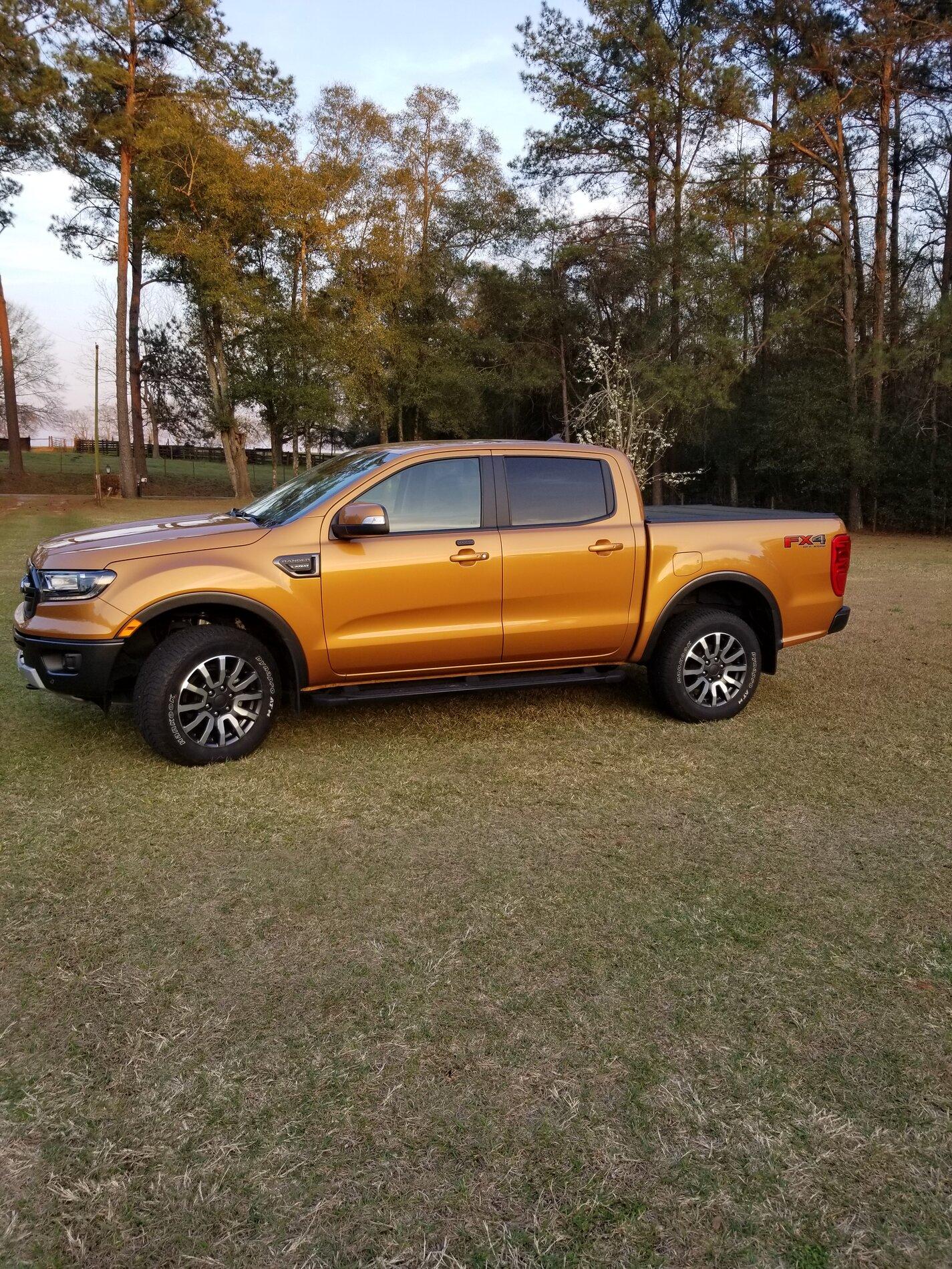

Had the oil changed & they even washed 'ol Butterscotch. Had to take a pic quick before more pollen settled on it. :shock:
Anyone else notice that Tracy parked Butterscoth in the grass so we can't give her grief about her parking skills?

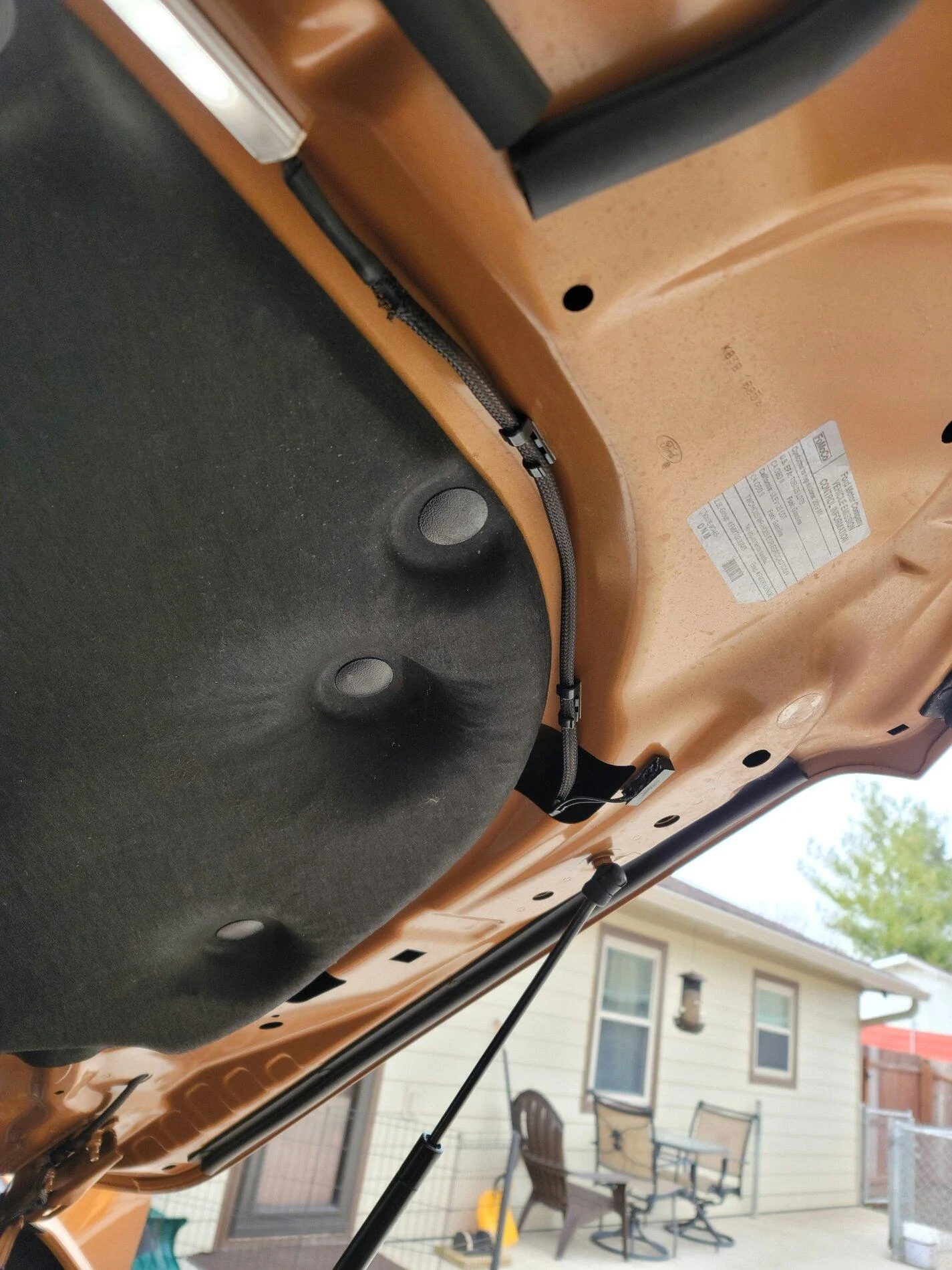

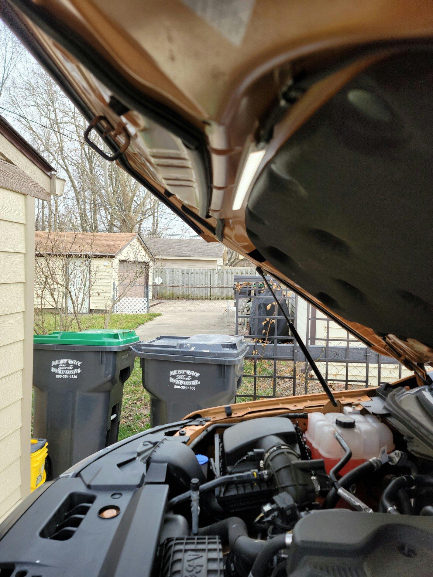

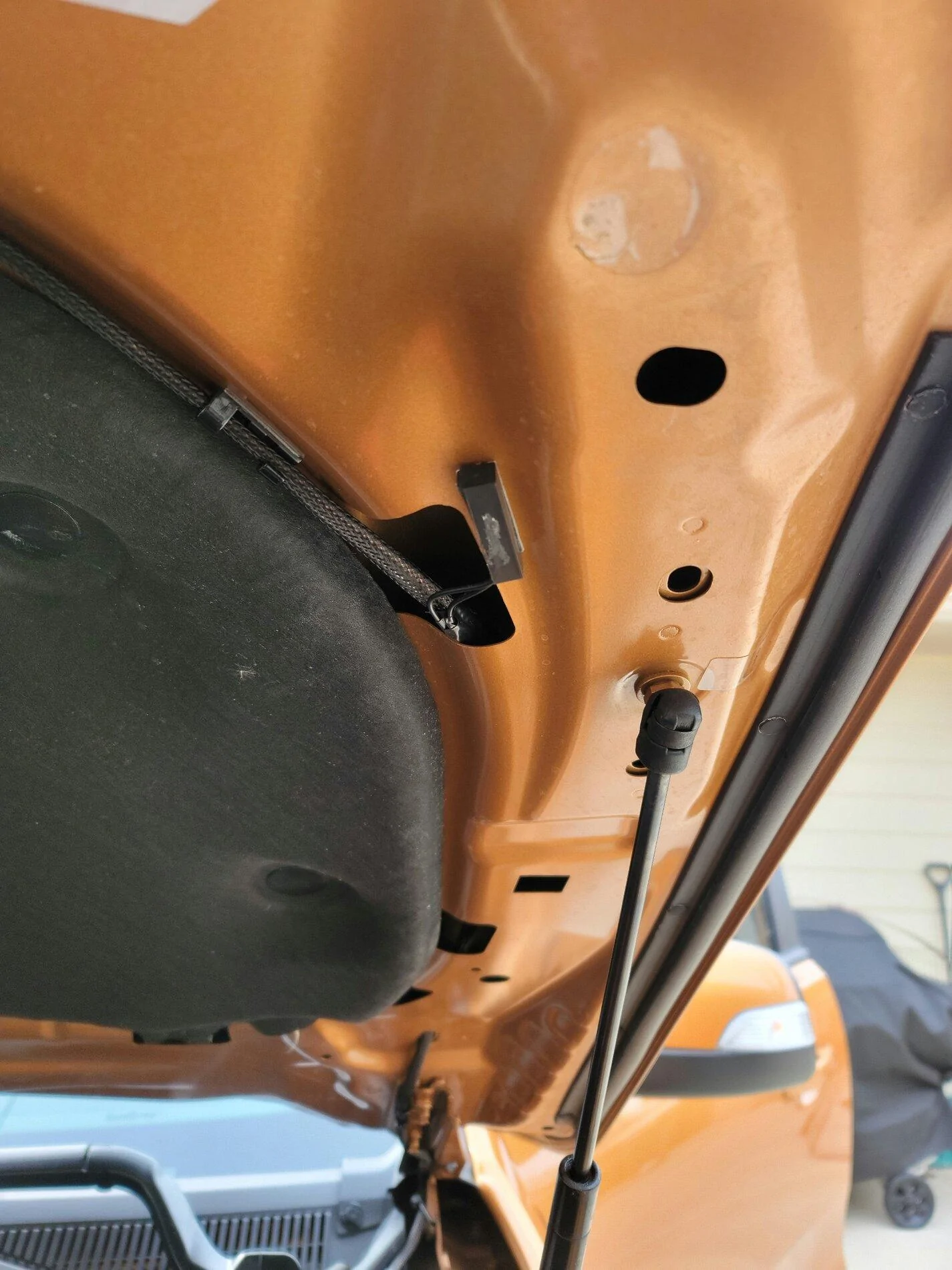

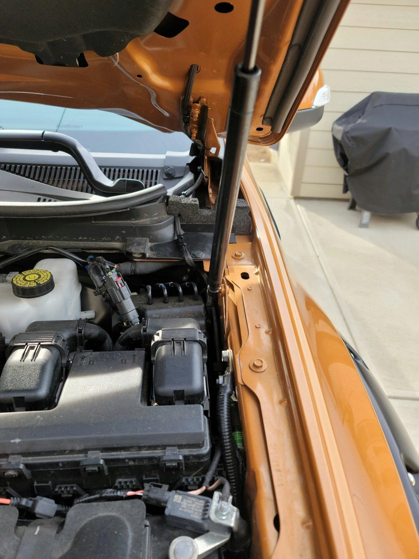

I have leftover parts from making my own LED bed lights so I made a 20 inch one (weather proof) and used 3M tape to mount it under the hood, I didn't want to drill holes so I opted not to use the 2 different plunger type of switches I had on hand, instead I was able to locate a tilt switch aka mercury switch, yes they still make them just have it enclosed in plastic and a new name (Amazon) ran the wires in loom and tucked it in nicely around and thru the hood. I could not locate a fuse box adapter that fit the fuse slots under the hood so I put 1/4" ring connectors on and attached it to the battery using 2 oem nuts. Put the 3 Amp fuse in line on the positive line and the switch on the negative line. Works!
The fuses under the hood have an odd spacing. I found fuses that fit easy enough but no parts store had a mounted fuse adapter ( 2 fuses 1 slot).

It should, I used the 3m heavy duty stuff. The adhesive that came with the loom holder wasn't very sticky. I used denatured alcohol to clean both the hood and plastic before I put the emblem tape on.
Looks good. I've been wanting to do this without drilling holes.
Will the adhesives on the light, fasteners, and switch hold up under hot summer day heat ?

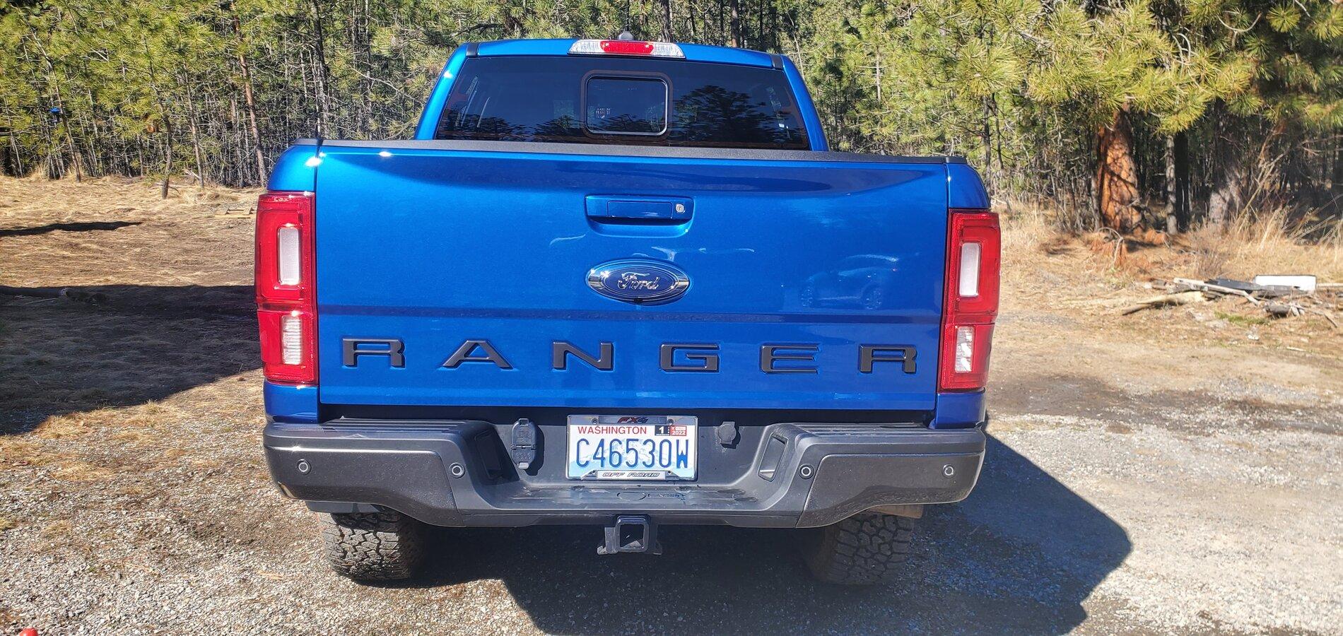

Got my tailgate letters put on..
Look way better in the sun light and match the grey way better than i thought

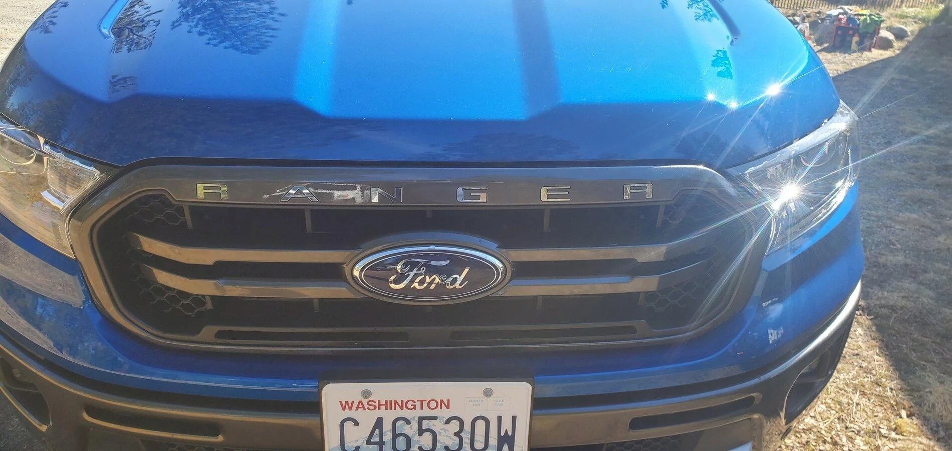

Now on to the grill letters

Looks great. That was the first thing I did was the tailgate then the grill then the dash.
Actually had my 2 year old daughter due them all for me.
