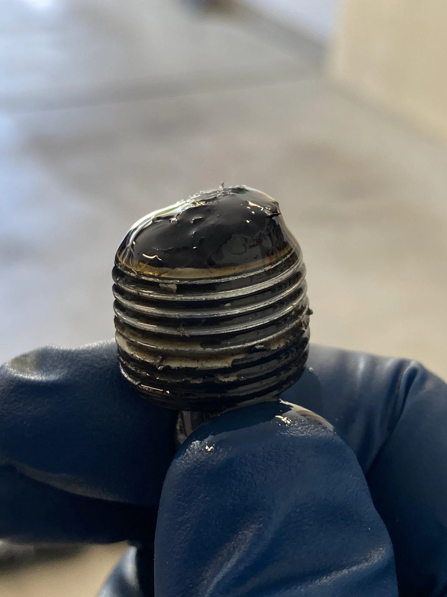

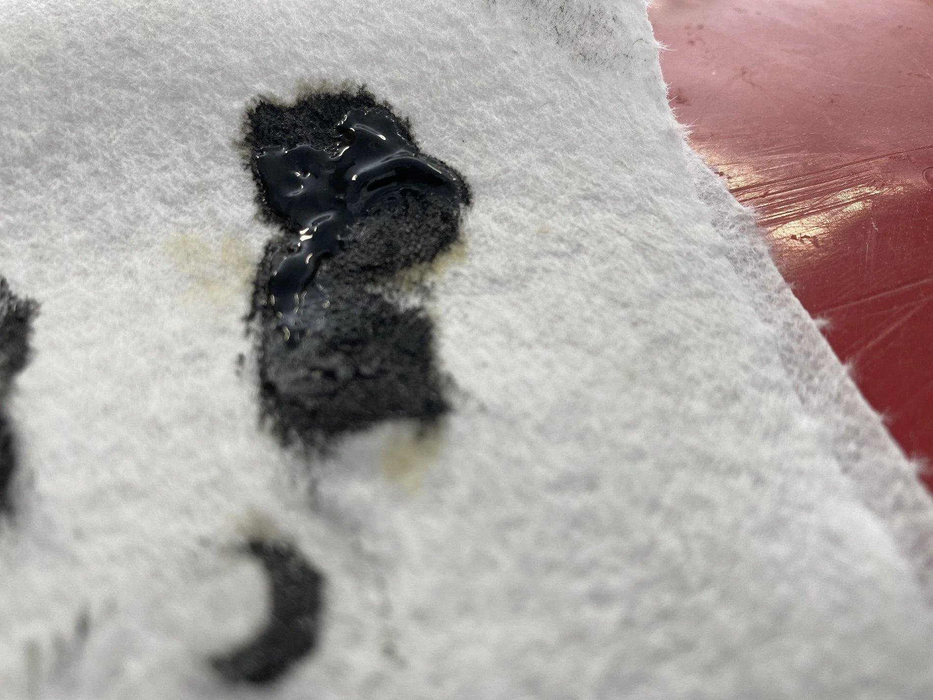

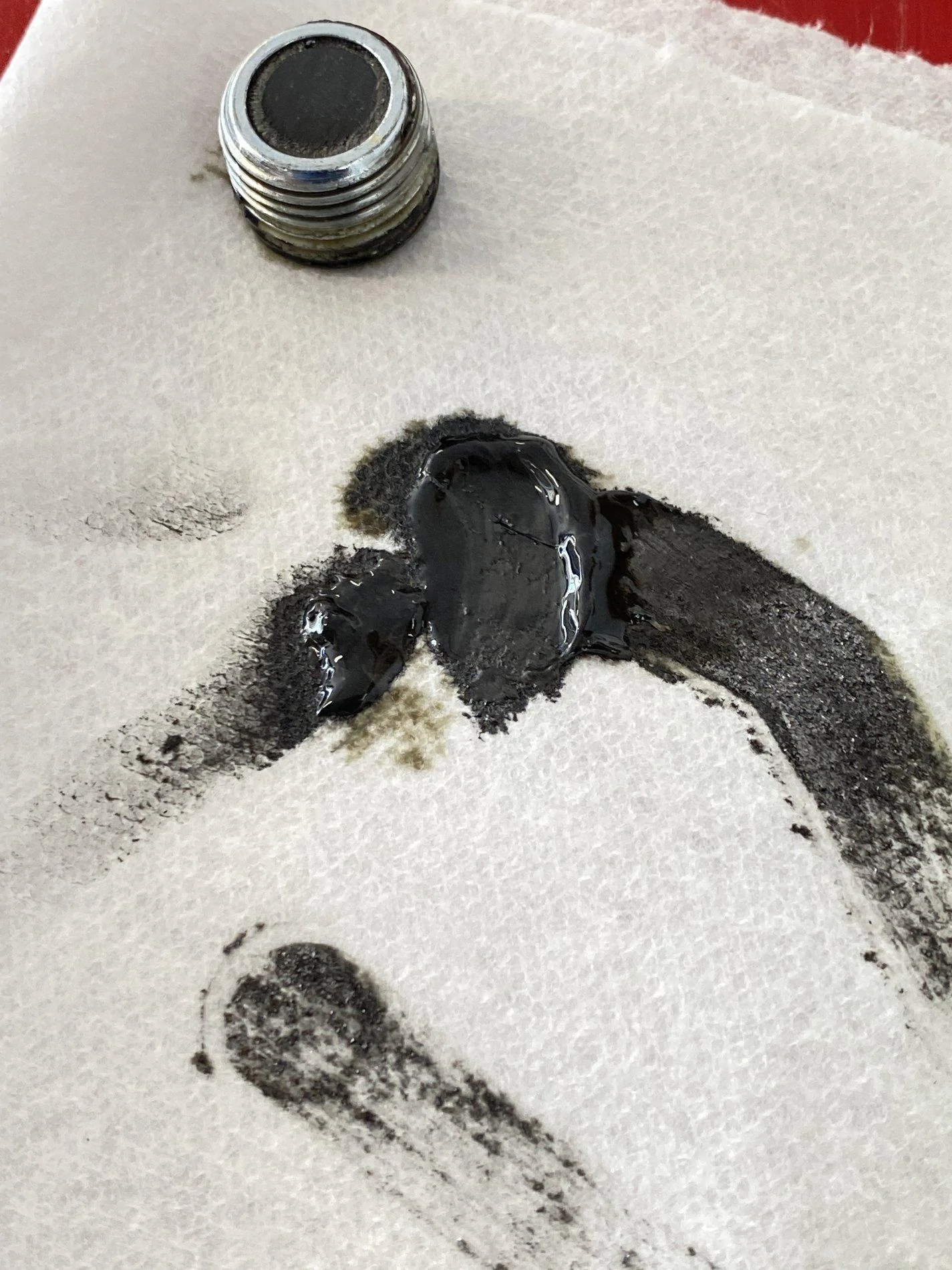

I changed out the oil in both my front and rear diffs. Also changed out the Mercon LV in the transfer case. There's 2250 miles on this truck... the rear diff fluid was really dark (essentially black) with a ton of metal collected on the drain plug. I don't drive this truck very hard, but have put probably 100 miles of 4x4 off road on it. The front diff was much cleaner, but still had a fair bit of metal collected on the plug magnet. I was also pretty surprised at how dark the transfer case fluid was. Also quite a bit of metal on it's drain magnet as well.
Here's the rear diff magnet and then glob of metal wiped on a shop towel:

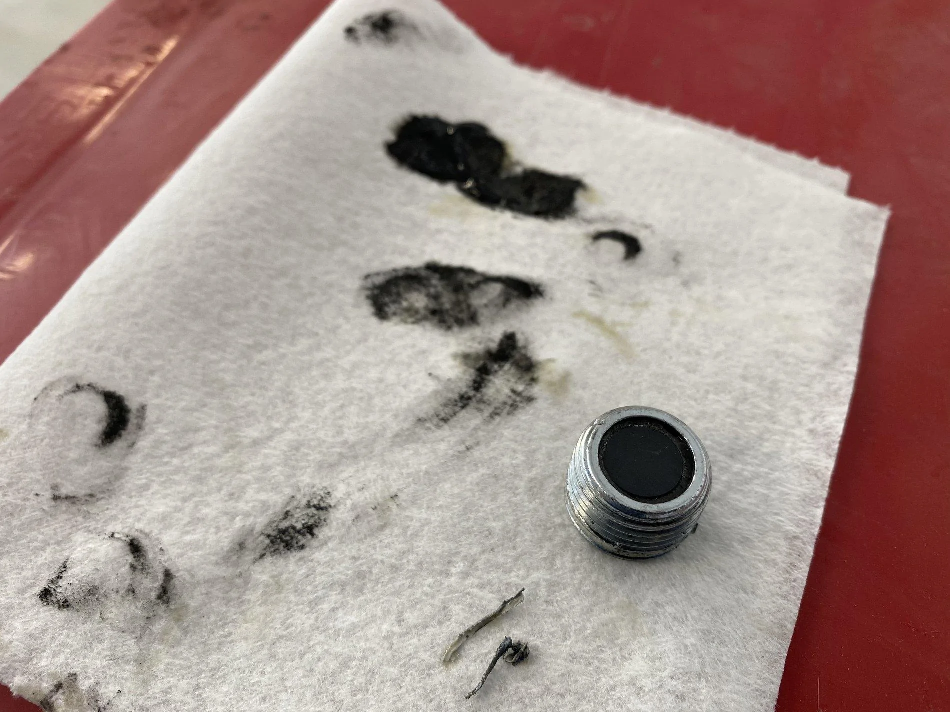

Here's the front diff magnet and what came off on a shop towel:

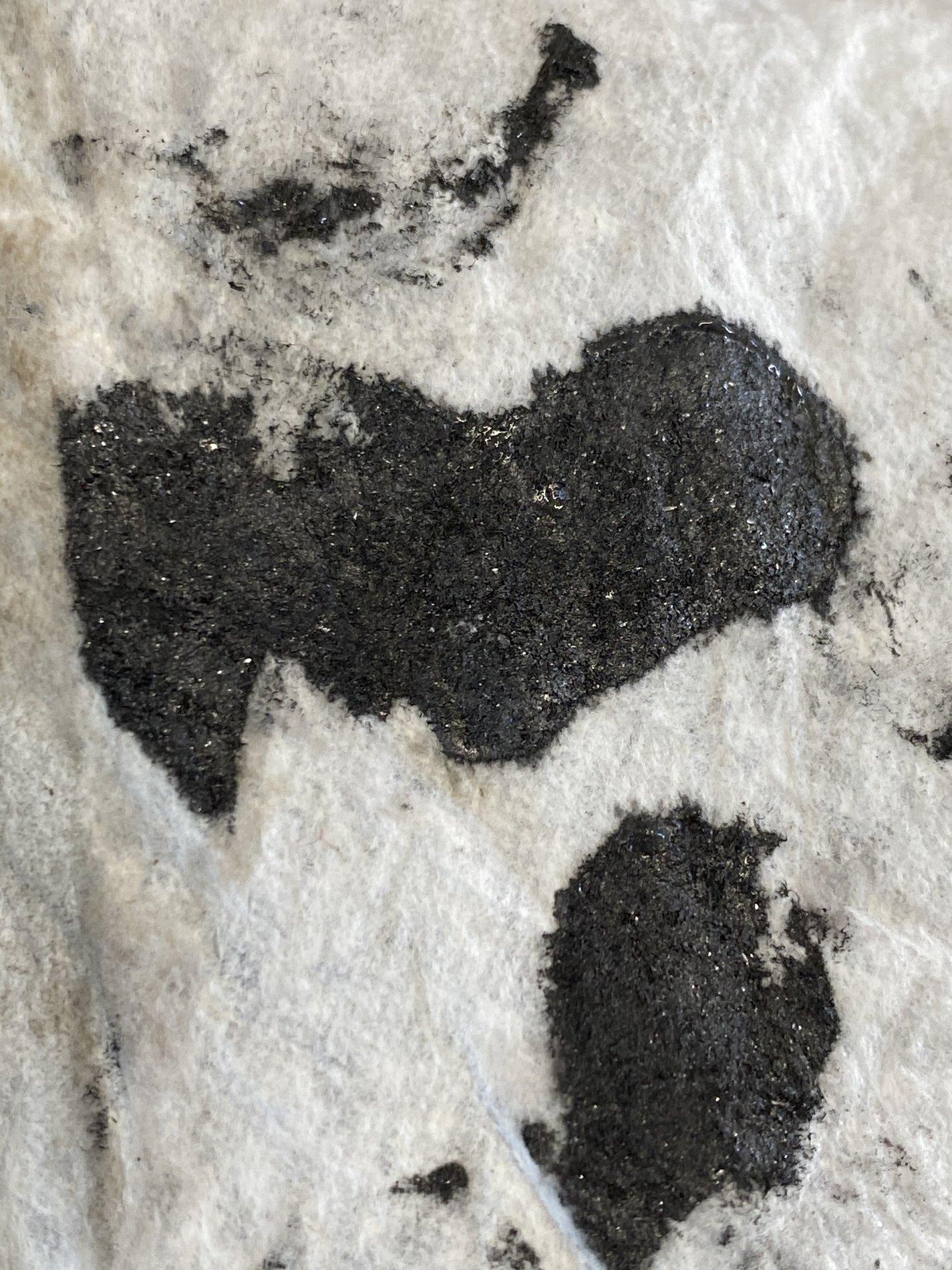

And here's a close-up of the metal shavings that came out of the transfer case:

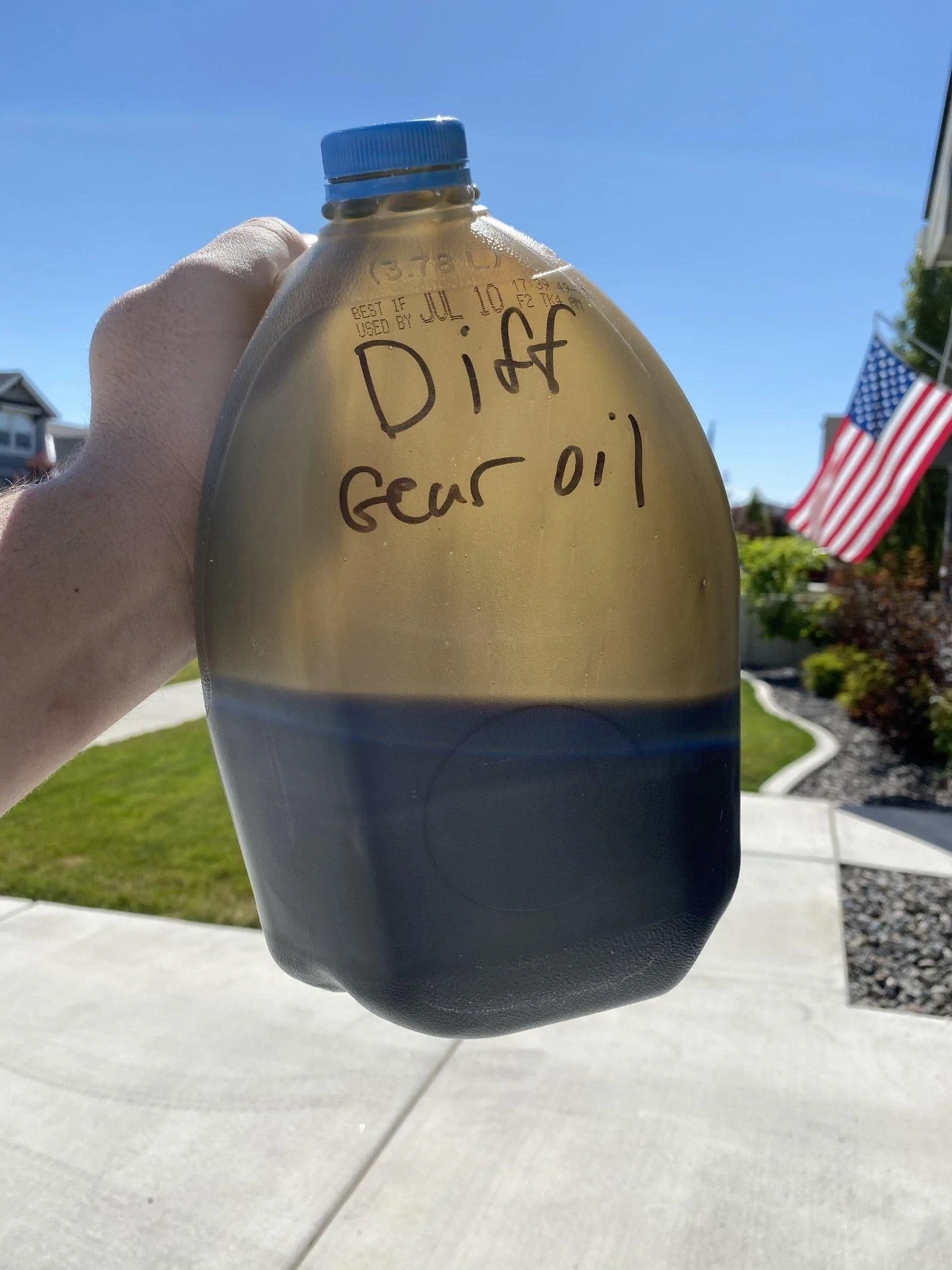

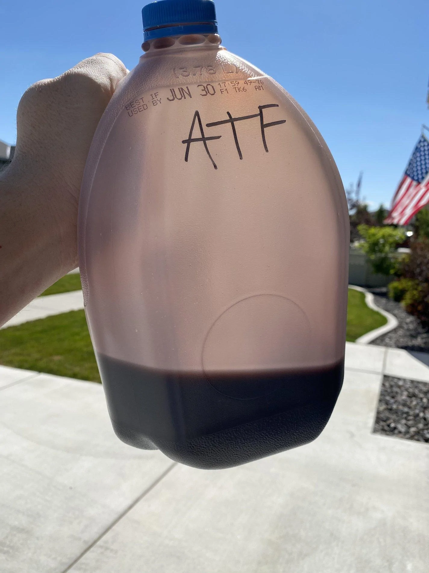

I collected the fluids into gallon milk jugs to take to the local auto parts store for recycling. I shook them up then held them up in the sunlight so I could see the color of the fluids better. Both are pretty dark for only 2250 miles, imho.
I put genuine Motocraft Mercon LV into the transfer case, and Amsoil Severe Gear 80w90 synthetic into both diffs. I consider this to be the "break in" fluid change, and will leave them all alone now until I hit 30K miles or so, then change them again and every 30K miles thereafter.
Interesting !

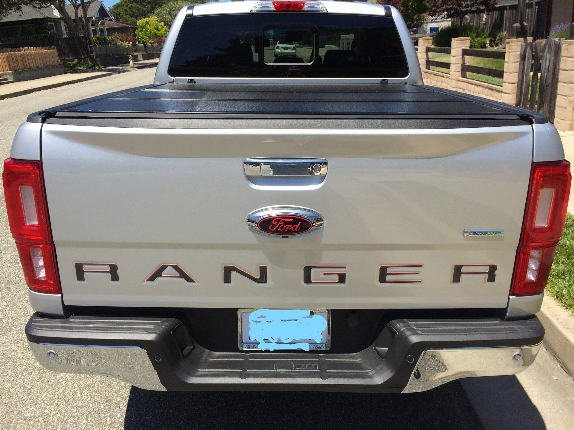

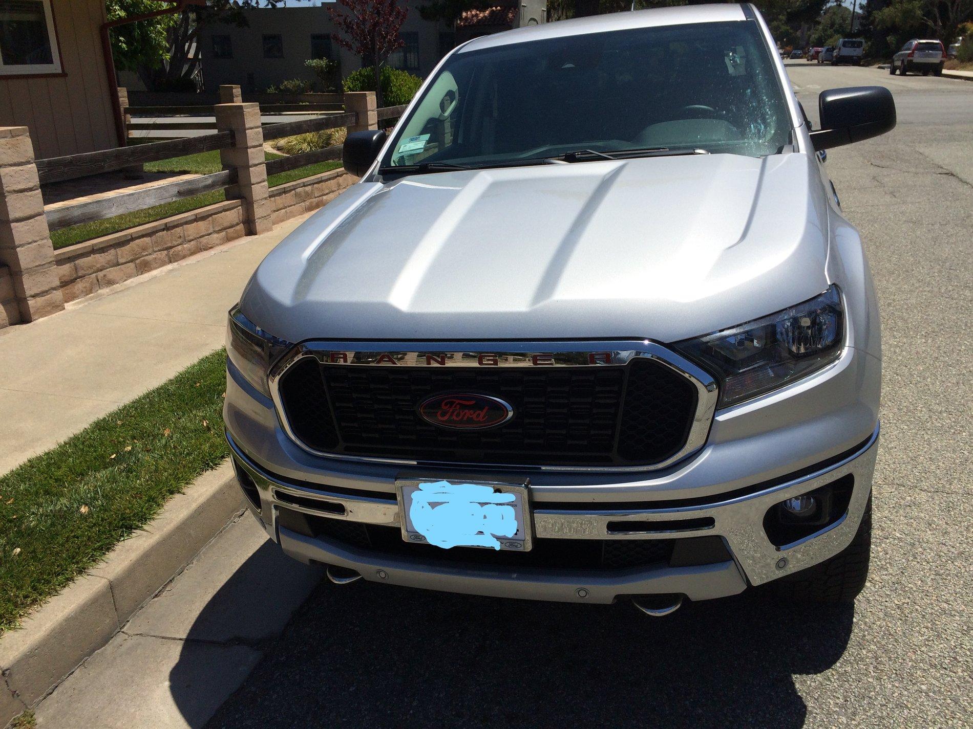

Added red grill letters and red/black tail gate letters. Also red/black Ford logo to emblems.em decals. Ran out of time. but ecoboost emblem will change to red/black sooooon!!!
