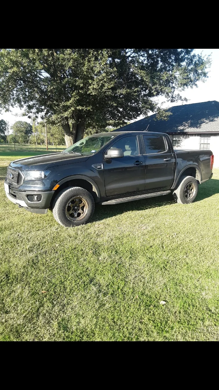

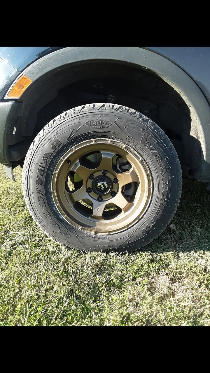

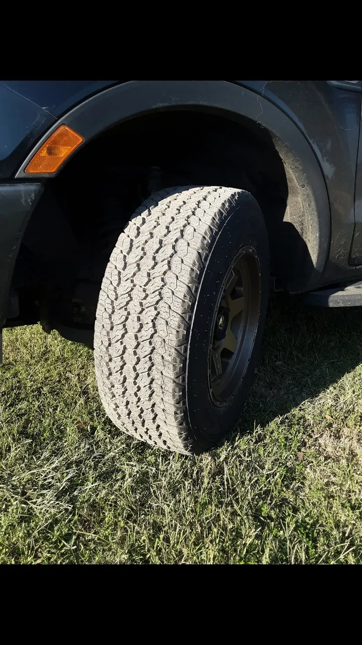

New tires, Goodyear Wrangler ATs, and ya'll these are the quietest all terrain tires that I have ever had. Off road test this weekend maybe.....

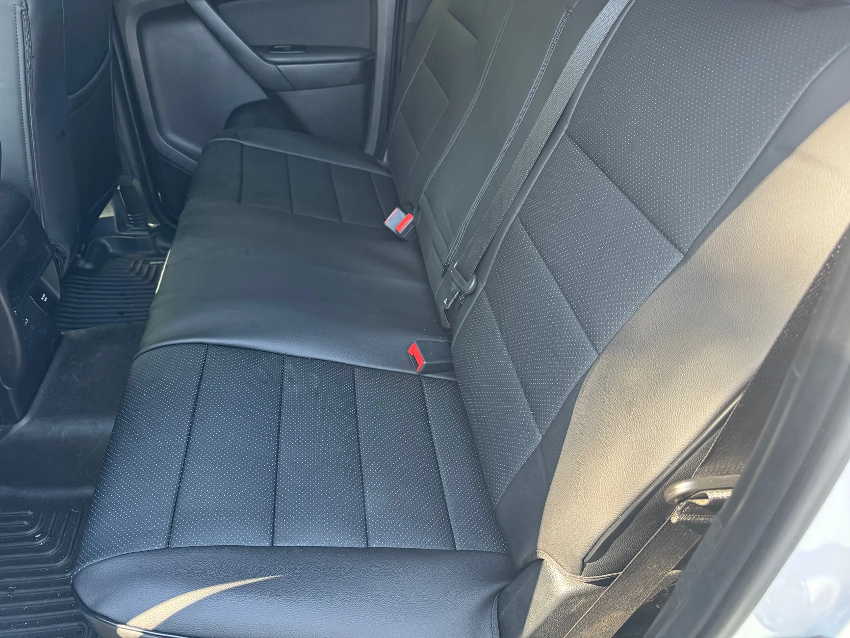

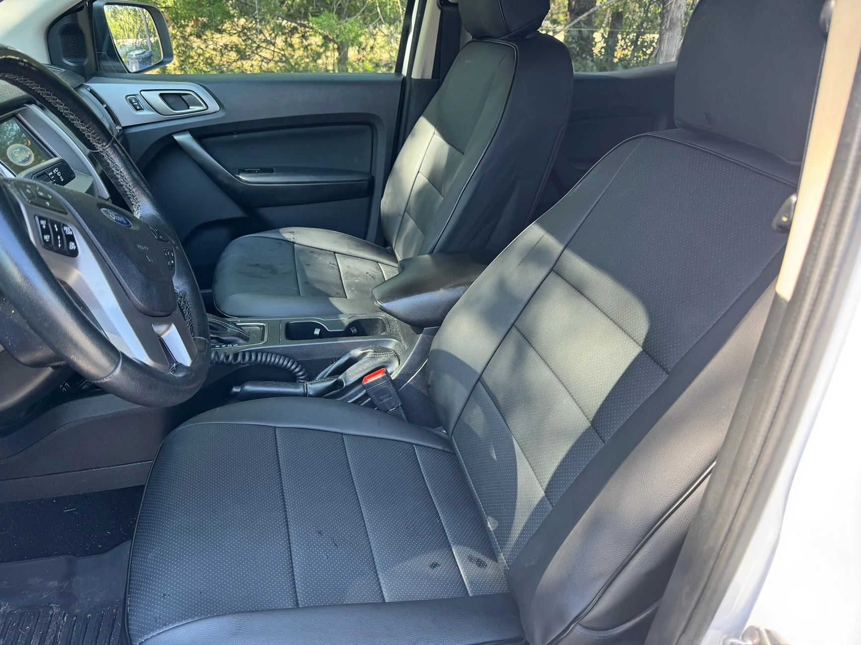

Installed seat covers. It was hard on the fingers but very worthwhile in my opinion. I like them. They probably will need a little tightening in a day or two. The marks you see is my sweat.

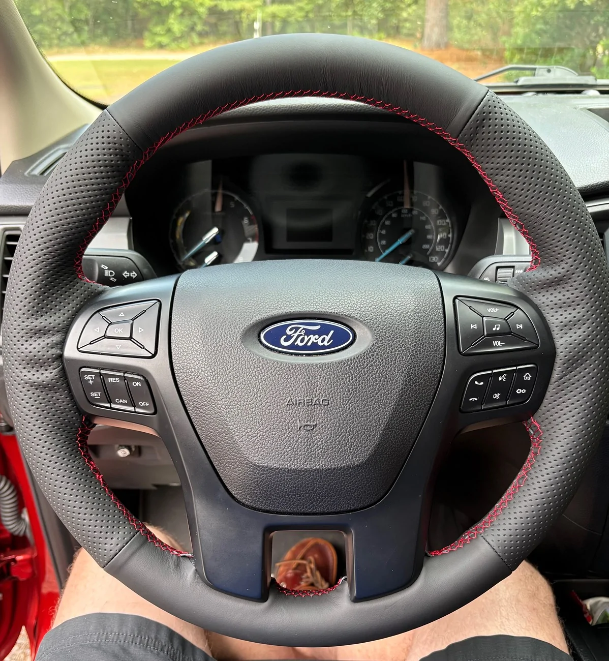

Put a leather cover on the steering wheel I bought from Texas Custom Interiors. Fit is ok, not as good as factory and probably would be better if I could have taken the rear plastic shroud off of the steering wheel, but that would require taking out the the airbag, which I am not doing.

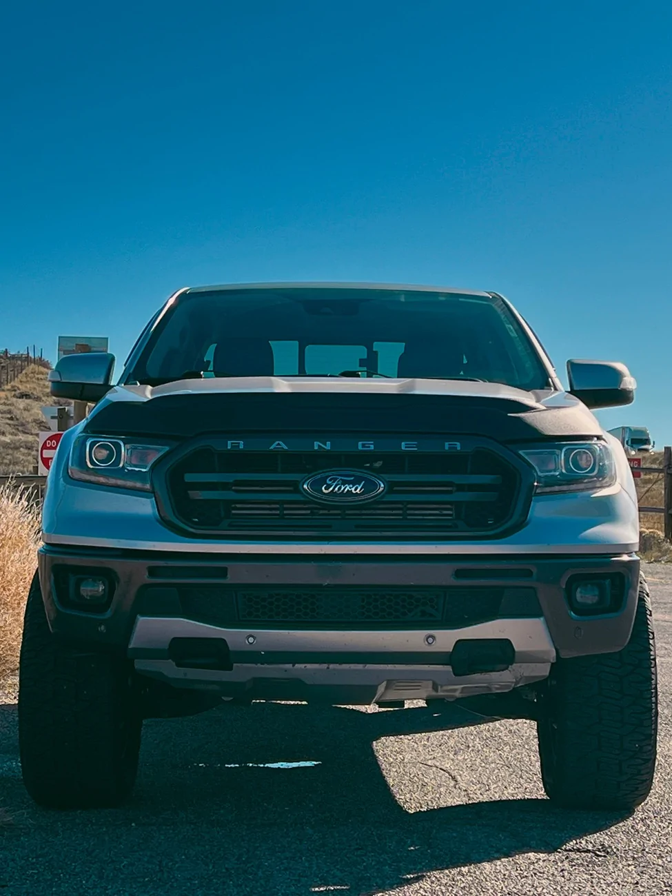

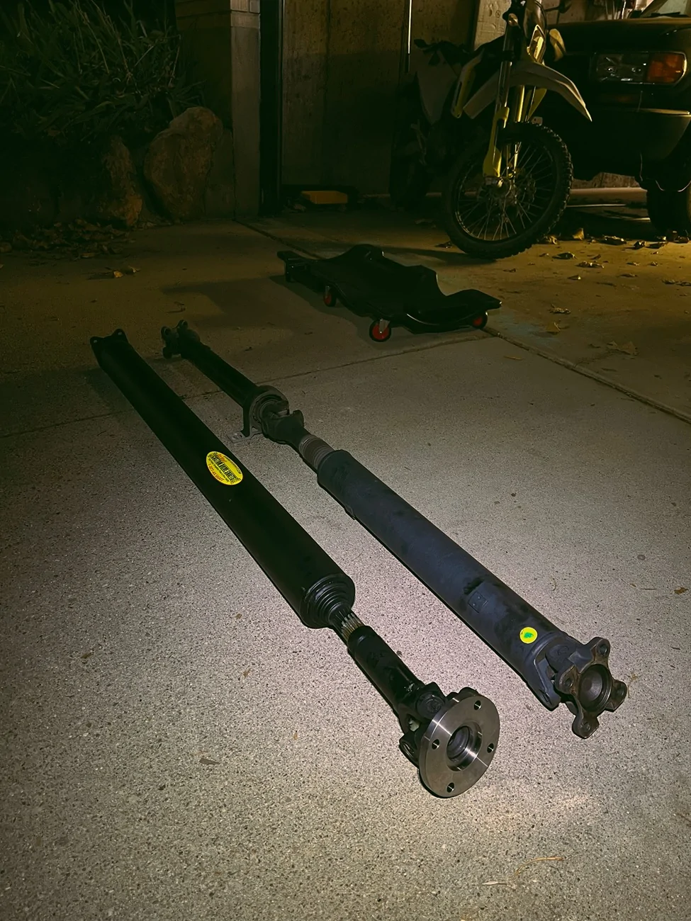

Went to the dealership recently to chase down sounds coming from the driver's side CV Axle (which is brand new) and they recommended I get myself a front diff drop and the improved geometry should eliminate what I'm hearing. I have a 2.5" lift and 33" diameter tires so I am right about at that threshold where one might be necessary. I researched the available options (not many) and decided to go with Peak's since it is the least intrusive and easiest to undo if for whatever reason I needed to. I'll tackle that probably next week.

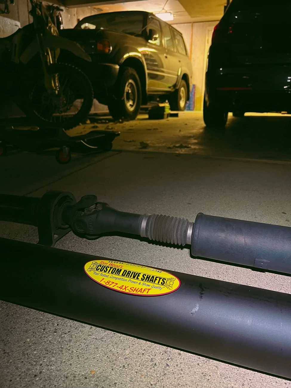

They also mentioned that the rear driveshaft carrier bearing was likely going out. The labor to replace the bearing cost as much as replacing the complete driveshaft. As has been discussed many times on this forum, the 2-piece is a flawed design and it feels brainless to pay that kind of money to someone else to install a flawed design. So I went the route of going with the Tom Woods Ranger 5G 1-piece upgrade that I would install myself. I do have a harmonic vibration between around 65-75mph that I always attributed to my lift/larger wheels & tires and after reading everyone's experience with having a huge reduction in hwy speed vibrations, and improved starts/stops, figured I could benefit from TW design.
Removing the old driveshaft wasn't too difficult, but was definitely the longest part of the process. I generally only use hand tools and tend to avoid powered when it comes to critical components to avoid stripping or over/under tightening, and in this case my hands were definitely tired by the time I removed the last bolt because those suckers are in there tight with previous thread lock.
Before going under the truck with it, I had the TW DS to be what I felt was fully extended with a decent amount of spline showing. I attached the TW DS to the transfer case and then went to lift up the end to the rear axle and was about an inch short. It was at its limit to where I could physically extend it and so in that moment it appeared to me that TW built me a DS that was too short. This was at 9:30 at night and so I was pretty upset at that point having expended all that energy to remove the old shaft and being right at the finish line and unable to mate to the rear axle.
Called TW office first thing in the morning and they double-checked their build measurements against my flange-to-flange measurement of 67.25" and they felt they had built it correctly. Suggested that the slip yoke could be vacuum locked and that is why it could not extend further than it is. Ran to Home Depot to grab some calcium sulfonate grease (thanks to this forum I already knew which kind to grab) and a grease gun to force grease into the slip yoke and hopefully force the vacuumed air out. This ended up working and after applying as much force as I could muster was able to break the lock and fully extend the DS. Installing after this was a breeze.
Test driving on the highway I had about an 80% reduction in the vibrations I was accustomed to at that speed. When I had my new set of tires installed, the tech said he had a hard time perfectly balancing the right rear and so knowing that, can at least attribute that last bit of vibration to that. No delays in starts off the line and it seems to come to a stop more smoothly. Happy so far!
