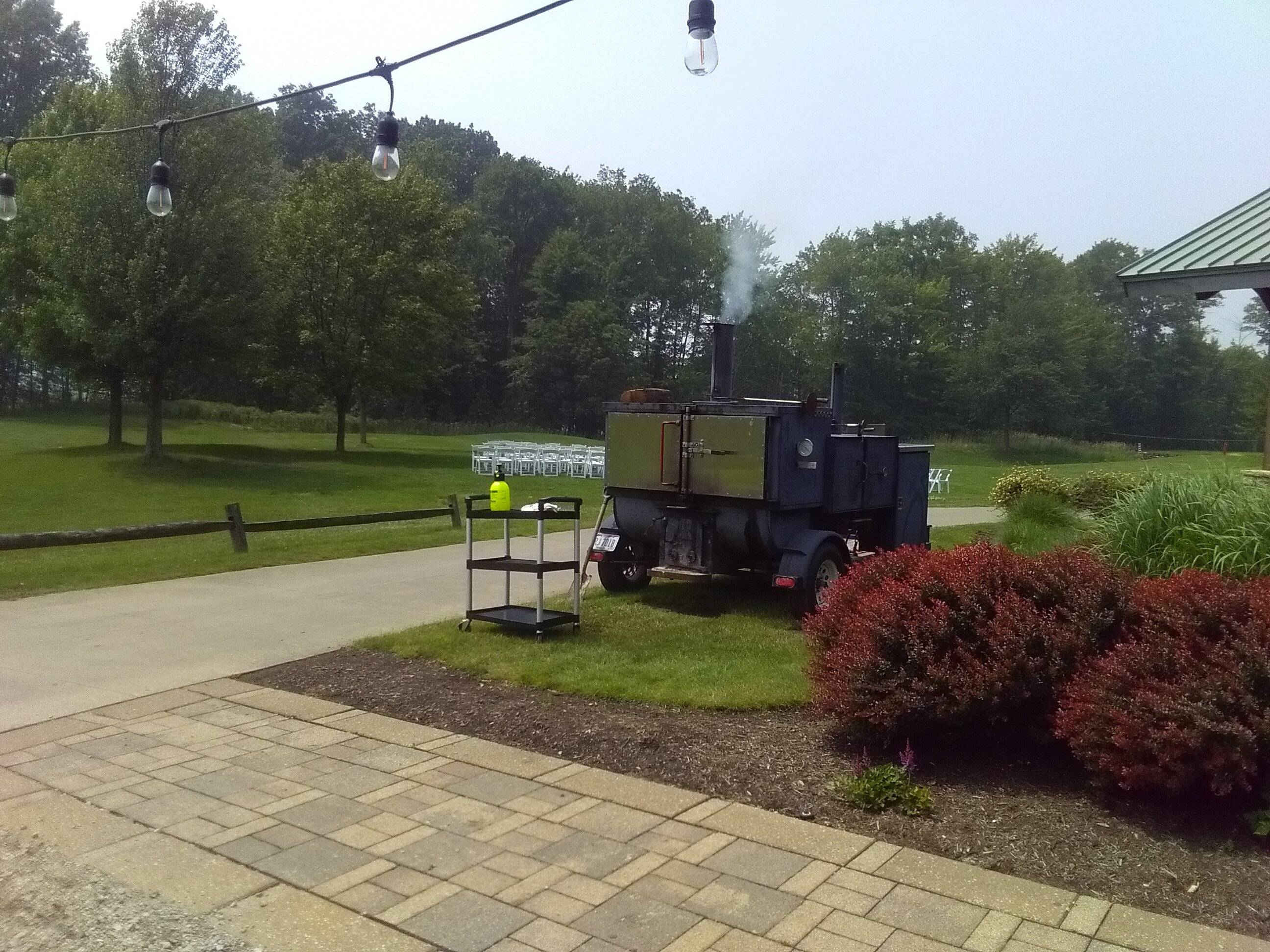

you find the parts to build that on a dump run?
Close!!! =D
The body is an old underground propane tank. I filled it with water and let it sit a week before straddling it with an oxy-acetalene torch. The fire box is 1/4" plate and about 50 pounds of welding rods.
