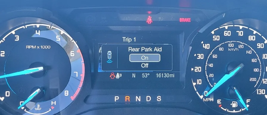

@airline tech this is the notification I was referring to. I put the truck in reverse, that pops up, I arrow down to off, then hit ok. then go on my merry way. I would still get warnings for really close proximity stuff though, like when backing into stall with objects in the vicinity.

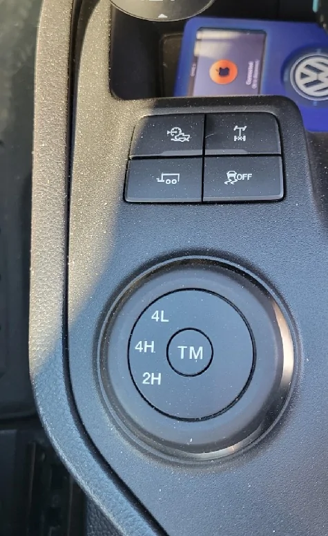

Also, I don't have a Park Aid switch on my center console. 🤷‍♂️

@airline tech this is the notification I was referring to. I put the truck in reverse, that pops up, I arrow down to off, then hit ok. then go on my merry way. I would still get warning for really close proximity stuff though, like when backing into stall with objects in the vicinity.
What happens if you click ok on the Rear Park Aid ON? Does the message still come up when going into reverse the next time?
Don't know, never selected on before lol.

Morgan I know you say you turn it off every time and still usually get alerts but it seems to me as if you're simply turning the system off and that's why you're not getting alerts.
I never even interact with this menu as it turns itself off when I put the truck back in Drive. I would definitely experiment with selecting "on" to see if this solves your issue.
That's the thing though, since day 1 I have always selected off, and would ALWAYS still get close proximity alerts, but as of Mon or Tues, they stopped. But I'll fiddle with it more with the OM and report back lol.

So, which Rear Camera Display do you have.
Rear View Mirror / 4-In Sync Display / 8-in Sync Display
Since you do not have the Front Park Aid, I think what is happening due to the fact that even when disabled (off) it is still operational.
This is why you do not have the Center Console Switch (I Believe)
I have a hunch by your statement that even with it selected (OFF) -You were still getting (RED) alerts for close proximity, with it (ON) you will get the progressive alert Green/Yellow/Red, and the chime will increase in speed to closer you get to the object eventually locking in to a solid tone (RED)
I was under the impression that the system would disable ALL alerts (when off) even though it's always active when the ignition is on.
So just maybe it will still display a (RED) alert even when off - as that is a critical alert level as this is the way you have been using the system - until now it was working, the manuals do not show this operation (if this is the case) but I can confirm that the sensors are always active and transmitting when the vehicle speed is under 3 MPH in (Reverse) for the Front (Drive) its 5-MPH above these speeds they disable and the driver selection and or switch only turns off the Indication & Alerts.
But it appears there is another part of the operation I did not know and if this is the case, I will make a note of it - Even when off it will still function for (High - RED) Alerts.
I will test mine and see as I use the park aid daily for my home garage and work parking garage.
Rear Park Aid = The 4 Parking Sensors
Rear Camera = The BLIS Modules provide the Cross Traffic Alerts / Grid Lines come from the PSCM sensors (Steering Angle)

Ok confirmed with 8 in screen and park aid switch - switch (off) no parking warning indicating at all even when it should be Red , with the center console switch there is no other IPC menu setting like you have, so the IPC selection takes place of the physical switch.
So with the center switch operation- if you select it off , it operates the same as the ASS switch it’s only good for that ignition cycle - resets to (on-enabled) on next cycle.
So I suspect if you set it to on - it will stay on and you won’t have to select it every time you put it into reverse.
That would be annoying - that is what threw me off about your post, it should not be that way.
