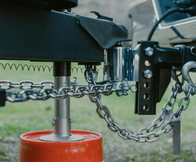

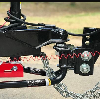

If I had to take a wild stab at it, I'm guessing the Anderson WDH would be the lightest choice, just from looking at them.
This:
Looks a lot lighter than this:

Any of your better quality WDH like Blue Ox, Curt, Reese, ect, will weigh 100-120 lbs. This is the head, shank, bars, ect. An Anderson will weigh 50-60 lbs depending on the length of the shank.
I have a Blue Ox set up and have used their stuff for many years. Have no experience with the Anderson, but those who have their set up swear by it.
