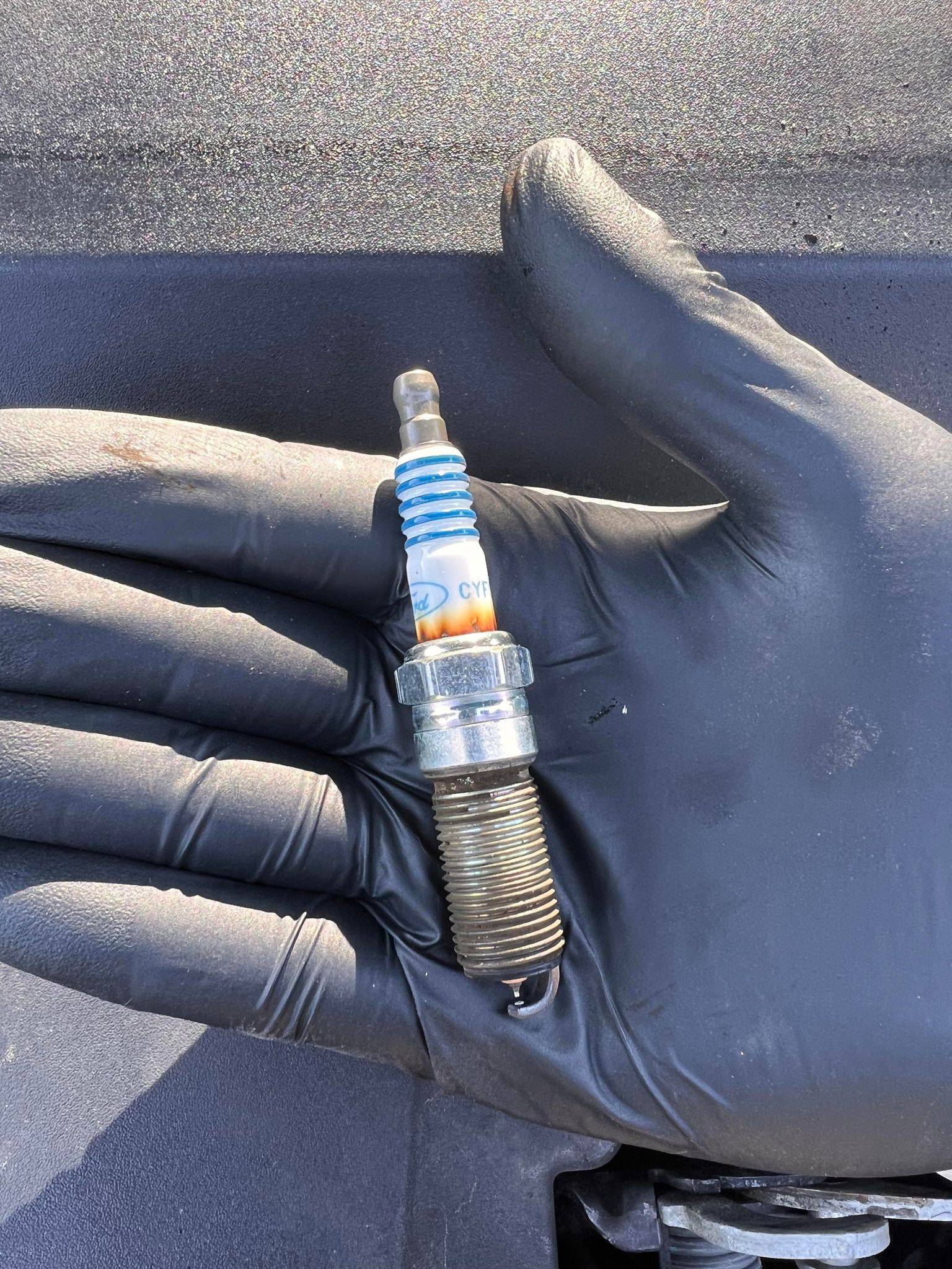

I pulled a spark plug and here's how it looked:
That was cylinder 2... at first I thought it was a little too clean, but it does not have that grey color to it. So I think it's actually good. No coolant in the cylinders. I only ever pay for the 93 octane fuel due to the cleaning additives in it. I'm chalking that clean plug up to that fuel type for now because I do literally EVERYTHING that should turn those plugs black (loads of short trips, long idles, etc.).

This is a bit of a weird one, but I have a hunch that there's a simple explanation.
My coolant level a couple of months ago was a little low, so I topped it off to the max fill line. It's the orange coolant that Ford used on the early 2019 Rangers.
