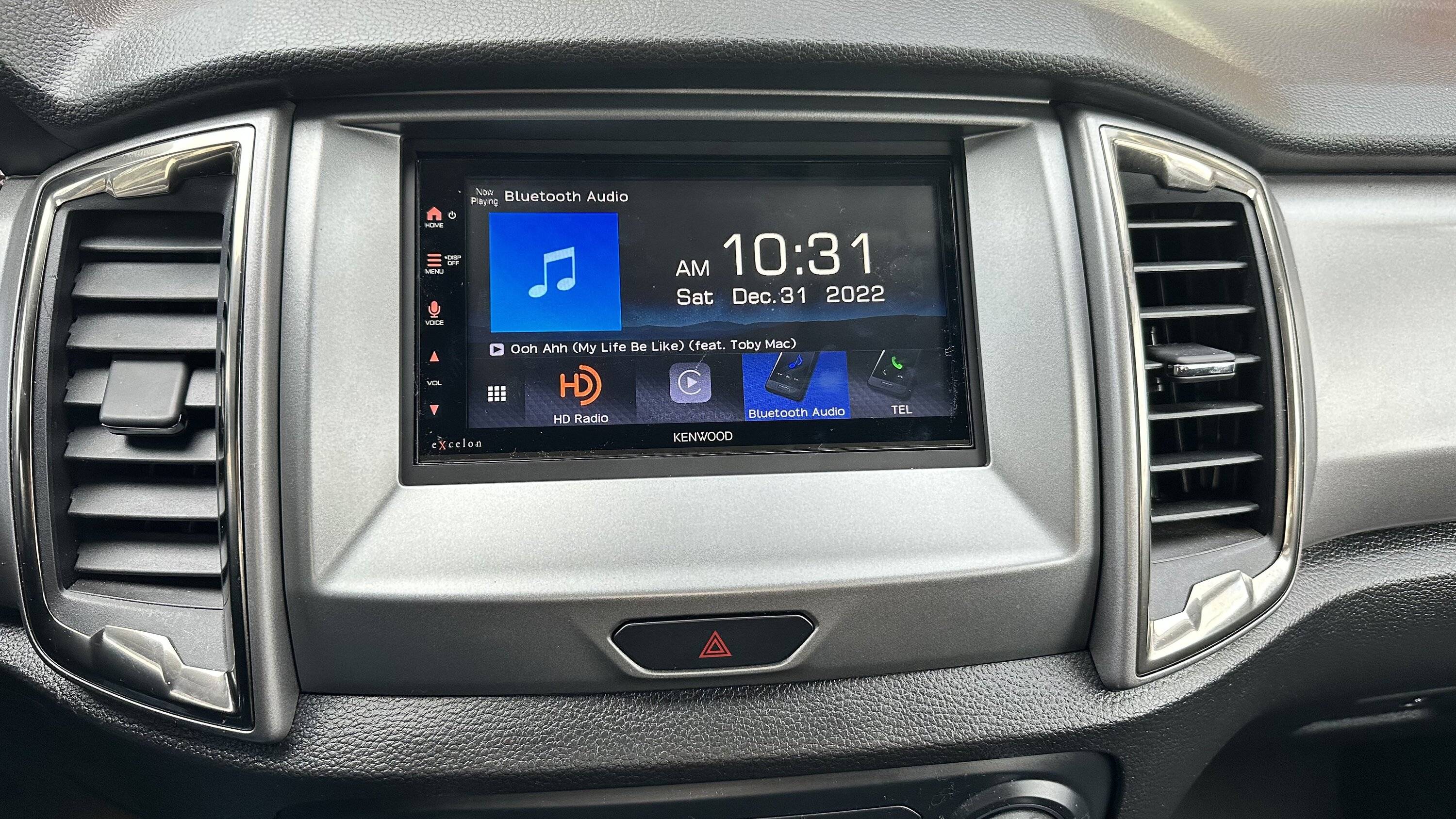

Thanks guys, for reference too they kept or tossed the Ford cables. Also be aware to have Car Toys install a new HU, the install may be free of the HU only and they charge extra for the cables, Maestro Sync unit, SiriusXM receiver (they hooked it up to existing antenna, but the Ford receiver is in the headset so you have to get another), and they will charge extra labor on the Maestro, Sat radio. So my $400 head unit total cost to install with everything to make Sync 3 work came to almost $1200

I got rid of the CRAPPY JVC unit. It was awful. Replaced with a Kenwood Excelon DMX709S and an Alpine KTP-445U
We’re you able to keep the backup camera, Sync features & Bluetooth? I’m also looking to replace the 4.2 screen and be able to use AA.
Thanks.
Yeah be advised even if you buy a unit and the place says they will install for free you’re still going to pay like $500 extra for parts and extra labor to install Maestro, new sat radio equipment and a lot of misc extra parts. The Ford system does not talk with new head units, etc. Also choose a head unit that says it has iData if you have voice commands, steering wheel tech package controls, tire psi monitoring and head unit controlled heat/AC stuff. Backup camera works. I returned the $300 JVC wife bought me because it didn’t have idata, upgraded to a different $400 JVC, hated it, returned in a week and got a Kenwood for $500, plus had them also install an Alpine in dash amp because sound was flatter without it. I think all said and done it costed about $1200
