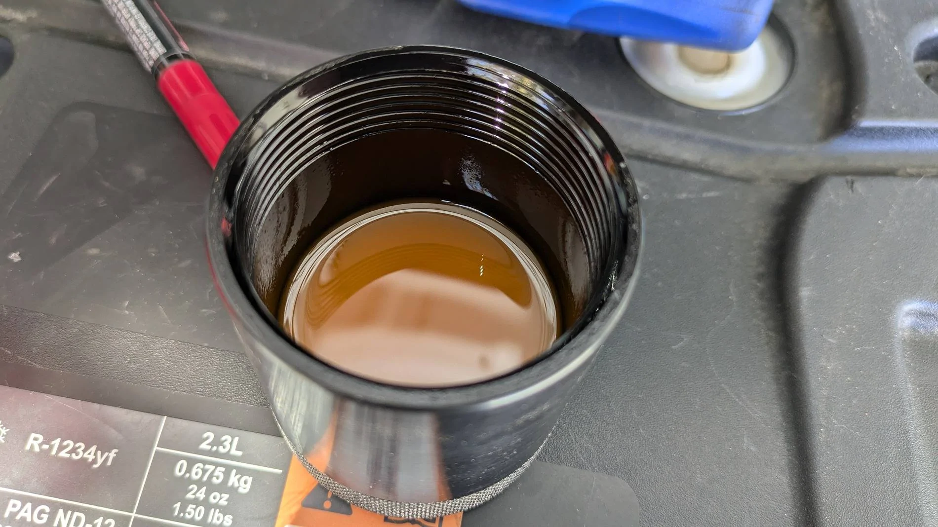

UPR Catch Can Contents at 25K Miles

Are you nuts? Uhhhhhh the 2.3T is actually really badass. Crazy good power and mpg, no oil consumption, very high longevity and durability. Toyota, Jeep, etc. are all garbage in comparison to the Cleveland 2.3T. The fuel and water in the oil is absolutely normal for a turbo in the winter. Do some research ??

i'm unaware of anyone having an engine failure on the 2.3L that the conclusion was that a catch can would have solely prevented the failure
I'm unaware of anyone being molested by Bigfoot while camping in the woods, but I still bring a gun
it's already difficult enough on manufacturers getting people to change their oil and do regular maintenance. introducing a catch can that has to be emptied regularly would find ford
They aren't introducing it, it's already there. It's on the driver's side of the engine, and it doesn't have to be emptied because it just dumps the contents into the oil sump if I remember correctly.
Probably why people complain about their oil smelling like fuel. That alone is reason enough for me to add one in front of the factory model I can empty BEFORE the one on the side of the engine fills with crap and starts recirculating it through the motor ? via the oil pump.
I actually JUST emptied this out of mine today after noticing a little extra smell in the engine bay.
That ain't a cup of coffee. It's mostly water/condensation as we've had a bunch of moisture in Colorado the last week. Then mix in some oily congealed goo and a little bit of fuel and bingo! Ecoboost hot cocoa!
