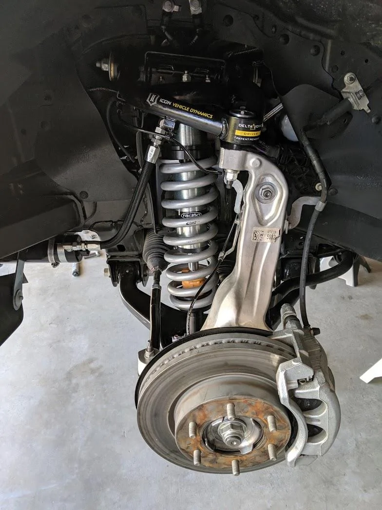

Upper control arms alone won't help increase travel on these trucks, but they will help if you're modifying the other parts of the truck that limit it.
They'll also add a bit more strength to your front suspension if you're doing a lot of really rough trails - Though I can say I've never had a problem with stock ones, and I push my truck pretty hard.

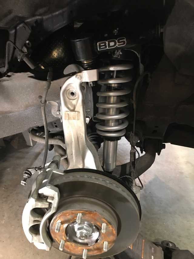

Something to keep in mind, if you are only lifting the front by 1-2 inches you most likely will not need the upper control arms. How did I come to this conclusion you ask? I have the Old Man EMU Lift wich lifts the front by 2.4 amd the rear by 1.6 and the front still has factory control arms. Mind you I have taken the truck Offroad plenty and have had the suspension for 30,000 miles already with no major issue.

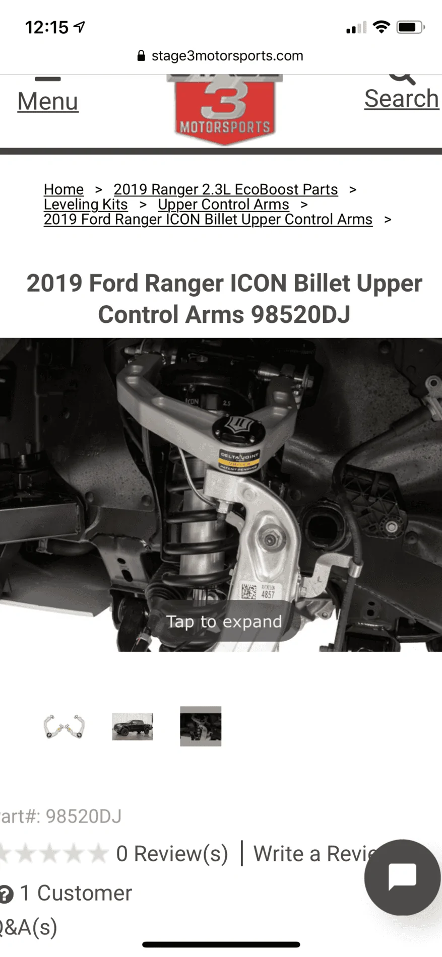

Not really true on no worries....Chloride compounds, like salt attack the protective coating of Aluminum oxide that forms on the outside of an aluminum part, and thus results in terrible corrosion. For this upper control arm, I would watch it like a hawk for corrosion unless the manufacturer has coated it with a protective, and durable coating. Based on the thickness of this UCA, it should be a non issue for many miles of useful life, but it should not be ignored, but inspected for corrosion. I would be interested in the CAE modeling of this part to understand if it is really robust enough for the front suspension. Likely this part was never analyzed.... What load cases, what were the boundary conditions. Where were the SPC's applied etc. As always...Buyer be aware!

Submerged as in little or no oxygen exposure. UCAs are not submerged, eh? And the ribbing lends itself so trapping and holding crud including chloride compounds.

Yeah compared to galvanized steel for sure. I doubt the aftermarket control arms were subjected to any salt spray testing as required by Ford for critical parts and program specific directives, so I am sticking by my admonishment to keep tabs on these aftermarket UCA if exposed to road salt.
