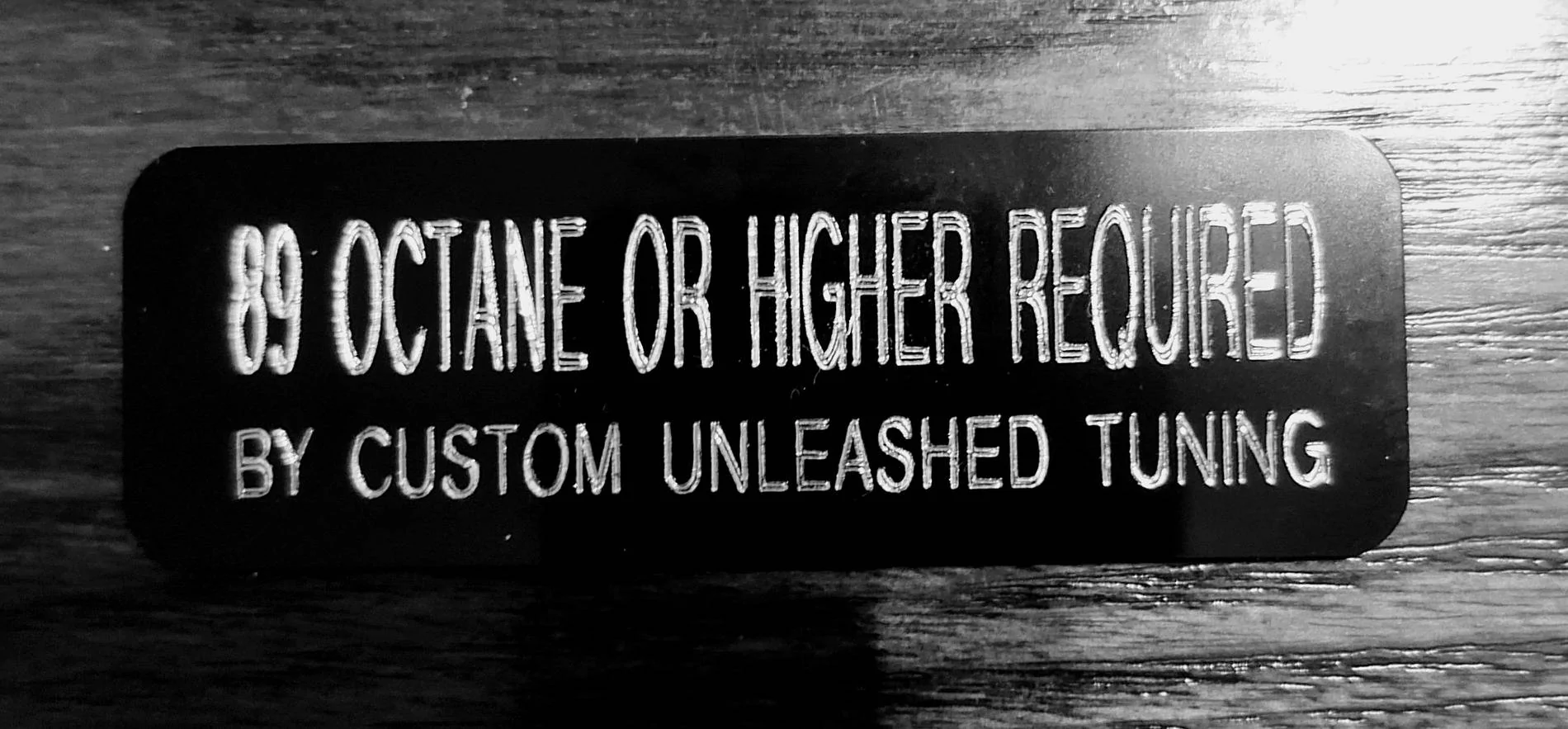

Did any of you guys ask to remove converter lock up in the first 5 gears? He sent me a tune 89 performance tune with the lock up deleted in the first 5 gears. I’m getting some serging mostly in 3 gear..hoping to remove that with the delete of the lock up in those gears.
