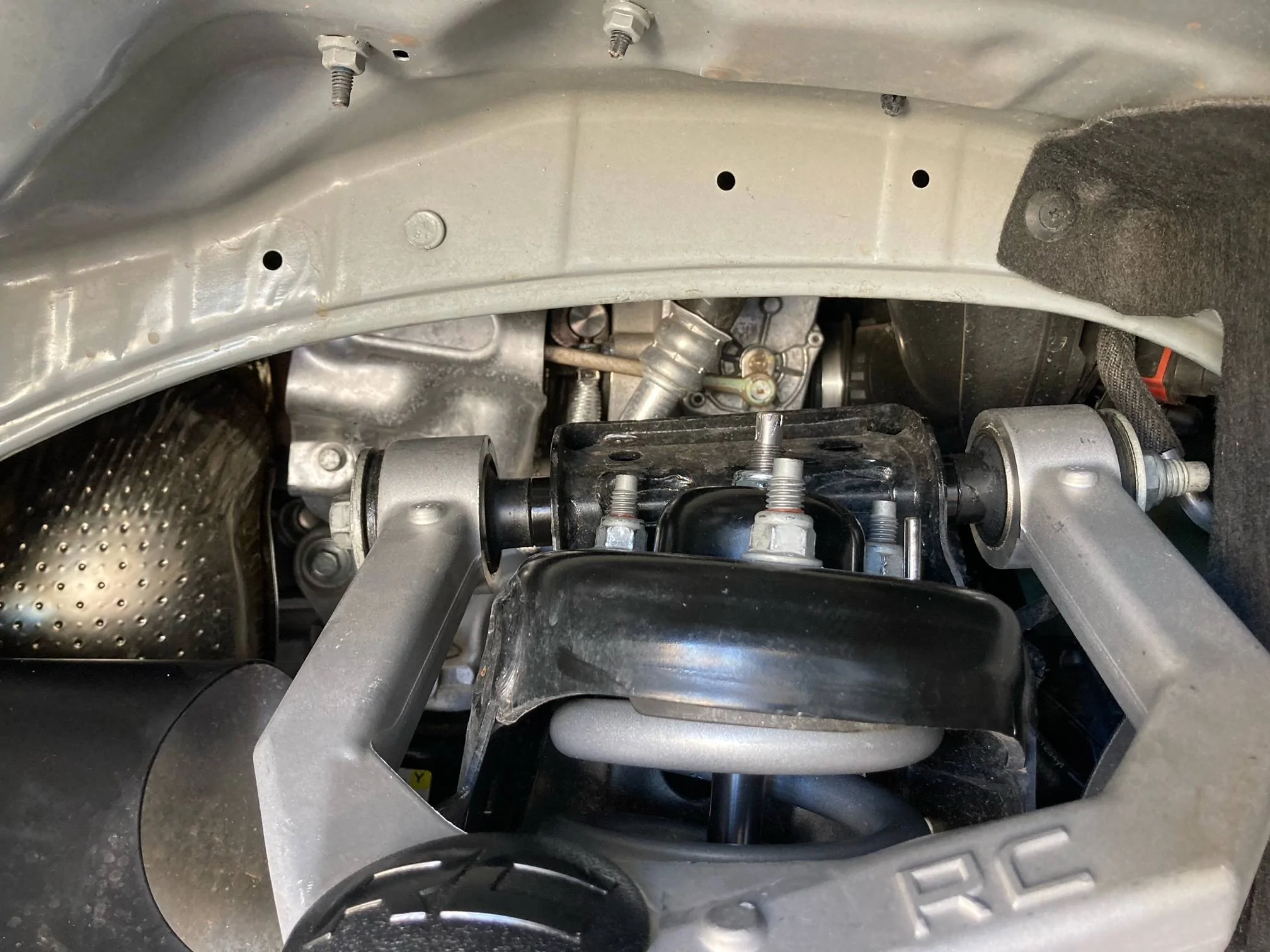

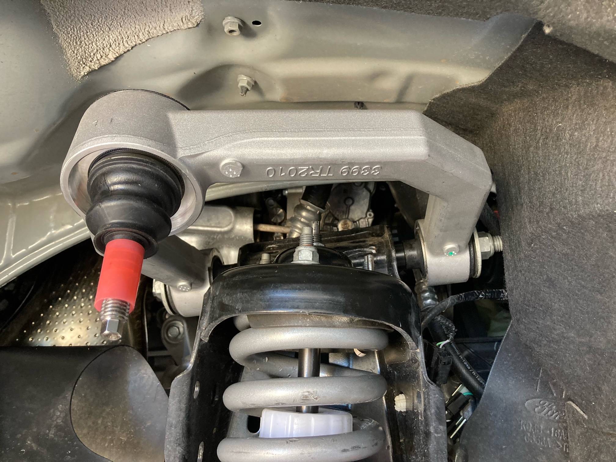

Installed the budget option today, $300 for a set of Rough Country UCA's paired with my 3" Eibach lift. RC says these only work with a 3.5", but a lot of tacoma people have had luck with RC UCA's (Also 3.5 "only") on their trucks, even with 2" leveling kits. An after market UCA just adds caster, and adjustable UCA's let you adjust said caster. I can't believe RC made a UCA so specific and precise it ONLY works with 3.5" of lift. Alignment is tomorrow, I will let you know. I am asking alignment guy for 0 Toe, 0 Camber, .5degree more caster on left (positive). We will see if the $300 is worth it! It does feel smooth and so, so much better than factory UCA's.

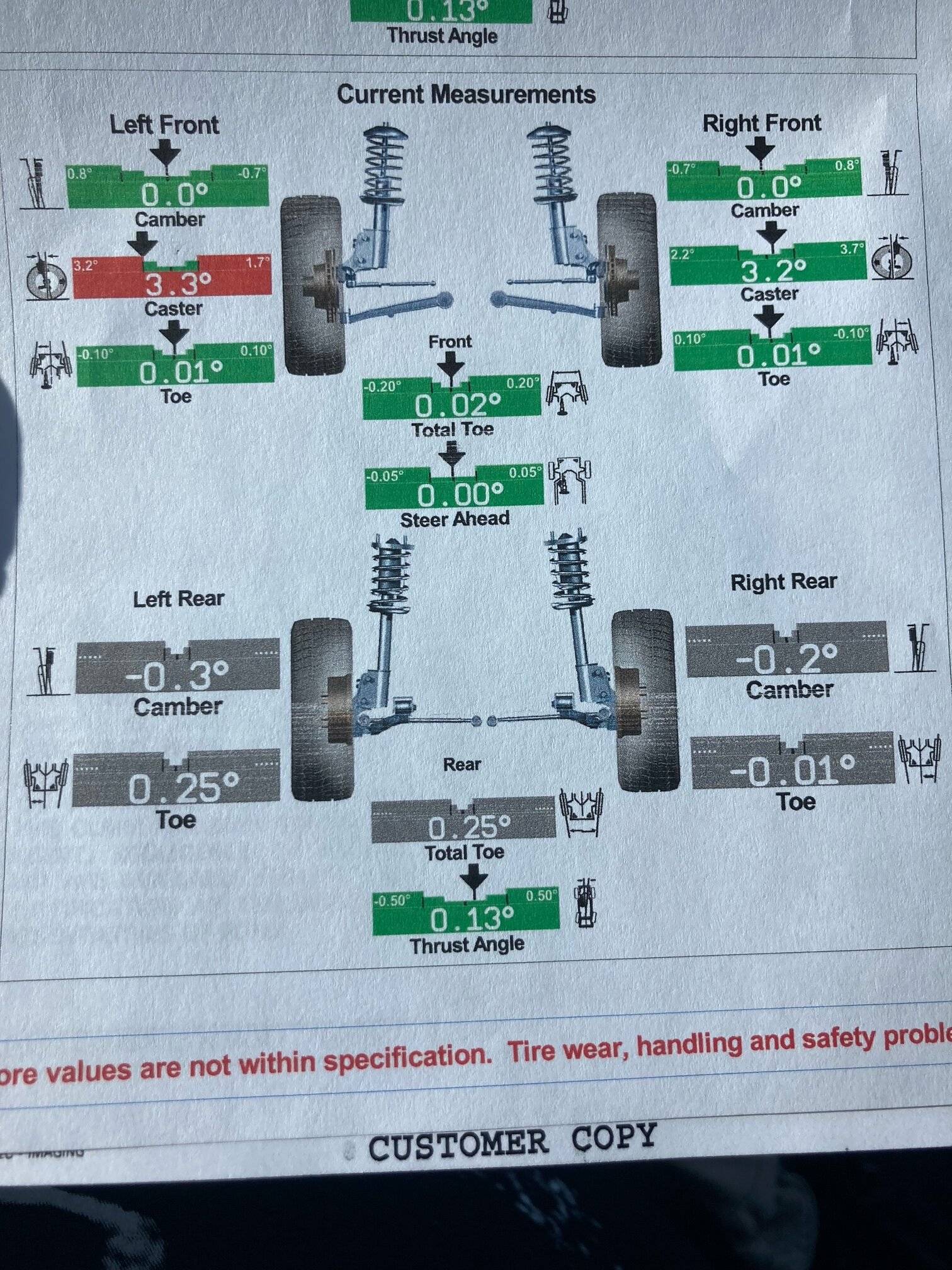

Alignment was spot on. I was right about the RC UCA's. Even though they say they "only" work with 3.5" of lift, they work with less, My Caster is low enough I bet you could use these on 2.5" lifts or even just 2" leveling kits.

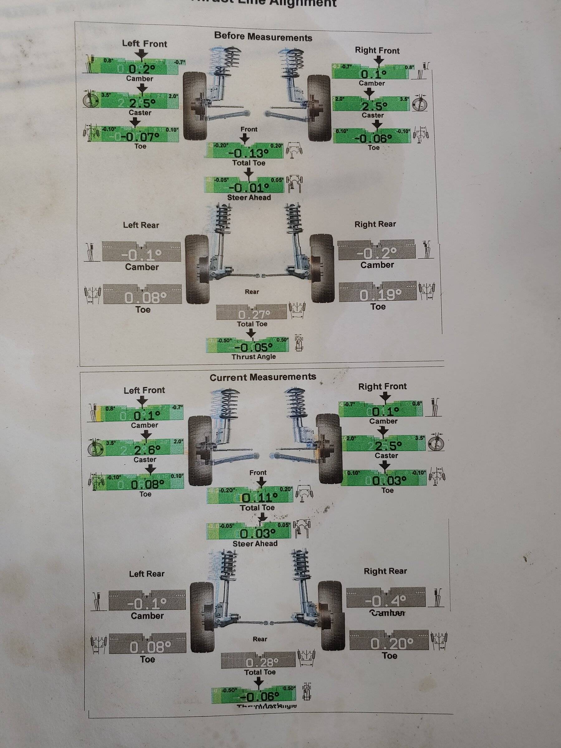

In general good, my suggestion is to bring toe in just a little more(closer to 0.04/0.05). That is where I found it optimal.
Below is what I had my truck set at with factory control arms and the Old Man EMU Lift
