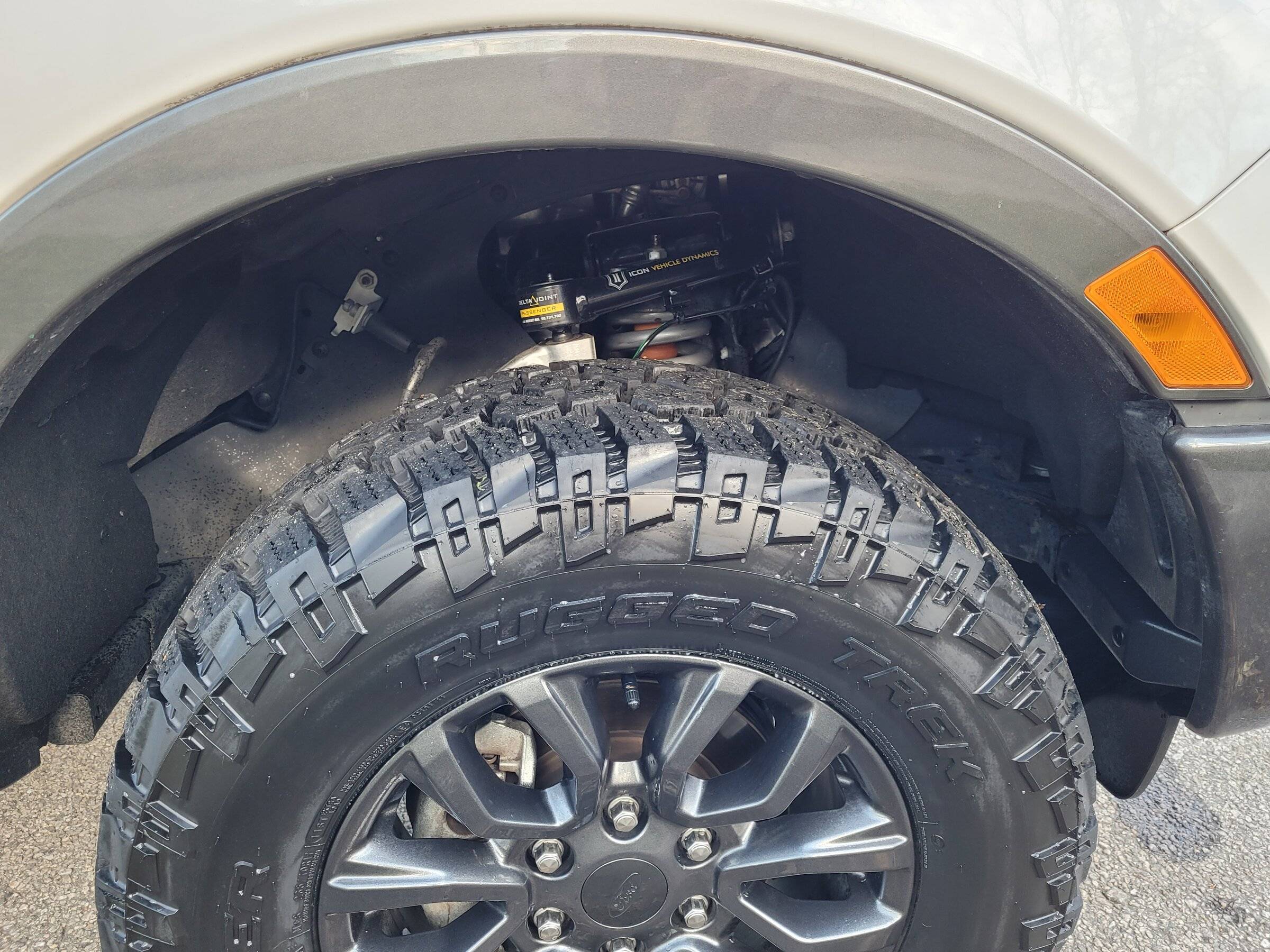

For me the answer is yes. I had my Eibachs pro truck 2.0 extended coilover/ rear shocks on for 4k miles riding smooth and aligned within spec.....then I saw the Stage 3 Icon UCA group buy.
I had slight buyers remorse upon recieving them, they aint cheap even 25% off. But after installing them I definitely can tell they make a difference in ride. Driving on rough pot hole ridden DC streets they smooth out the bumps/ ruts. I have limited offroading since installing them but its a noticable suspension improvement over whoops and uneven terrain. Did I absolutely need them? No, but I am very pleasantly surprised in the the improvement they made. Hopefully they will also help with they longevity of my front suspension.

I agree if after a lift if you can align to spec they are not necessary. But there are other advantages such as more wheel travel if you have extended length struts as I have. Also better articulation. I added my UCA after upgrading my shocks and tires and can say they improved the ride. Much better response on rough terrain smoothes out big bumps. Is it worth the price? For me it was, others perhaps not.
