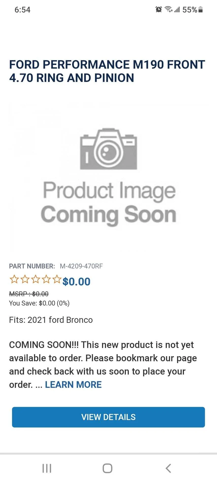

I had 35" BFG mud-terrains on my 97 Dodge Ram 1500 with 6" of lift. It had 3.55 rear gears. That truck was a 5.9 magnum with some bolt on mods but definitely not a power house. The 35s killed it and I couldn't even run in OD on a slight uphill.
I swapped the 3.55 gears with 4.10 from Yukon Gear and never looked back. After the gear change the performance was on par with stock and the speedometer and odometer were spot on.
I understand that the ten speed trans helps maintain performance with oversized tires but lowering the final drive gears will really make a huge difference. It may even gain back some MPG because you will be able to run in the higher gears.
Unfortunately they have yet to produce over size gears for the m190 the first set I've found is the ones above.

Also bronco having a m190 front diff benefits us as they are now coming out with ring and pinion sets for us.
If they have one size they are likely working on others. Have faith!
You are definitely right about the Bronco aftermarket overflowing into Rangers. You 4wd guys will get some interesting new stuff in the near future.
I feel like COVID and other global crap are putting the brakes on some of the aftermarket development. Fingers crossed that some cool stuff comes around.
Just on a side note. Are both differentials the M190?

Non sasquatch broncos run a m190 same as our front. Bronco sas and upper models use a m210 the rear of ours is a m220

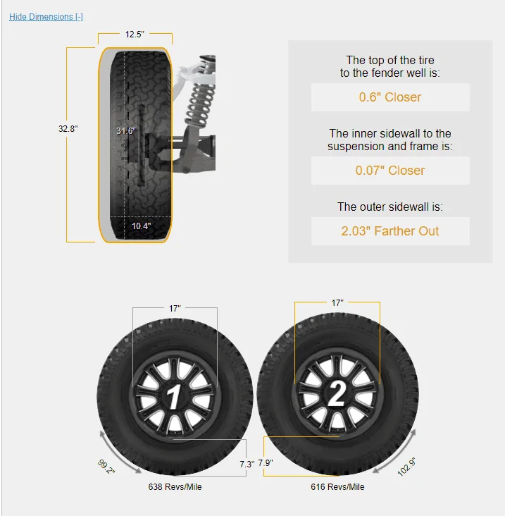

Whoah, very cool build.
Makes me feel better about what im planning for mine;
RTR+30mm offset 17" x 9" wheels, with 33"s (32.8") x 12.5 tires.
Hoping all i need to do is remove the crash bars and all works fine.
Hows your tires on full lock to everything? Felt liner/air dam etc?
I had to cut the felt liner back, remove both crash bars and the thick plastic block (intrusion block?) that is right behind the felt, cut the pinch weld/fender flare slightly, and cut the front crash bar mouting bracket.
Sadly, I had to give up my Rokblock Front Mud Flaps as well.
The air dam was removed with the front bumper.
I am planning on modifying the intrusion block and putting it back if I can.
