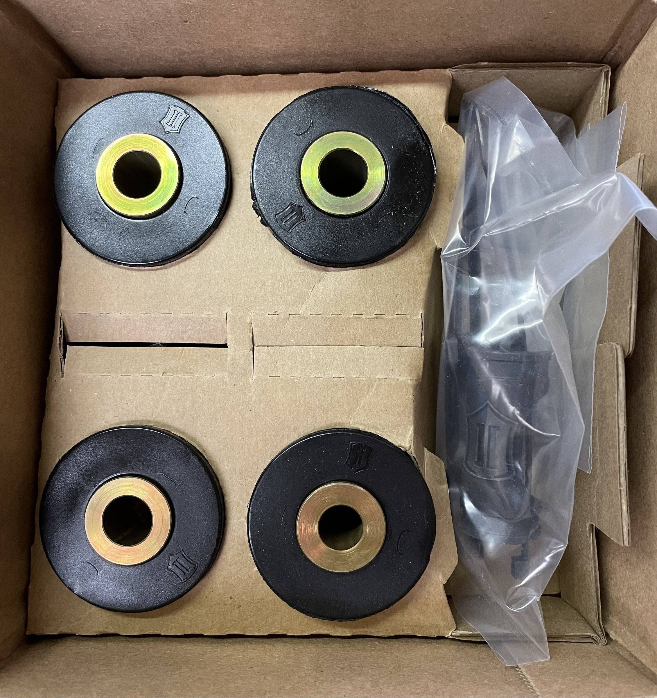

Here is mine. I feel like it is "which one of these is not like the other, now it's time to play our game."
Answer: The lower right for those who take too long.

I lucked out and all my bushings were same size. Got them mounted on the truck along with new Fox 2.5s. Just got back from getting truck aligned and this project is all wrapped up.
Funny thing ... had a clunk driving back so popped wheels off to recheck torque on everything and I had forgotten to tighten passenger sway bar end link. Thanks to this thread it was on my mind to check. :)

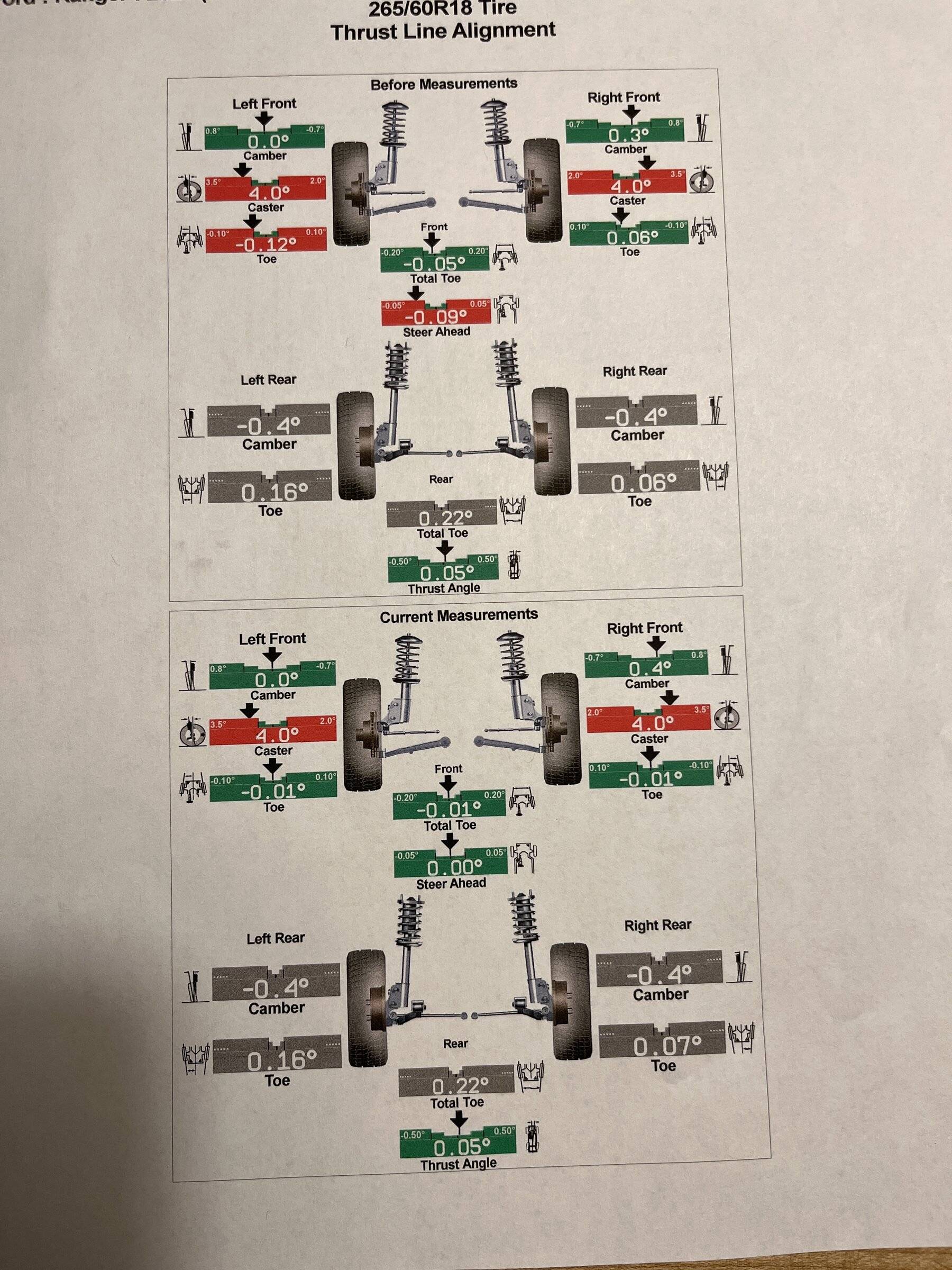

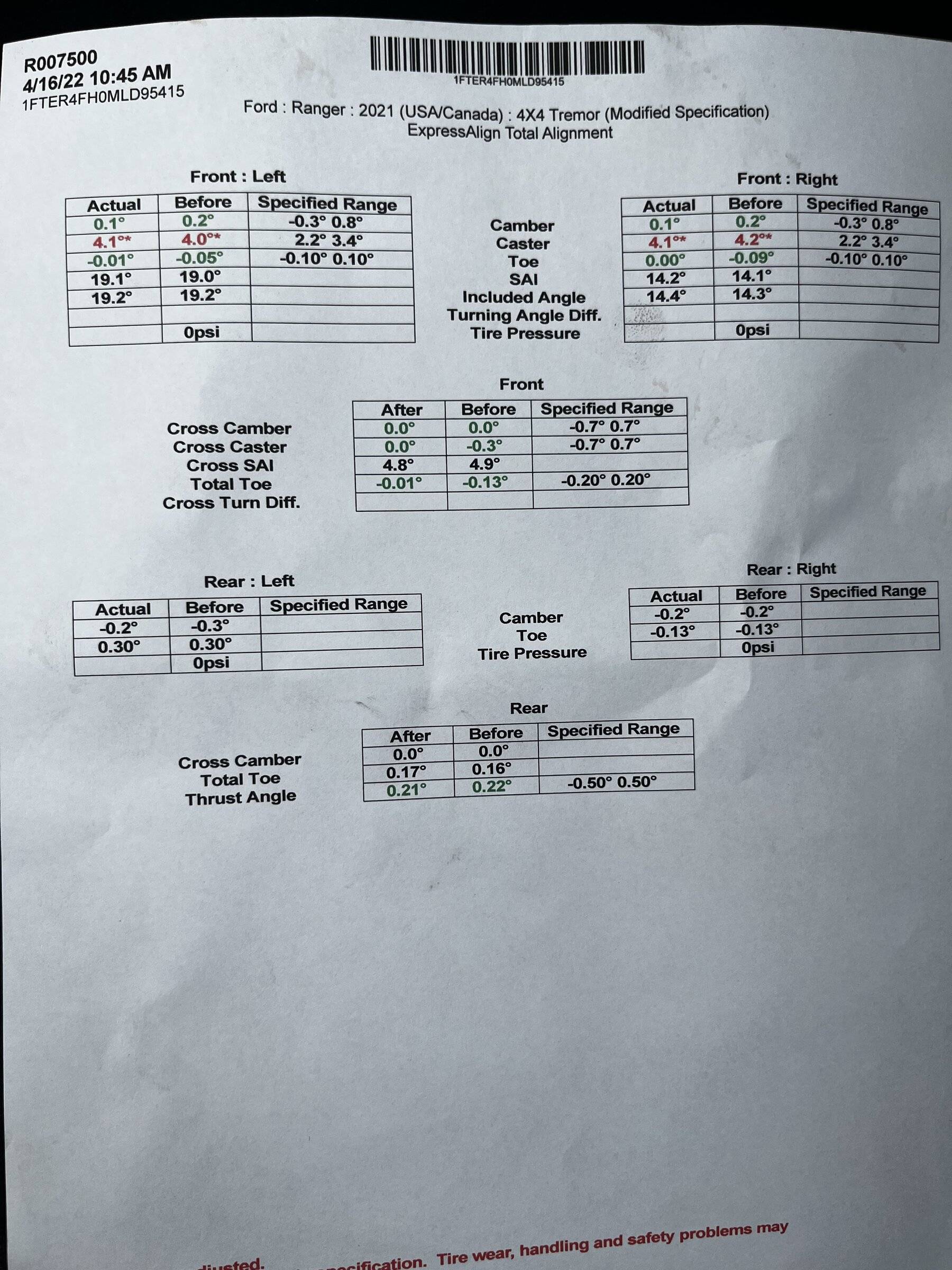

Front lifted a full inch after settling. I did not change the preload on the coil over. I am now only 1/2” higher in rear so essentially leveled.
Alignment results are attached. They seemed to have no problems and only really needed to adjust toe. I told them to leave caster high.

So Icon is a joke.
I'm a Jeeper and Icon doesn't really have a presence in the community.
I learned from my offroad group that Icon has a terrible reputation in the Toyota world.
This is all playing out with my control arm.
Basically Icon said they are prioritizing new orders, versus shipping me the correct bushing.
No ETA.
I'm not happy. If I don't get an answer soon, I'll issue a return. I purchased this with my Amex, so I'll go down that route if needed.
For the record, Stage 3 has been great so far. This is Icons issue.

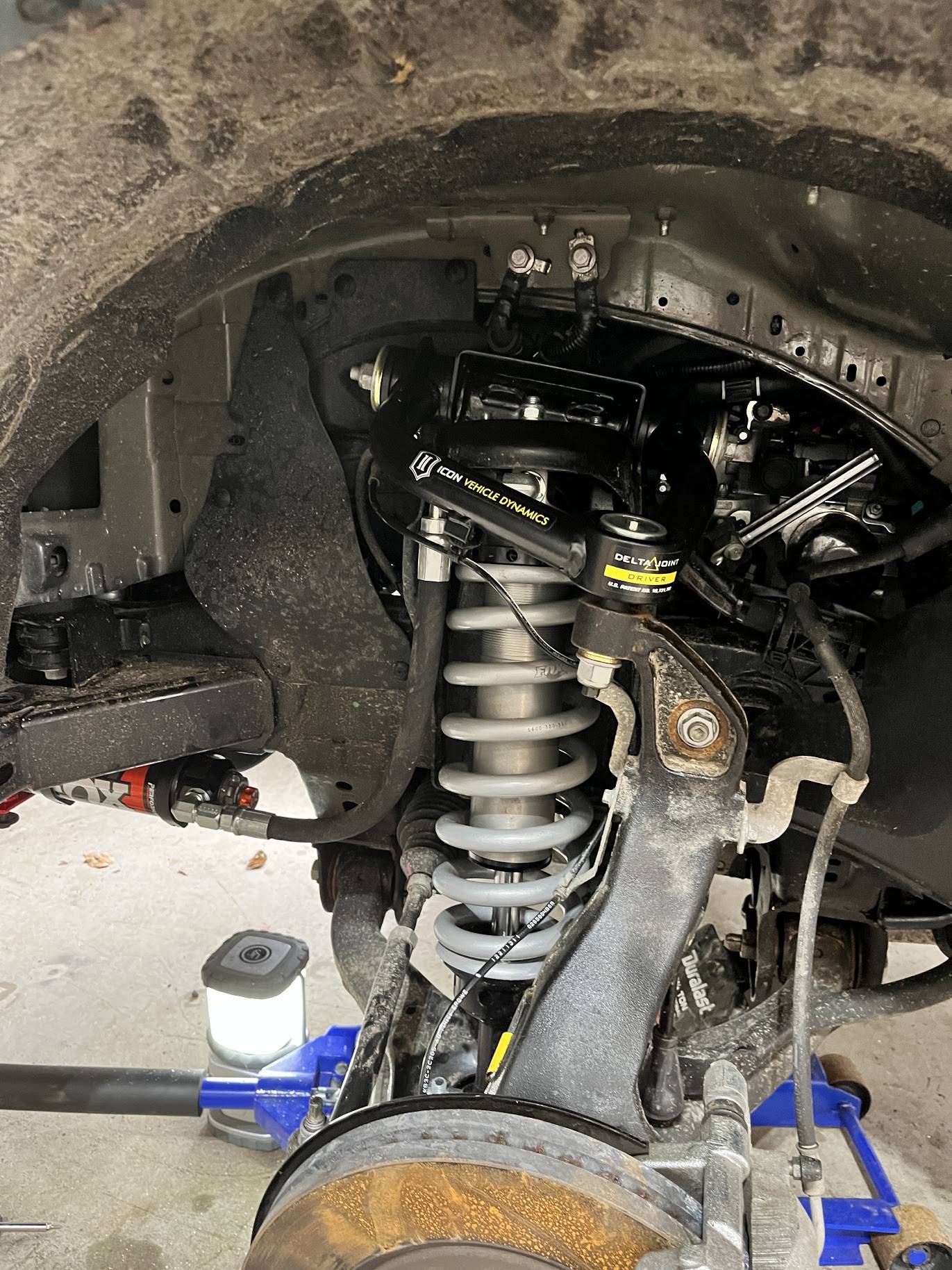

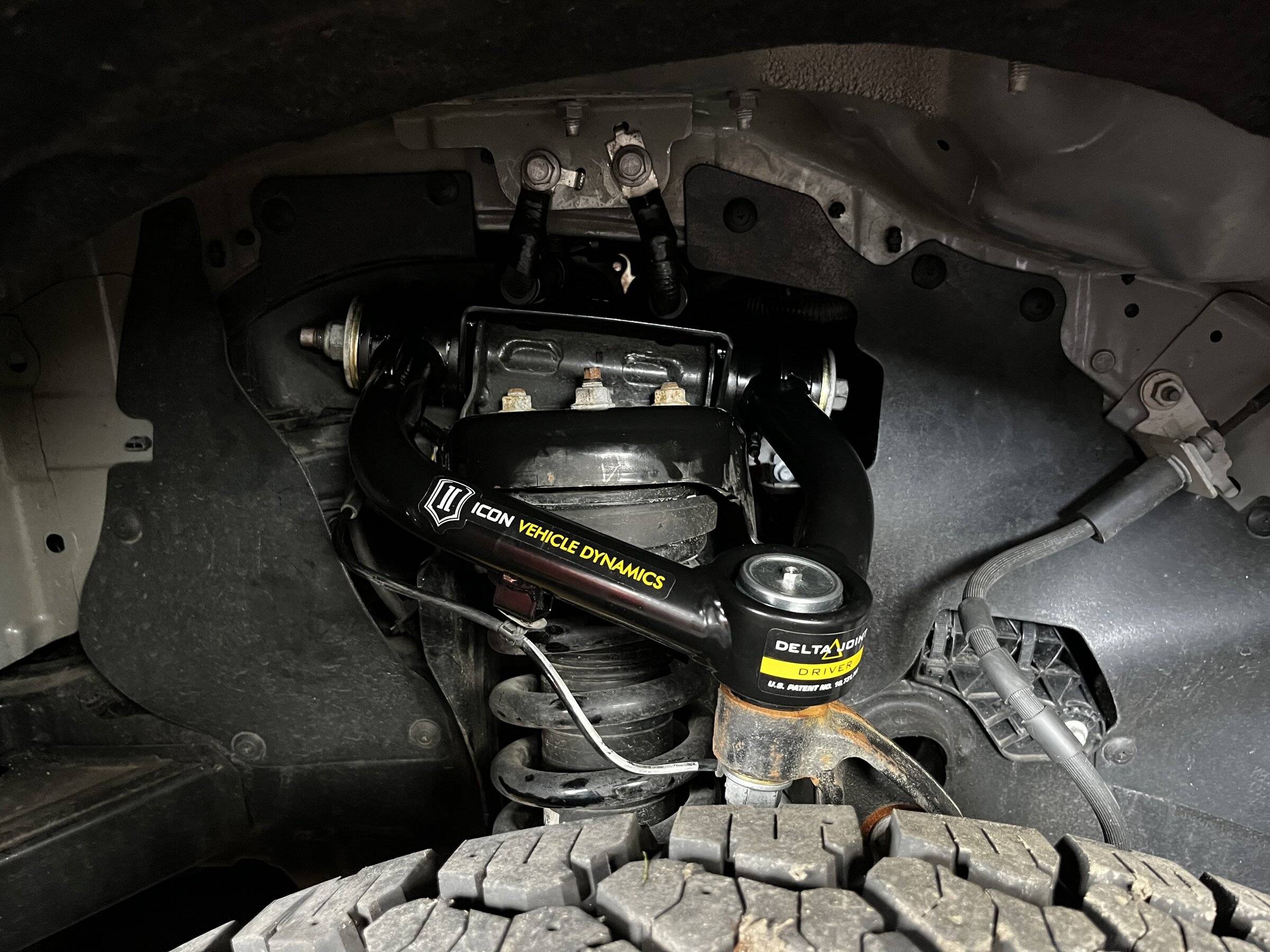

Installed my Icon UCA’s yesterday and got my alignment today. Came out perfect. Factory Tremor suspension with a 2” level spacer up front.
