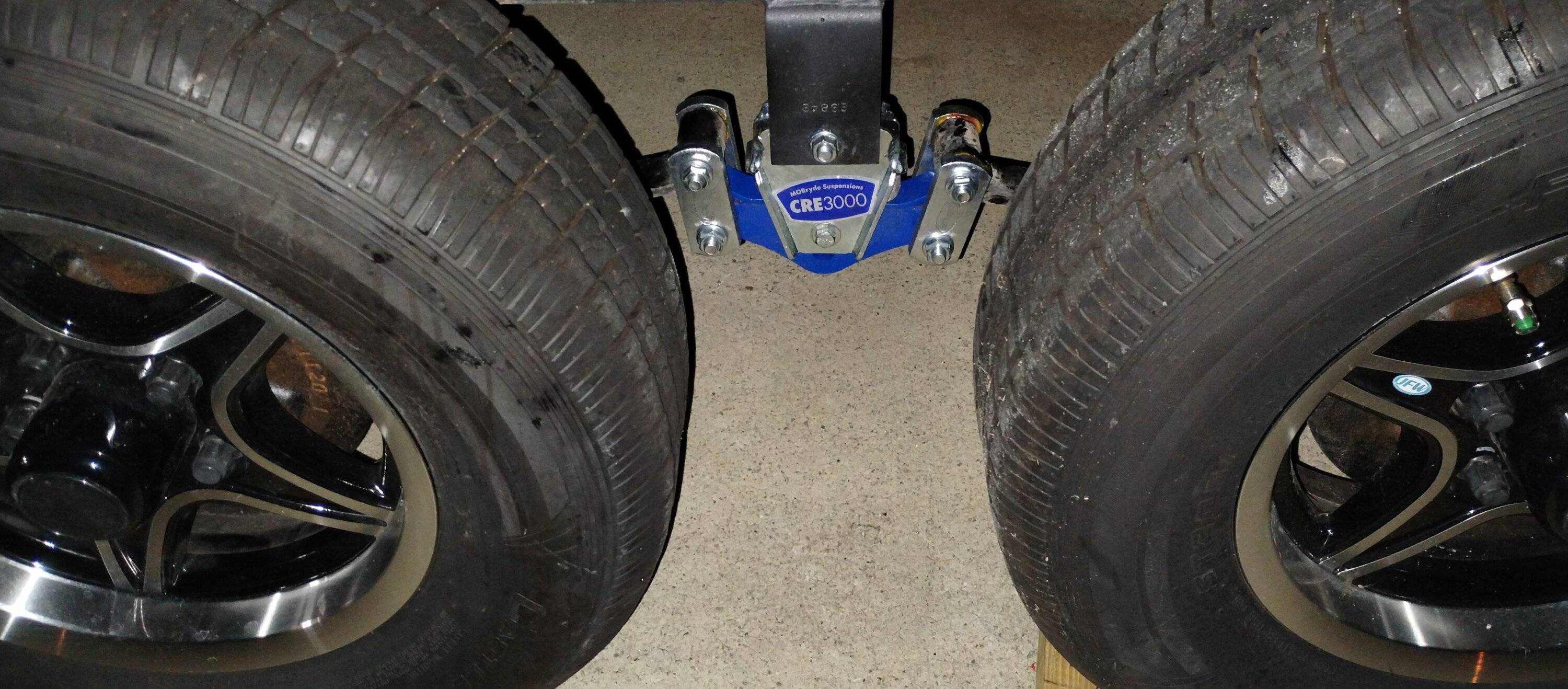

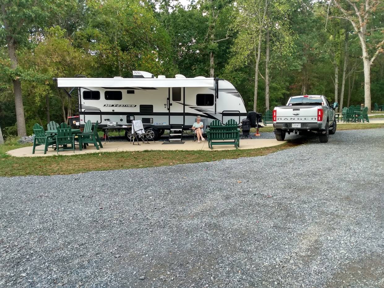

It's a Jayco Jayfeather 24RL....29 foot total/24 foot "box". Loaded weight is close to 6800 with my tongue a heavy 730 lbs. I have the Ranger set up with Blue Sumo's, Eibach rear shocks, Yokohama E rated 10 ply tires, and a Roadmaster Active Rear Suspension set up....takes the place of and acts as a sway bar, track bar, traction bar and air bag set up, all in one.

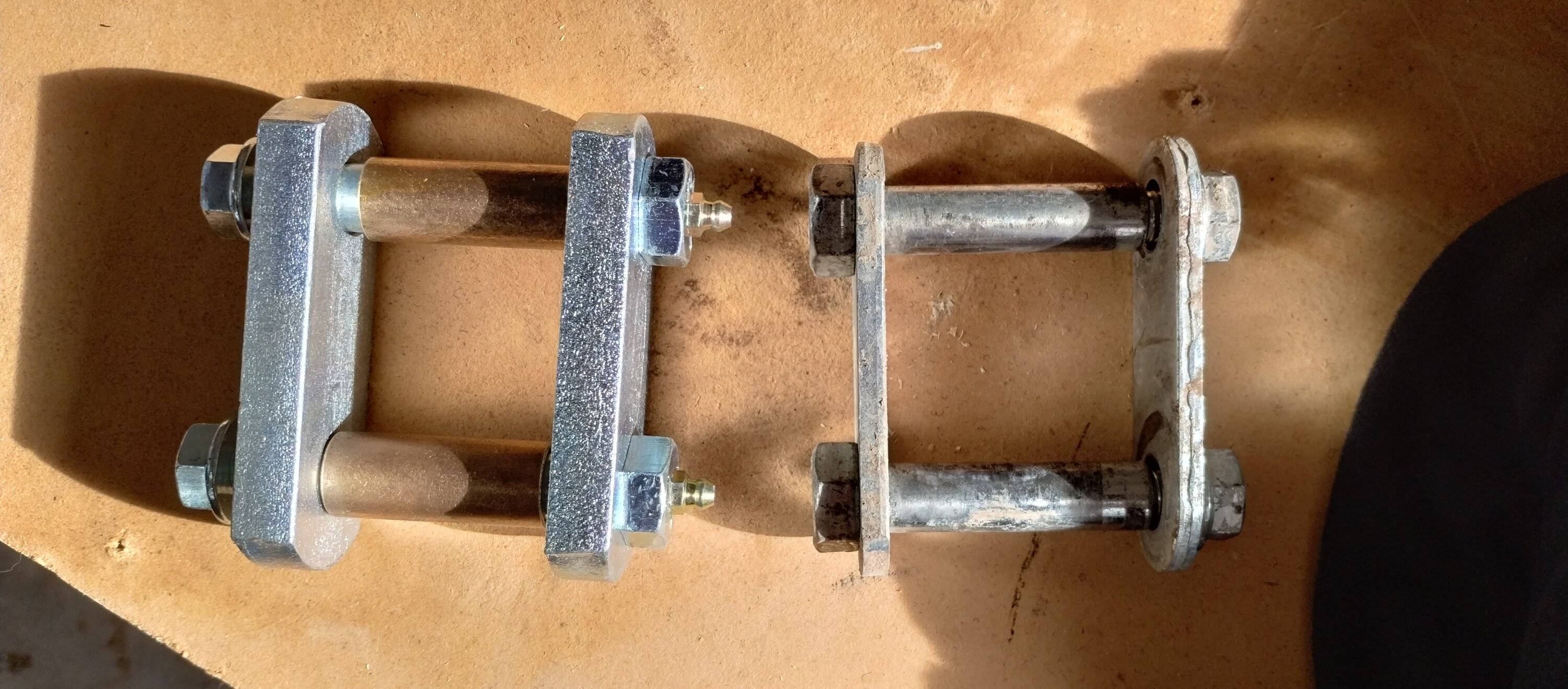

I think I mentioned it briefly in one of my first posts. Don't discount what you're doing with the trailer. Good tires for it and an upgraded suspension will reap benefits to your towing comfort as well as being easier on the trailer.
I didn't see what you were looking at, but at that weight and length it is going to be a tandem axle setup. There are a bunch of different upgradeable spring equalizers out there, and most of them work roughly the same. The end result of them is that they help absorb some of the shocks to the trailer on rough roads/bridge expansion joints etc. End result is that there's more energy absorbed in them and less transferred to the truck. They make the whole experience that much more comfortable.
Plus, while you do the upgrade you can get rid of the absolutely shit bushings and bolts that will be in your suspension. They come from the factory with plastic bushings and several of mine had almost worn through before we even had 2500 miles on the trailer.

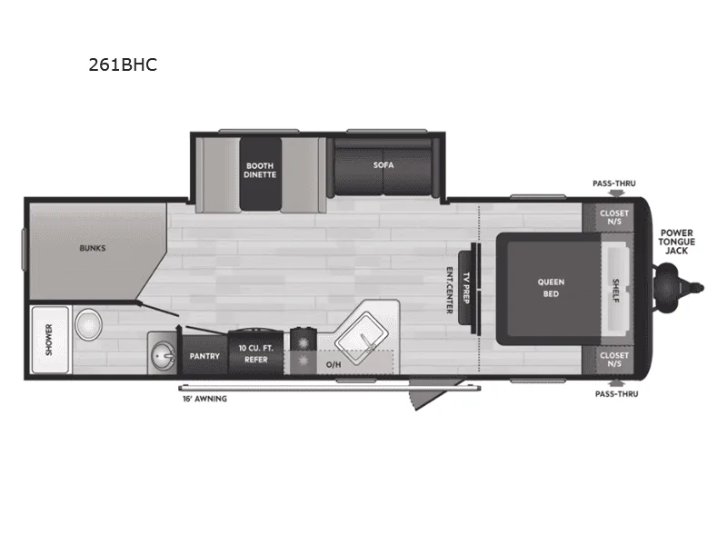

We are getting a 2024 heartland 261bh-c.
Do you have a link to it? I'm seeing a bit of confusion with that. I see a Springdale 261bhc.
Is it this floorplan?
