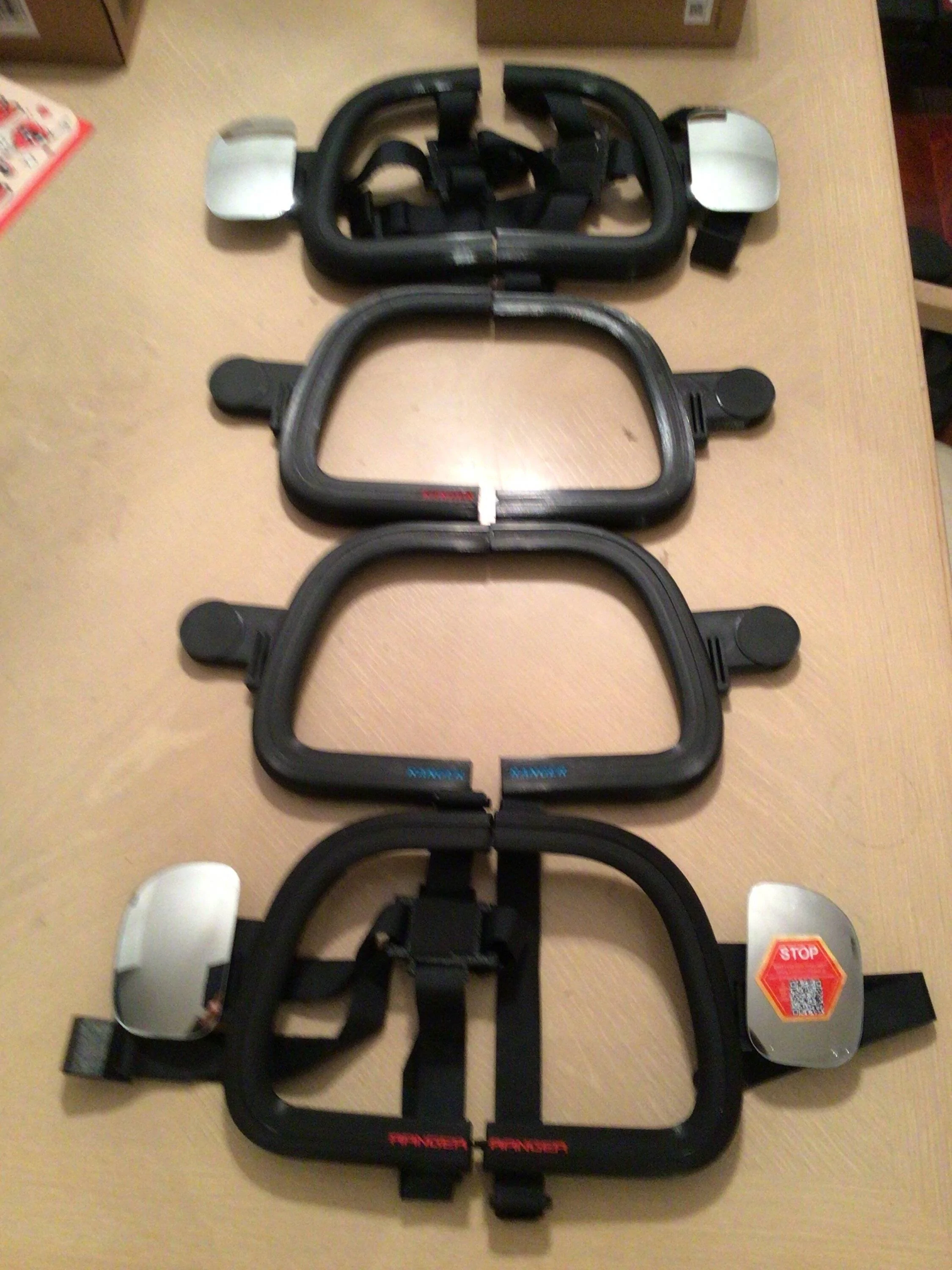

Looks pretty good and quite secure. Does
Absolutely beautiful! Your logo work is fantastic!
I'd love a set but I don't tow much, so let's see someone that actually does trailer be the testers for you.
You do really beautiful work, wow! =)
Thanks for your compliment David. I love your Red Ranger. I can’t say I’ve seen that many in red but the color really pops. When your ready to tow I could 3d print these in Red plastic instead of black.. ?

good question…on low quality resolution they take about 15 hours per pair. High quality takes about double that. So not very efficient but once I get a final design I plan to tweak the print settings to increase speed. I’m in it for the fun factor at the moment but getting the feedback so far maybe I look at taking it more serious. Btw , I can also change the text that’s printed and customize it.?

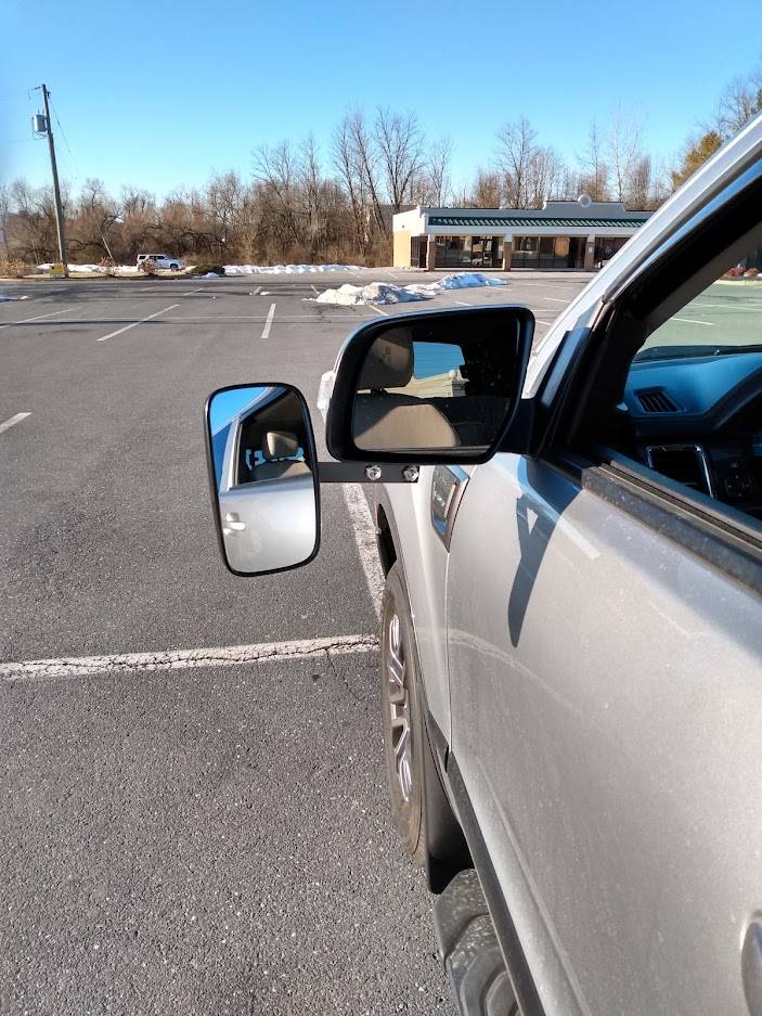

Ok, here’s a pic with the trailer hooked up. Definitely can see more to the side of trailer. Not sure about backing up yet but may try to find a larger mirror To stick on. Stay tuned….

Searching Amazon to see what’s available. Feel free to make a suggest or if you see something that looks like what you’re thinking about, let me know! I’ll have a better idea after this weekend about how it handles the blond spot on highways.

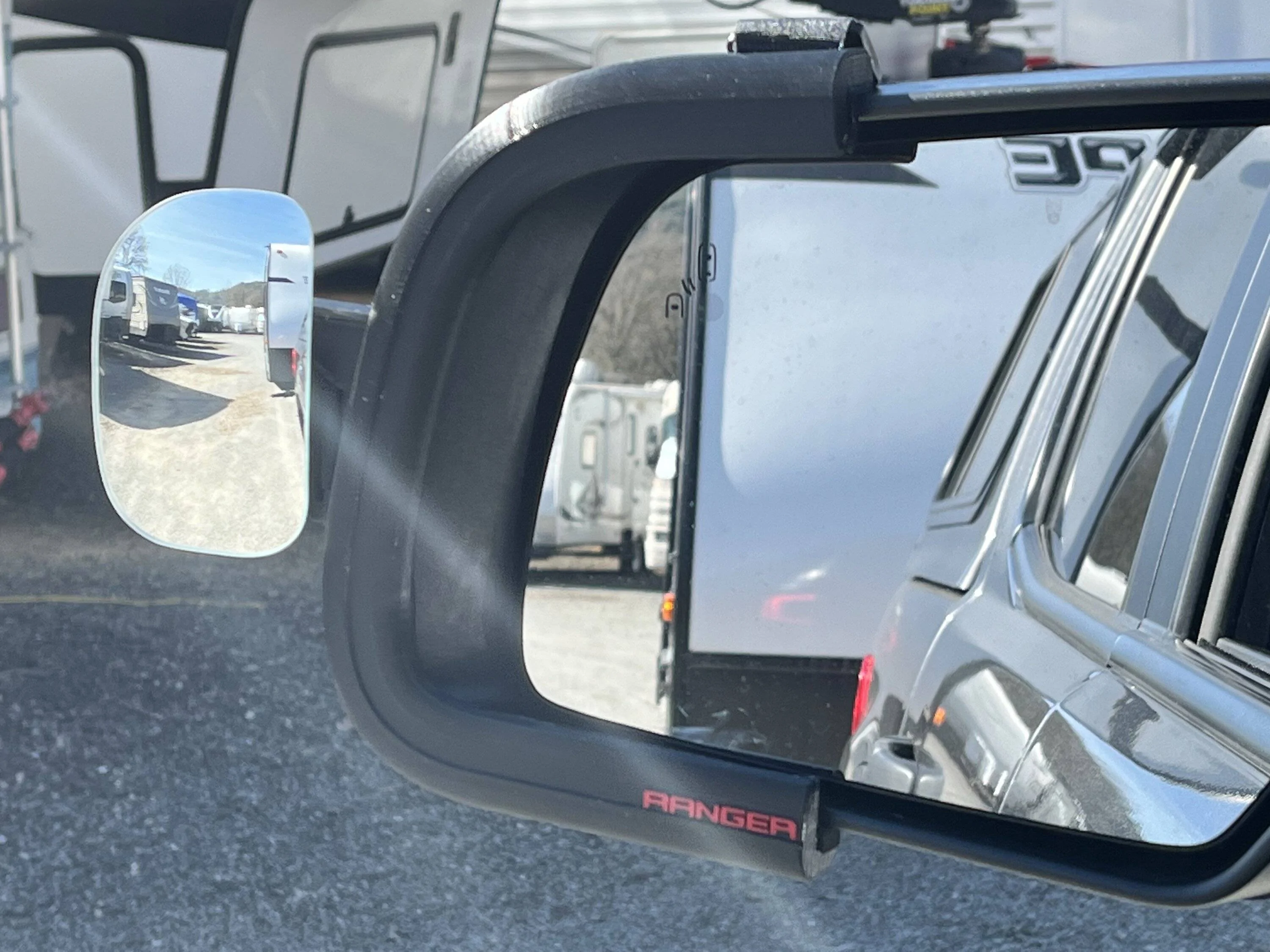

Andrew, back in Feb of last year, before I bought the Clearview set, I experimented making a set of tow mirrors using some aluminum brackets that I made up. Made them so a bracket could be mounted permentantly to the underside of the OE mirror, and made some detachable brackets with mirrors.
To an extent the worked, but when I used some larger mirrors, they acted as a "sail" and at anything over 50 mph, would cause the mirrors to fold, even against the factory power detents.
If you go larger, don't go overboard as the same thing may happen. Maybe if I had used smaller mirror heads it would have worked better, but my trailer is a full 8 feet wide and I am used to larger mirrors.
As we tow quite a bit, and frequently, when the Clearviews came available for the US, I bit the bullet and bought a set.
As I posted, if yours had been available I would have loved to give them a try....good luck....great idea.

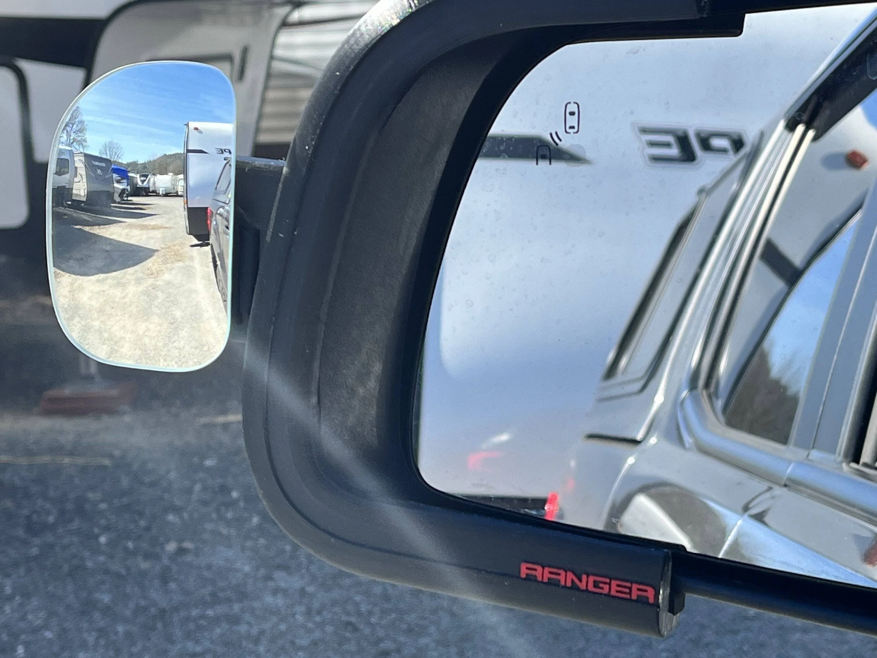

That’s a nice big mirror. That might work but I worry about the “sail” effect. These look promising. I know I can modify the mirror mount to attach these… ?
10L0L Golf cart Side Mirrors for Club Car EZ-GO Yamaha and Others https://a.co/d/dCGaPcm

The one's your looking at are 5" x 7"...one's I used/pictured were 4" x 8", not too much of a difference, and they did act as a "sail". Experiment with yours, but I don't think I'd go too much larger than your present mirror...maybe an inch or so larger height/width.
If you'd like, I think I still have the one's I used...PM me your mailing info and I can send them out to you to play with. Not going to use them and there just sitting in my shed....no charge as your helping other members out.
Their from Amazon...Fit System Clamp On Mirror, CL-082.
