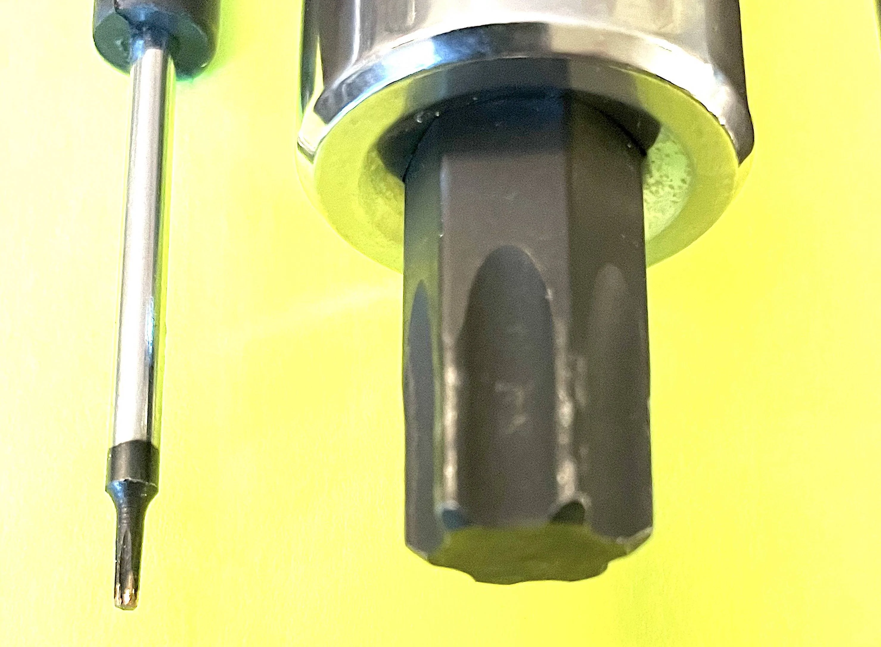

Torx are not expressed in millimeters. I'm not sure what the sizes convert to, but a T60 is equal to a 12mm Allen wrench, and a T5 looks to be 1 mm diameter; 5:1? I have a T60 to remove the 12mm hollow front axle bolt on my motorcycle, which is Allen head. Pictured is a T5 from my T5-T10 set (also incl 3 flat blade & 2 Phillips heads) and my Craftsman T60 1/2 in drive socket.

Oh no!!!! If a T60 socket = 12 mm, then a T50 must equal 10mm!! Better buy a couple dozen.
