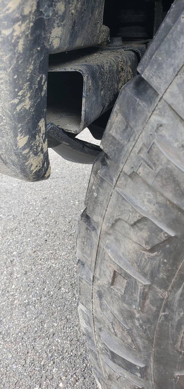

It appears my passenger side tire is rubbing the sway bar
Same here. It’s barely rubbing the sway bar. Only on the passenger side when turned all the way to the right. I just put on 265/70/18s on stock rims. Curious if anyone had same issue and was able to fix. I’m not too concerned but would be nice to resolve.
EDIT: I’ll add that I lifted front about 1.5” and rear 1”

Put 1/4" spacers on. That would be the quickest easiest option.
