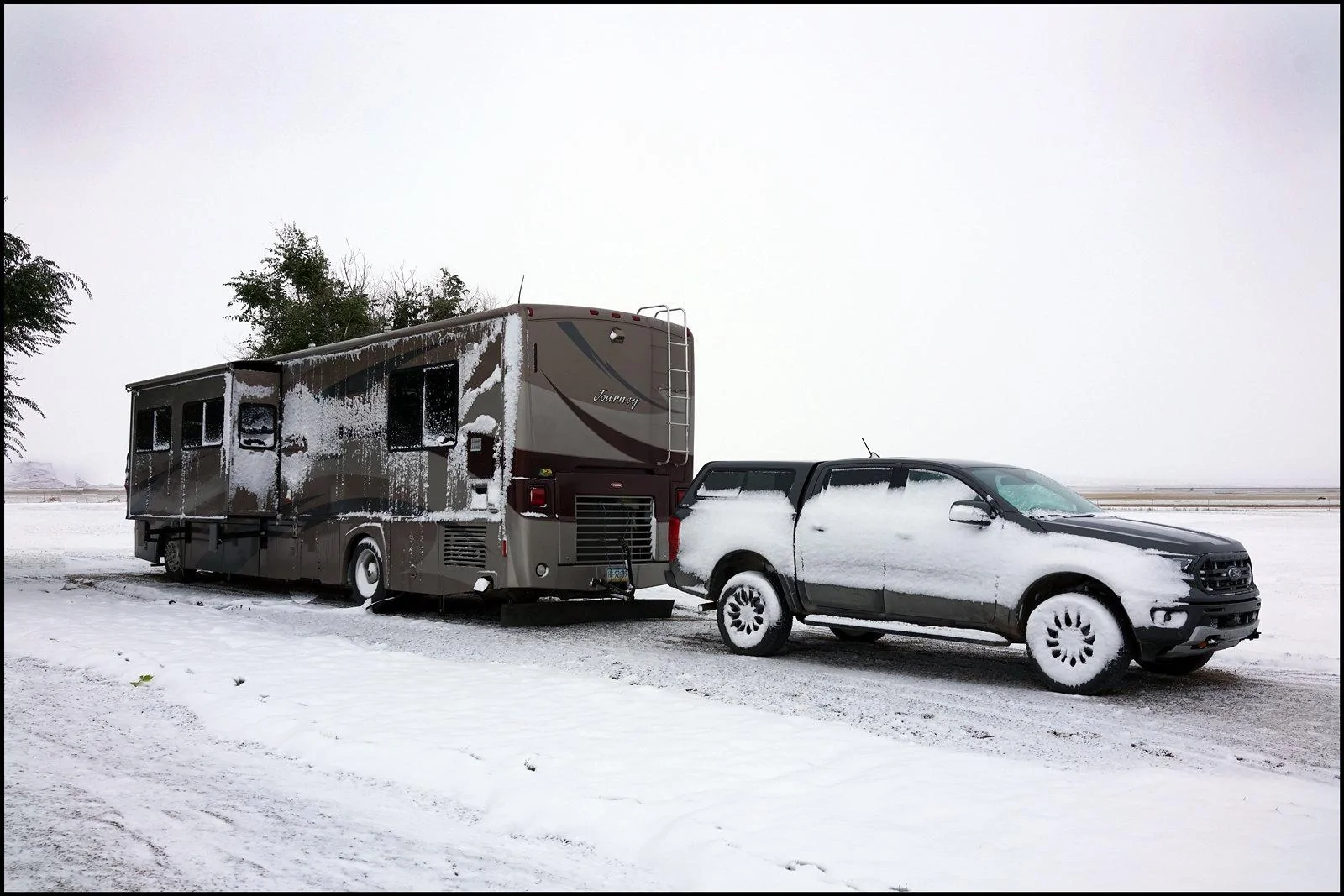

This is my first post here. I purchased a Ranger Lariat last June. In addition to use for daily transportation, hunting and around my property, I bought it to replace the older truck that I used to flat-tow behind my diesel pusher motorhome. I've been very happy with the Ranger so far and it has earned its keep in some really difficult off-road situations. A blizzard in September in Montana:
