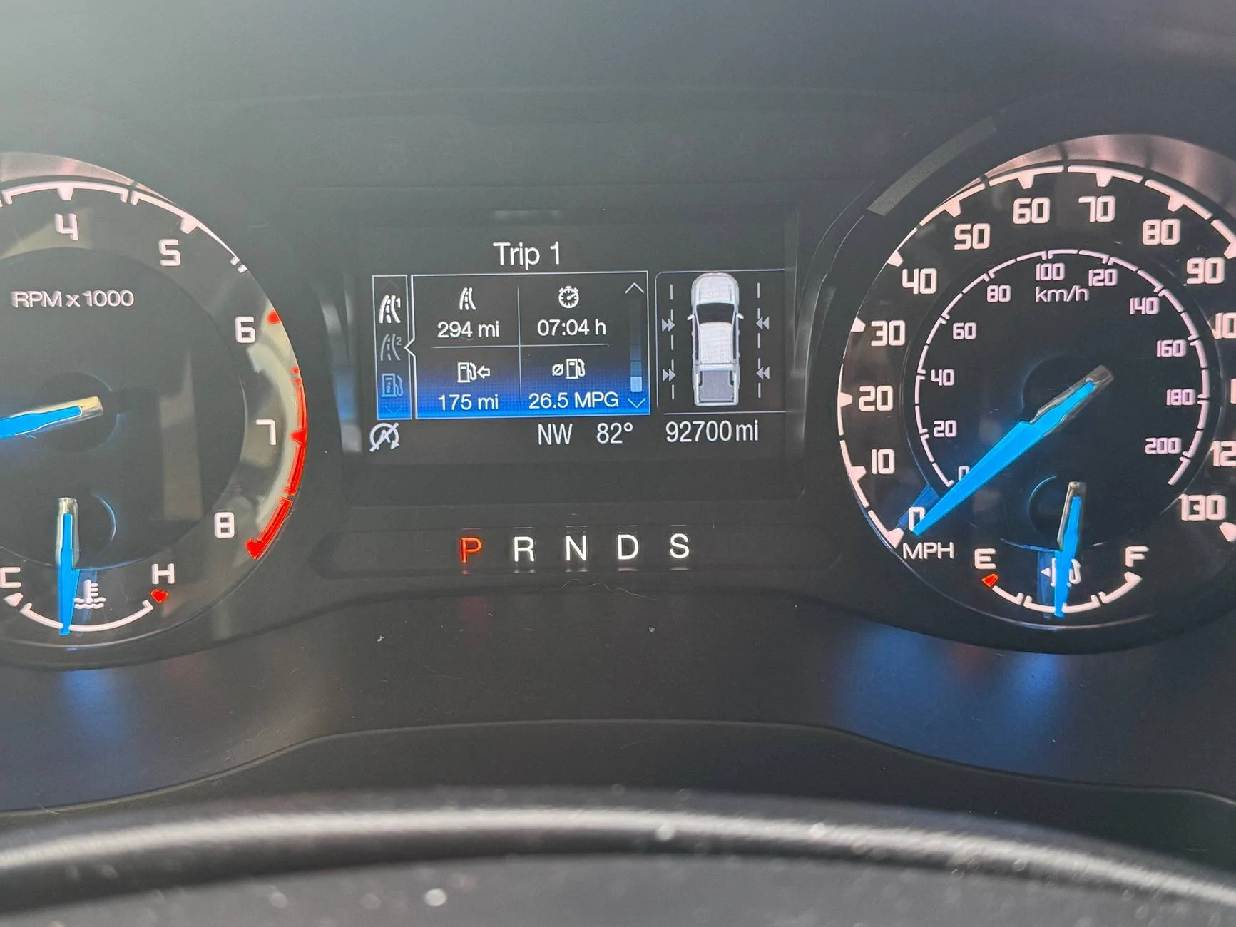

Included a pic of my week's commute to and from the medical center. 26.5mpg is perfectly fine by me. As stated earlier, OP asked for thoughts on the 2.7, which I gave, and mentioned that the transmission should be considered too. Maybe he will only keep it in factory configuration and not tow much, maybe not. It is something worth considering for most people.
