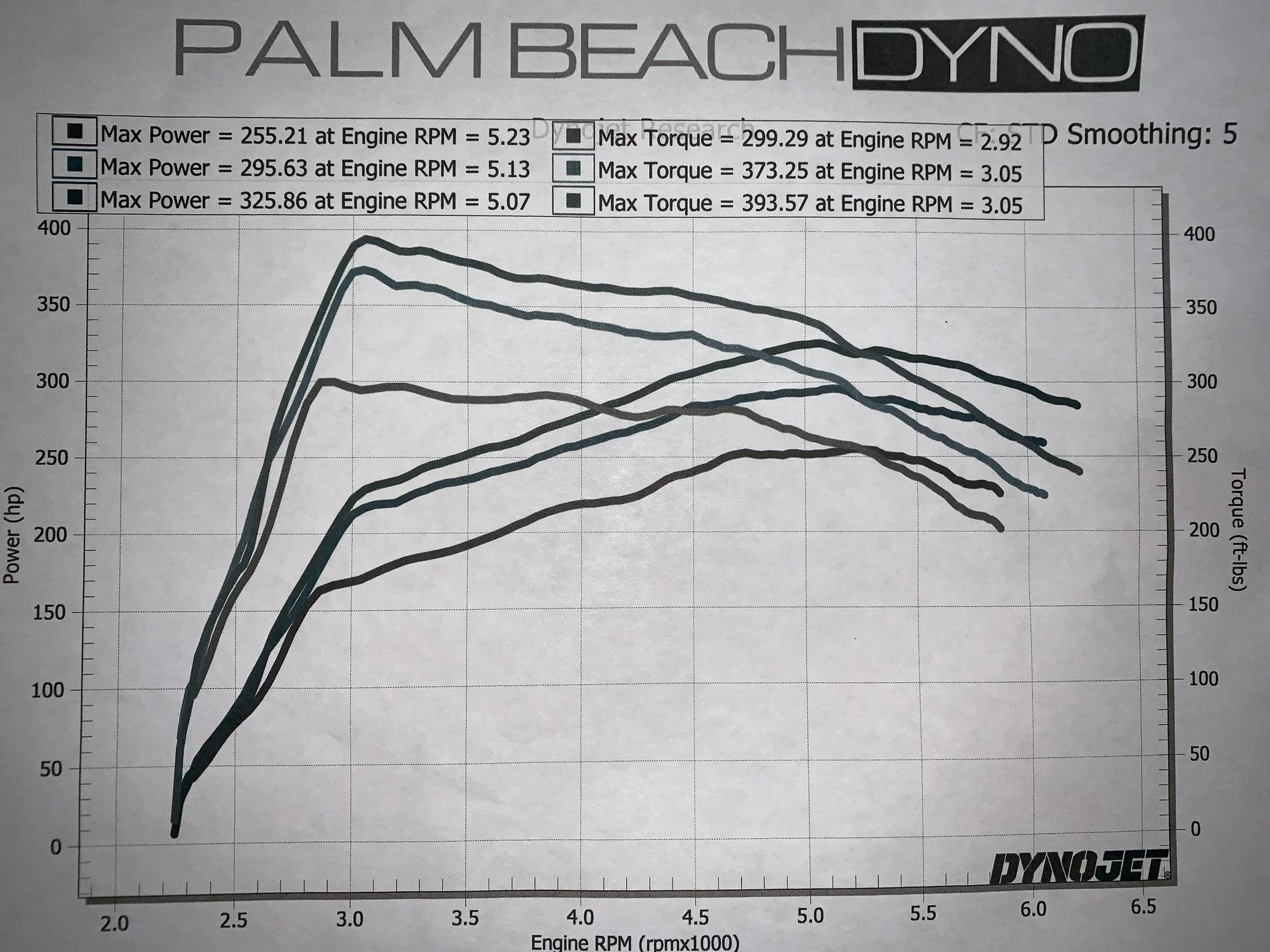

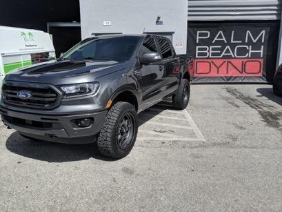

Just had some tuning done on the Ranger and she is a tire fryer!! very pleased so far with the results. I have a vendor that contacted me to set the bar on this platform and game is on. This data is all prior to that conversation and only the start. Attached is on 93 octane stock, tune, and tune with off the shelf octane booster (with AFE charge pipes and 3" cat back exhaust). These are all on a set of heavy Fuel wheels and tires. 0-60 is 5.7 seconds with traction issues. Stay tuned as big things are coming for this truck in the next couple of weeks that will require sticky tires and track time....and a good amount more power.
