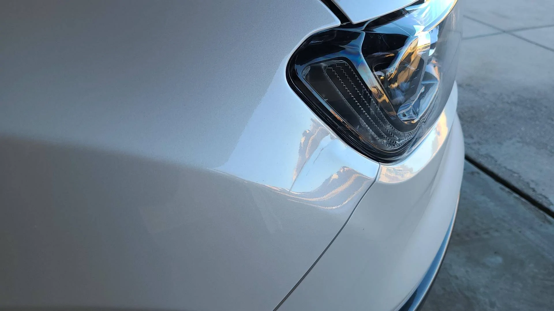

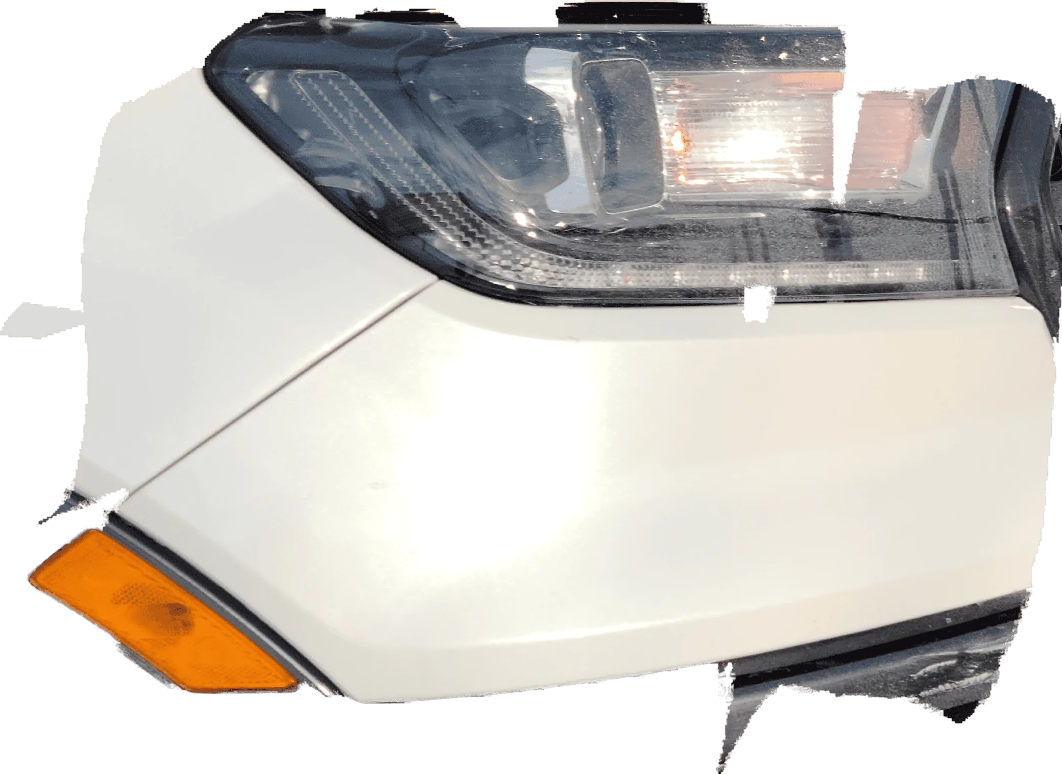

Cropped out that part from an accident scene pic. You can see it there when you know what you're looking for.
137,225
While washing the truck this weekend I found something new...
Top line is a shadow. Bottom line is a crease. Light appears to be fine. It has seen a few carwashes, storms, and temp swings. No drops or fog.
I was soo pissed. Thought the dealership did it Friday when it was in for an oil change. I saw no way that it could've happened in the accident or that I could've missed it.
I calmly went in and talked to the advisor that usually takes care of me. Asked if we could talk outside and VERY CALMLY showed him and explained to him my problem. My wife would've been so proud I kept the red headed devil locked away!
Louis showed me their "preinspection" photos and sure enough. I could see it in the pics. I apologized and we left on a good note.
Been using these dudes over a decade. So glad they didn't do it. But I still didn't think the white plastic piece could've pushed the fender up like that and was stumped where it could've happened.
I went ahead and put my virtual claim in including it as I figured that must've been what happened but I still felt uneasy, as if I was committing a fraud. Finally I remembered to check my pictures of the accident scene.
Can't attach it in this post. I'll try to get it posted. It's clearly there.
For anybody else check your fenders after even a minor center front collision.
At least it shows up in the accident scene pictures so the adjuster should easily bale to file this for you. I think sometimes we're concentrating on the larger damage we forget to thoroughly inspect the vehicle for smaller stuff. Good thing you caught it now before all the repairs were done.

Nice find! Much less expensive than other options and much more in line with the bent piece of metal that it is.
Exactly. Adjuster was sent all those photos the day after the accident as well. So we should be good as far as proof goes.
I had checked as far as the gap at the fender and that white plastic piece on top of the bumper. It looked perferfectly fine by Ford standards. But I had stopped there.
Must've buckled that fender enough to crease the aluminum.

Jesus man Stevie Wonder could've pointed that out to you, how'd you miss it?
And how are you going to get additional charges attached to this guy on the back end? You're not law enforcement.
D Fresh
Dec 10, 2020
6,272
13,576
Milkman
I'm just a milkman. Not an autobody instructor. If it's not a cooler on a porch I ain't seeing it.
In reality, guess I never let the light move over that area as I didn't expect damage there.
By speaking with the prosecuter when I meet with him before the court date for his careless driving ticket and informing him that the insurance documentation provided at the scene of the accident was fraudulent and that no insurance was carried on the vehicle at the time of the accident.
My wife works for another court jurisdiction and has informed me this is a POSSIBILITY. It is ultimately up to the prosecuter, however the court clerk has made it seem likely in our conversation.
I have no doubt I'll receive a restitution judgment for my deductible and rental car expenses. Wether I actually see any of that money is debatable. Additional charges would be the icing on the cake.
Considering my wife, who was driving at the time, will be accompanying me to dude's court date, and that she has a working relationship with many in the jurisdiction this occurred. I'm betting my cake will be iced to the fullest extent of the law.
Ok I gotcha, I thought they might be deputizing milkmen these days or some such up there in ColorAdo.

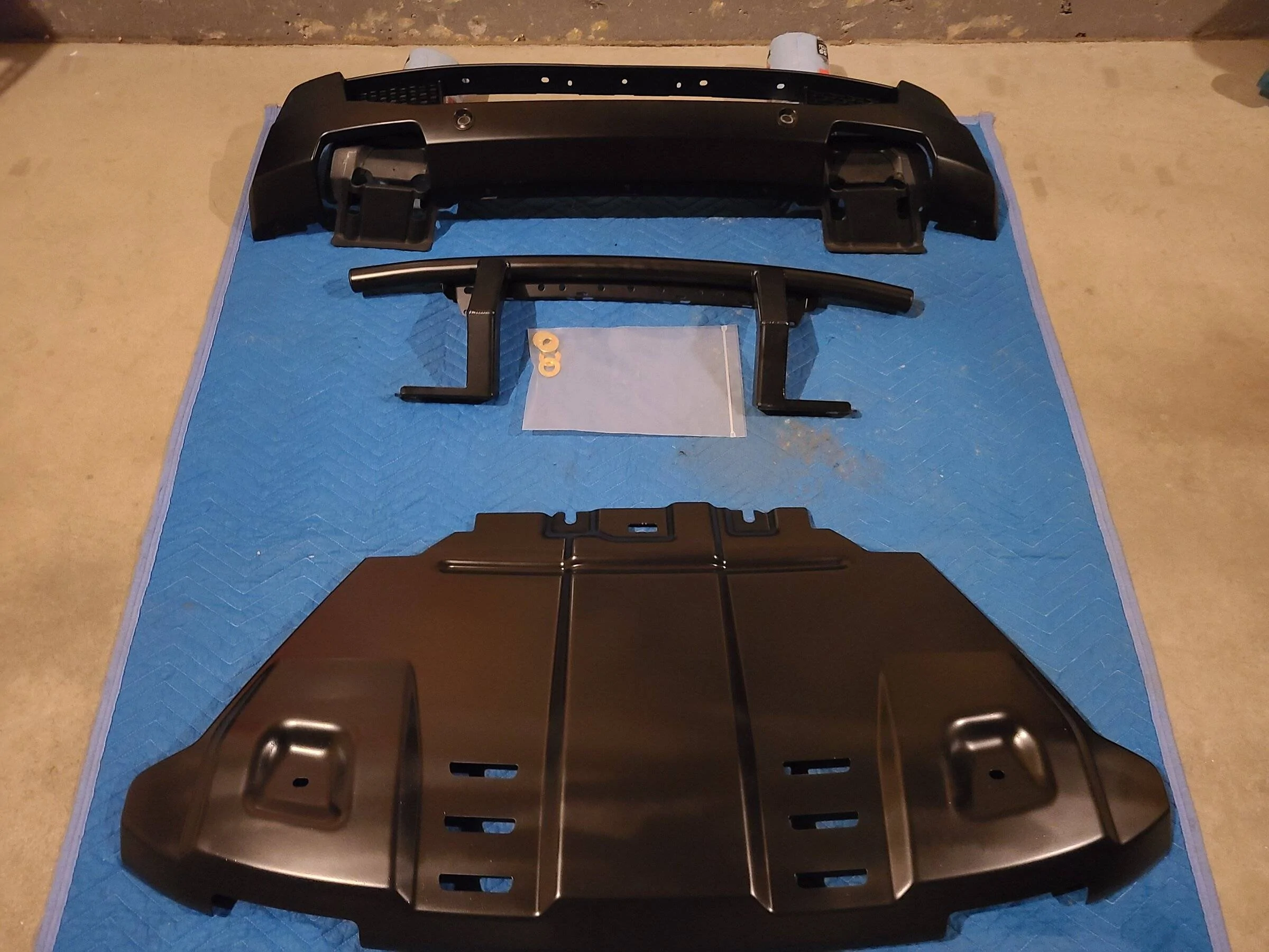

So truck goes to the bodyshop in the morning. Quite the wait, but I know, trust, and like these guys so it should be worth the wait.
Plan is to have them straighten and paint the fender crease, paint the plastic bit above the steel bumper, and that's about it. I've pulled the fascia piece and skidplate. I've got a new fascia piece in black, just need to paint the sensors and skidplate black. Also picked up the SVC lightbar to install. The bumper was tweaked a bit under the fascia, but all plastics should fit back on and cover everything up. We'll find out shortly.

Got a call Friday afternoon. Truck will be ready for pickup Monday morning.
Today I got all my lower front bits painted and put together. Should be a quick finish once I get her home.
