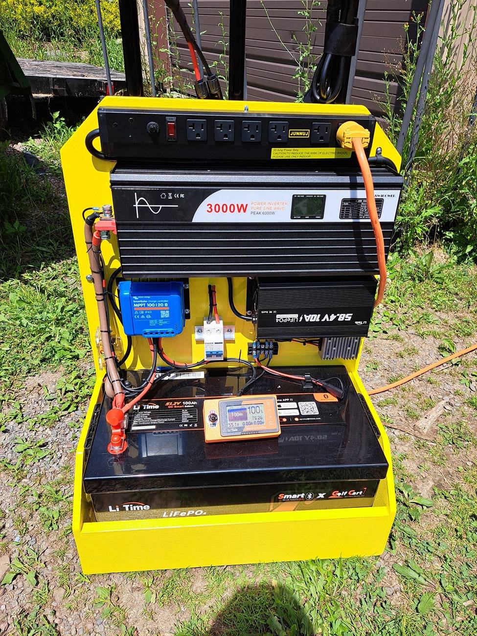

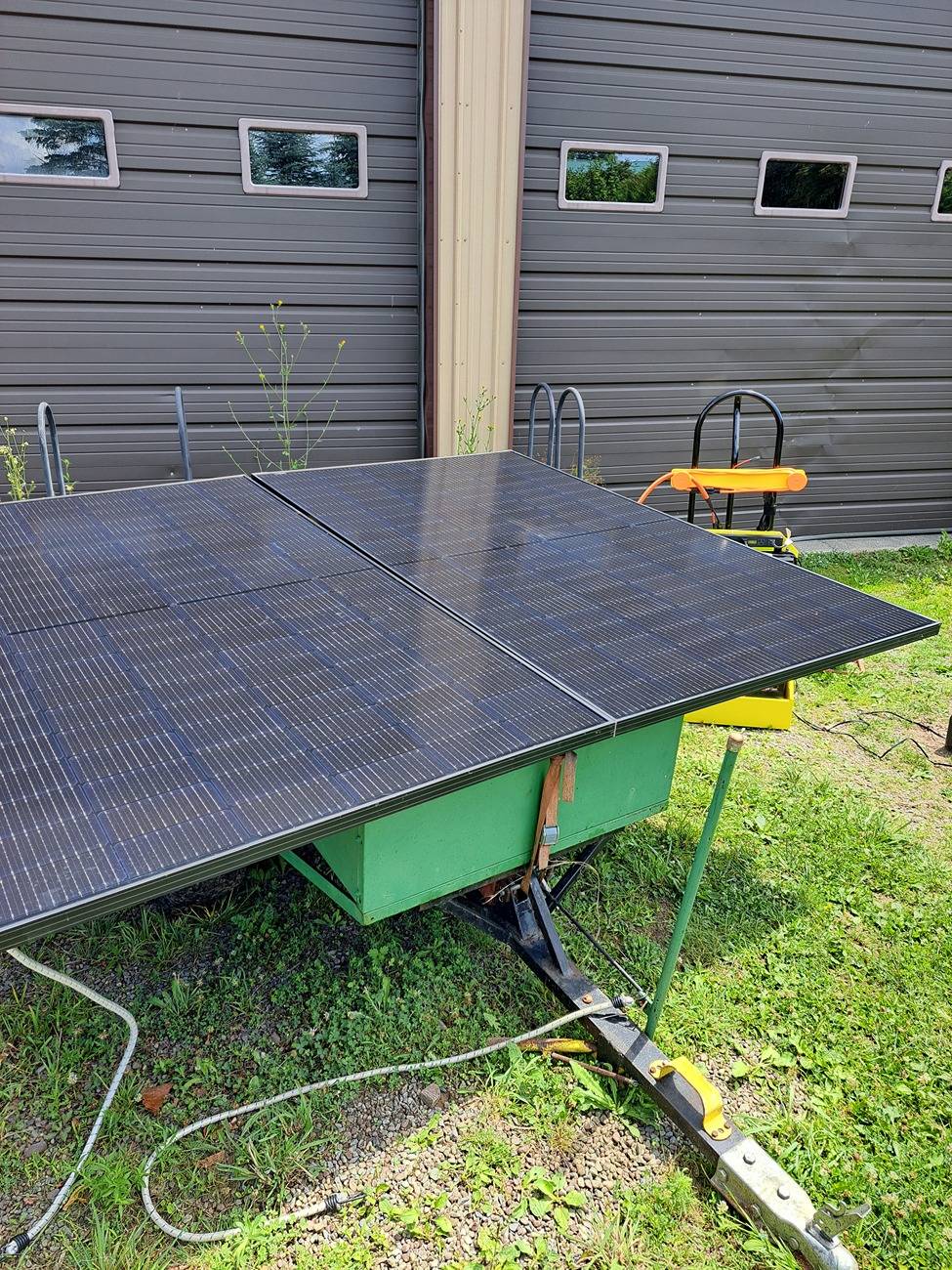

I just built this cart to get some data about solar. It has a 48 volt 100ah battery and 3000 watt inverter with 2 450 watt bifacial panels. I am able to run one of my freezers 24/7 with it and survive 2 overcast rainy days. I would say buy some parts and play to collect data. Buy batteries with ev grade a cells and a good BMS. Low temp cutoff is a good feature to prevent cell damage below 30 degrees. Do not mount them in the living area. Some of the 12bb solar panels are very efficient.

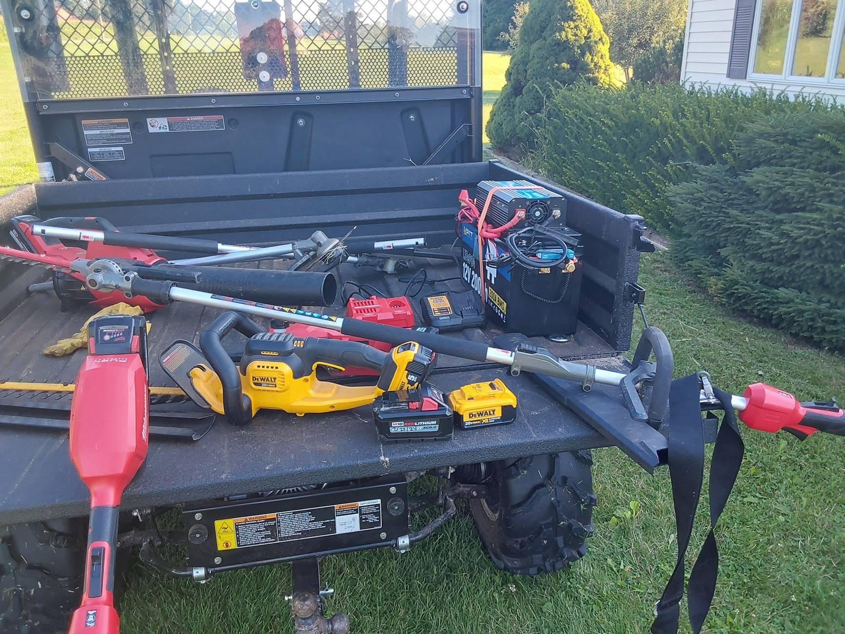

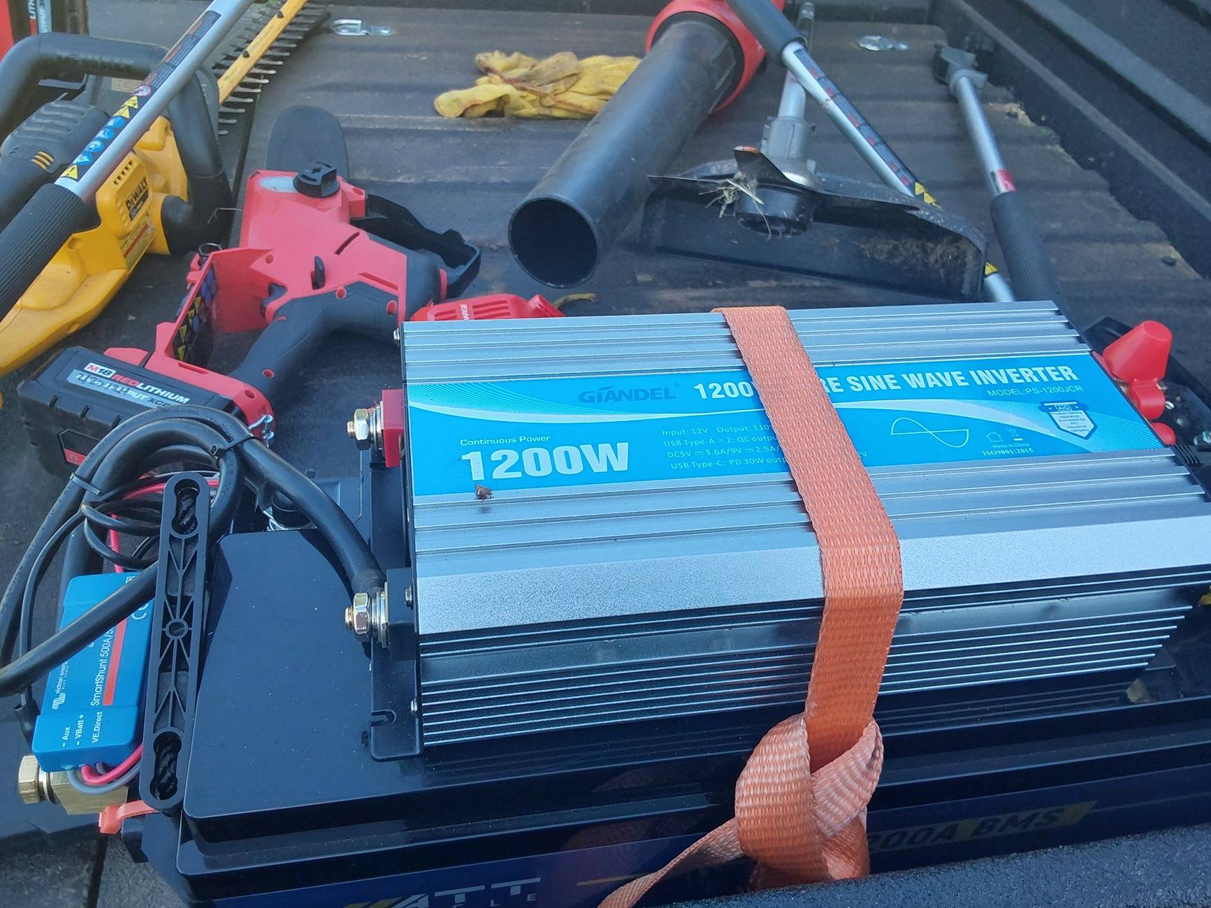

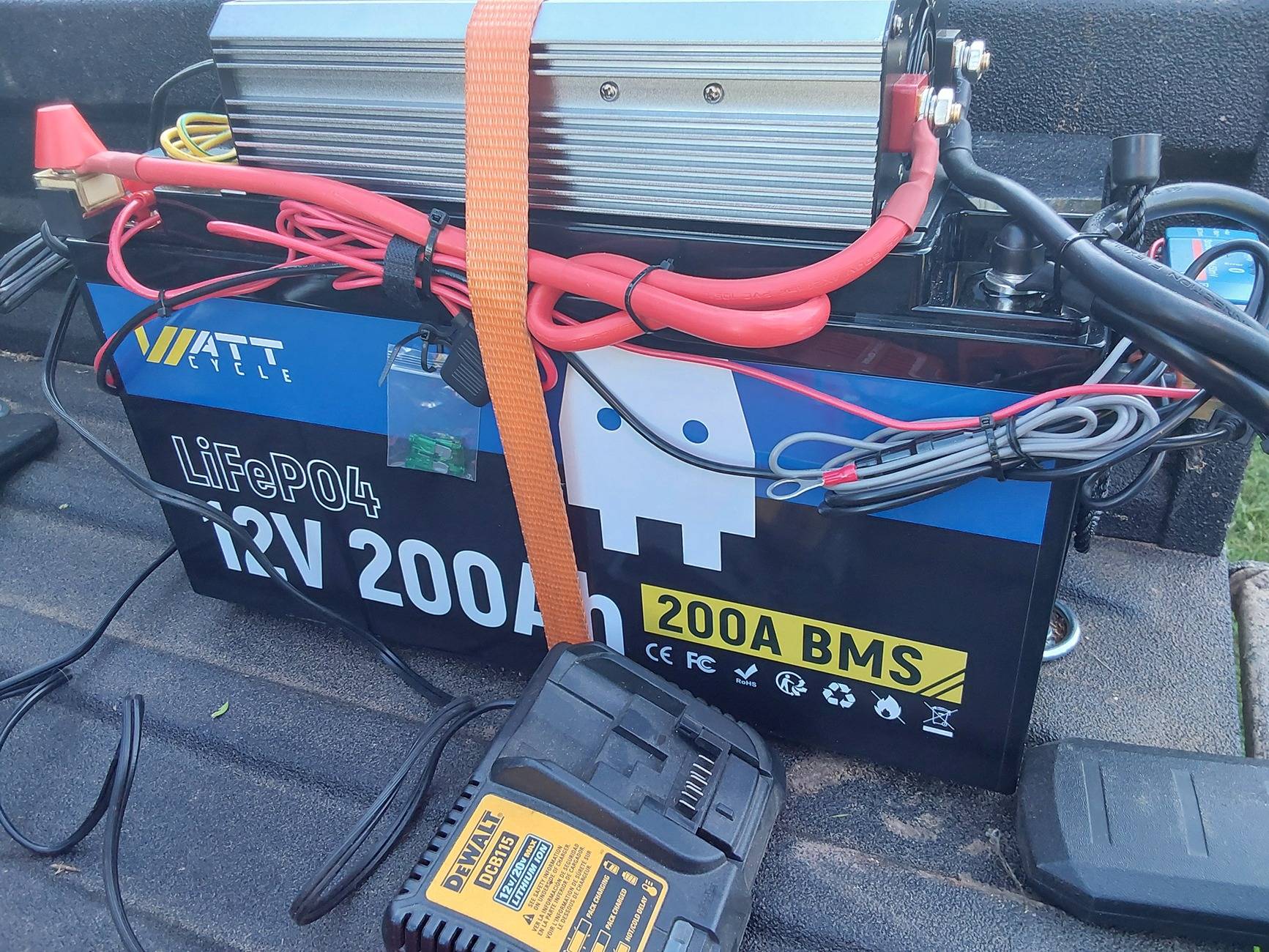

Here's the simple yard power I made. Just strapped a inverter and victron shunt on a 12 volt 200 ah battery and use it to charge ope batteries along with ac tools.
