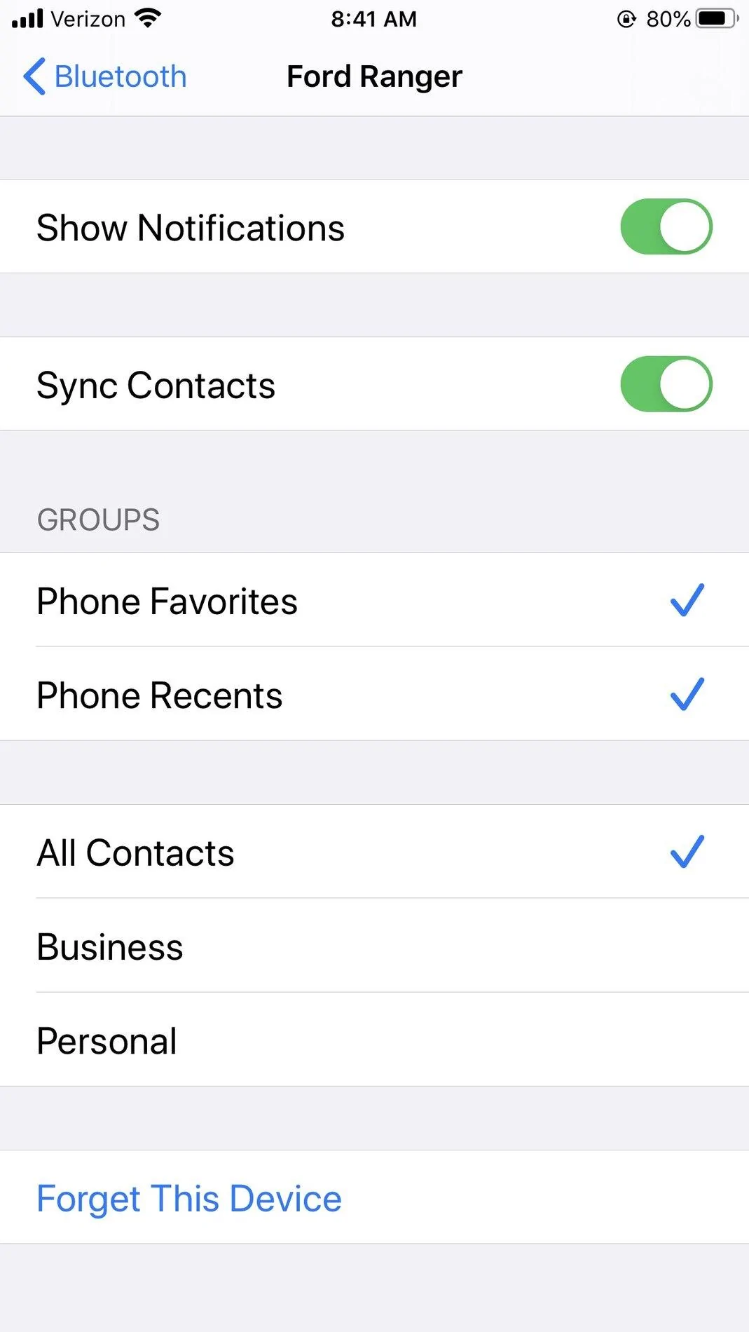

Bret, I just looked at my settings on the main screen and they're below. If you check "Voice Readout" it will automatically read them out for you. Since mine isn't checked I have to option to hear them, call back or cancel them. Also make sure the slide bar at the top is enabled. Hopefully this works.
Go into the phone app
Make sure text messaging is enabled
Check the voice readout if you want them to auto read them.

Bret, I just looked at my settings on the main screen and they're below. If you check "Voice Readout" it will automatically read them out for you. Since mine isn't checked I have to option to hear them, call back or. cancel them. Also make sure the slide bar at the top is enabled. Hopefully this works.
WOW Dave good info, I don't think I have seen these screens yet and i'm sure that's is where the issue is. Too much ice on the truck now but when it turns to rain I will check it out . Thanks, Bret
