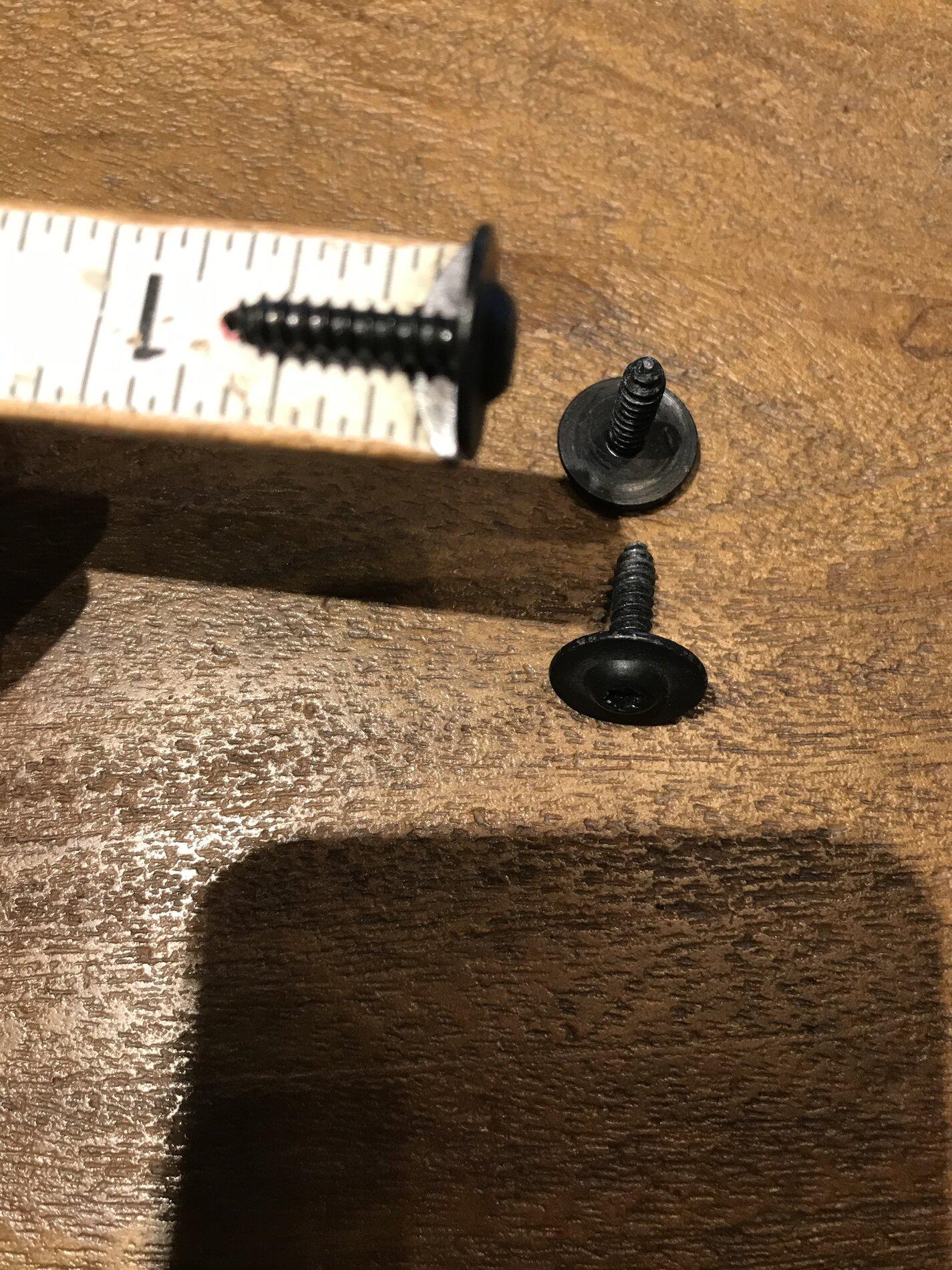

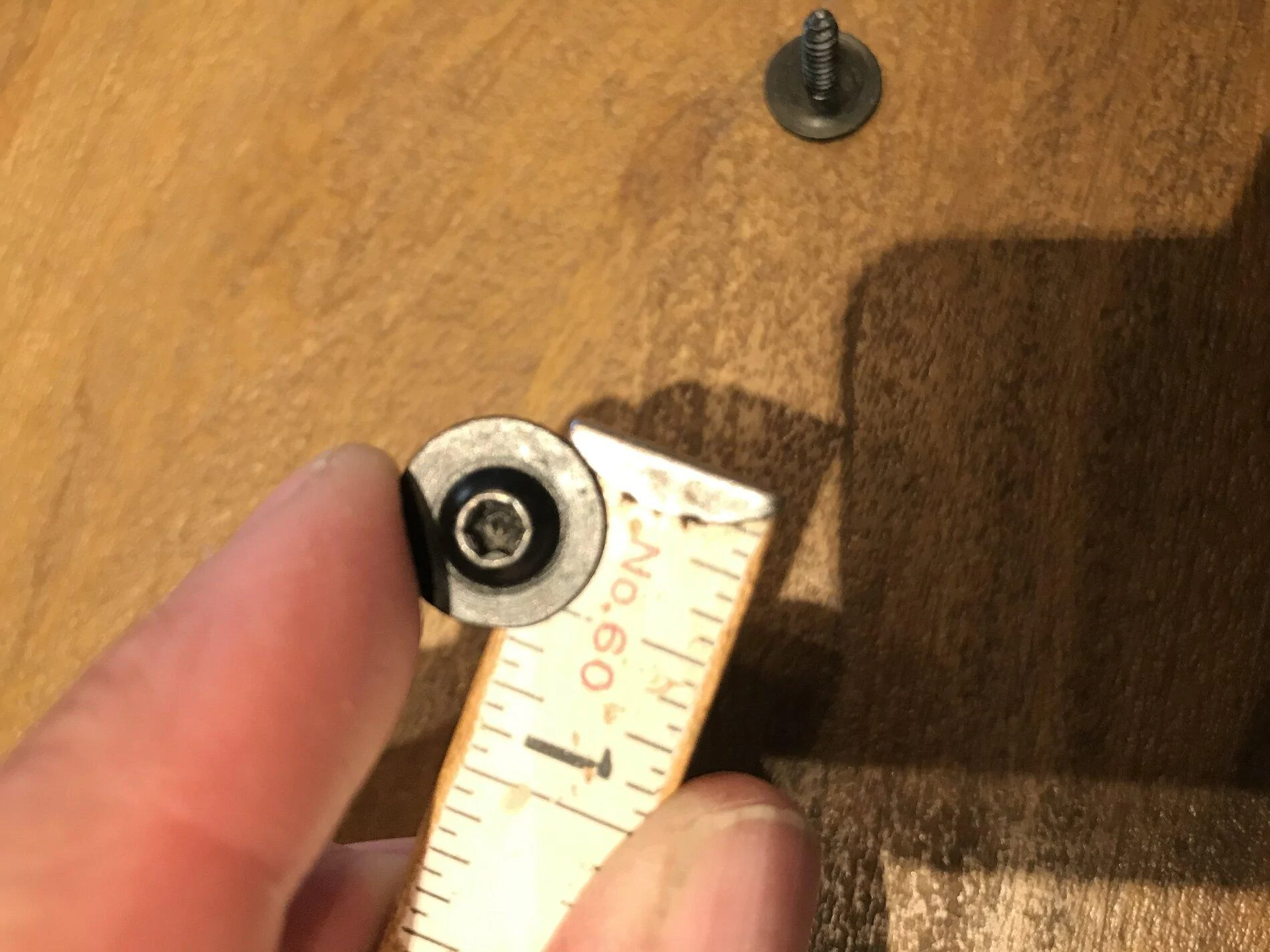

The original were screws with a torx (t-20) head. I'm the opposite situation as you - I need the screws for the tailgate cover as they are a "special" type of screw with a recessed washer head. Ford told me you only get the screws (for the tailgate) when you purchase the bed and tailgate cover. I purchased just the tailgate cover...so I had to improvise. Attached are pics of the original screws that you are looking for.
Hope this helps and if you want to get rid of your "special" tailgate cover screws please let me know.
--Marc
