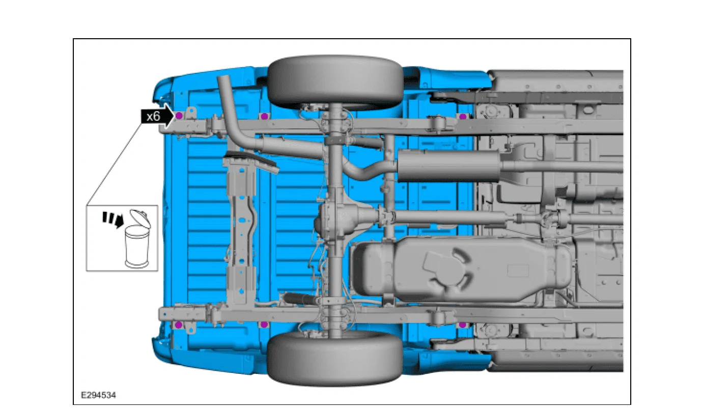

I am installing new bed side panels and in order to do that I need to remove the spot welds and refabricate,
So tail gate off, bumper off,
does anyone have a diagram or have pics where the bolts are located on the underside of the bed?
and how many am i looking for 6 bolts ?
maybe more ?
any help would be appreciated.

yes. the bols i believe are stretched when torqued or something unique like that, so they have to be scrapped after one use.
Damn! well ok this helps a lot thank you!,
any info on the removing the fuel cap? or do i have to reach up there and dissconnect the hose to get the bedsides off.
