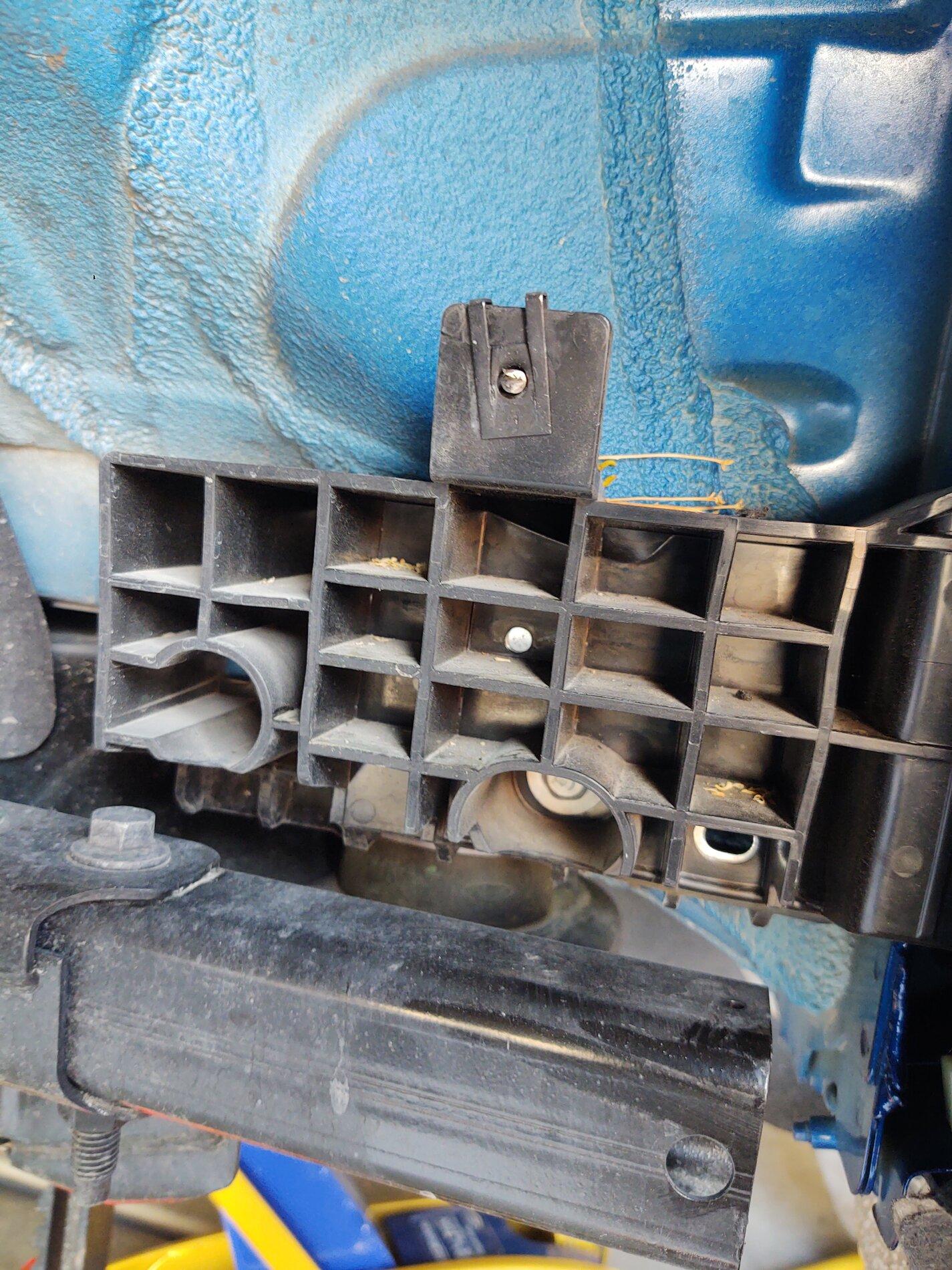

Trying to install the new crash bars up front. Took all the phillips screws and holders out. But I can't get it out. Help.
How do you get the crashbox out? Took the 2 bolts out. Looks like there's 2 more coming from the other direction. I can't find how to access them.

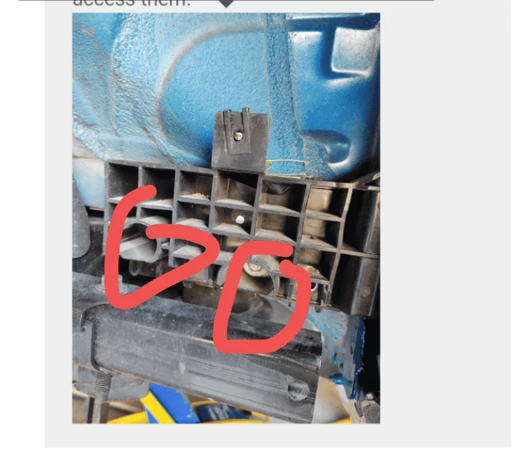

It's just a couple if bolts
Did you ever found out how to remove the box? I heard that the box protect some electronic for fog and head lights control
There's nothing behind it. Just a crashbox. It's just a few bolts. Look inside it and you'll see them. Easy to remove.
I put it back on just for the helluva it.

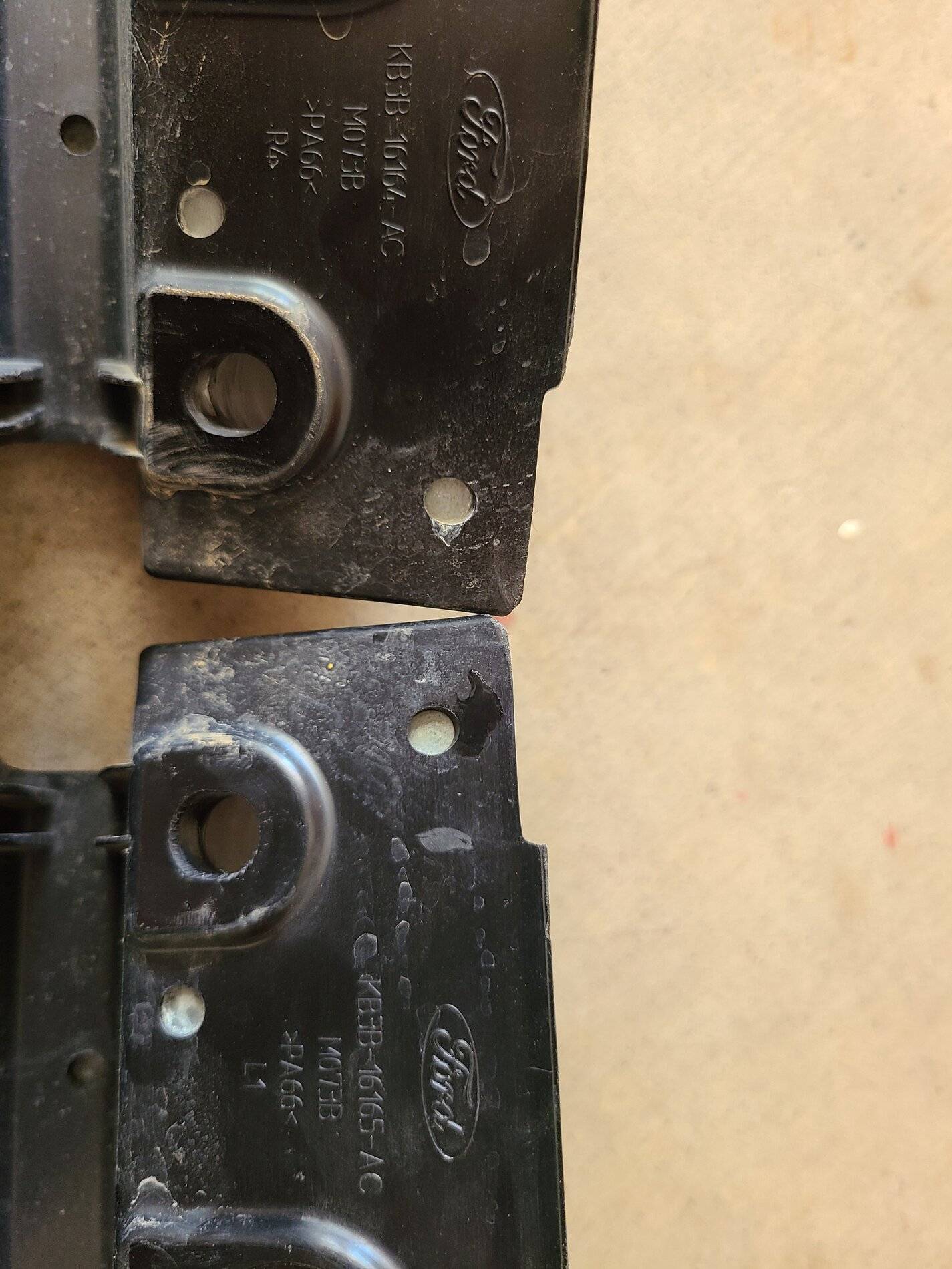

I got mine off yesterday, It had 4 bolts . Two on the left and two on the right.

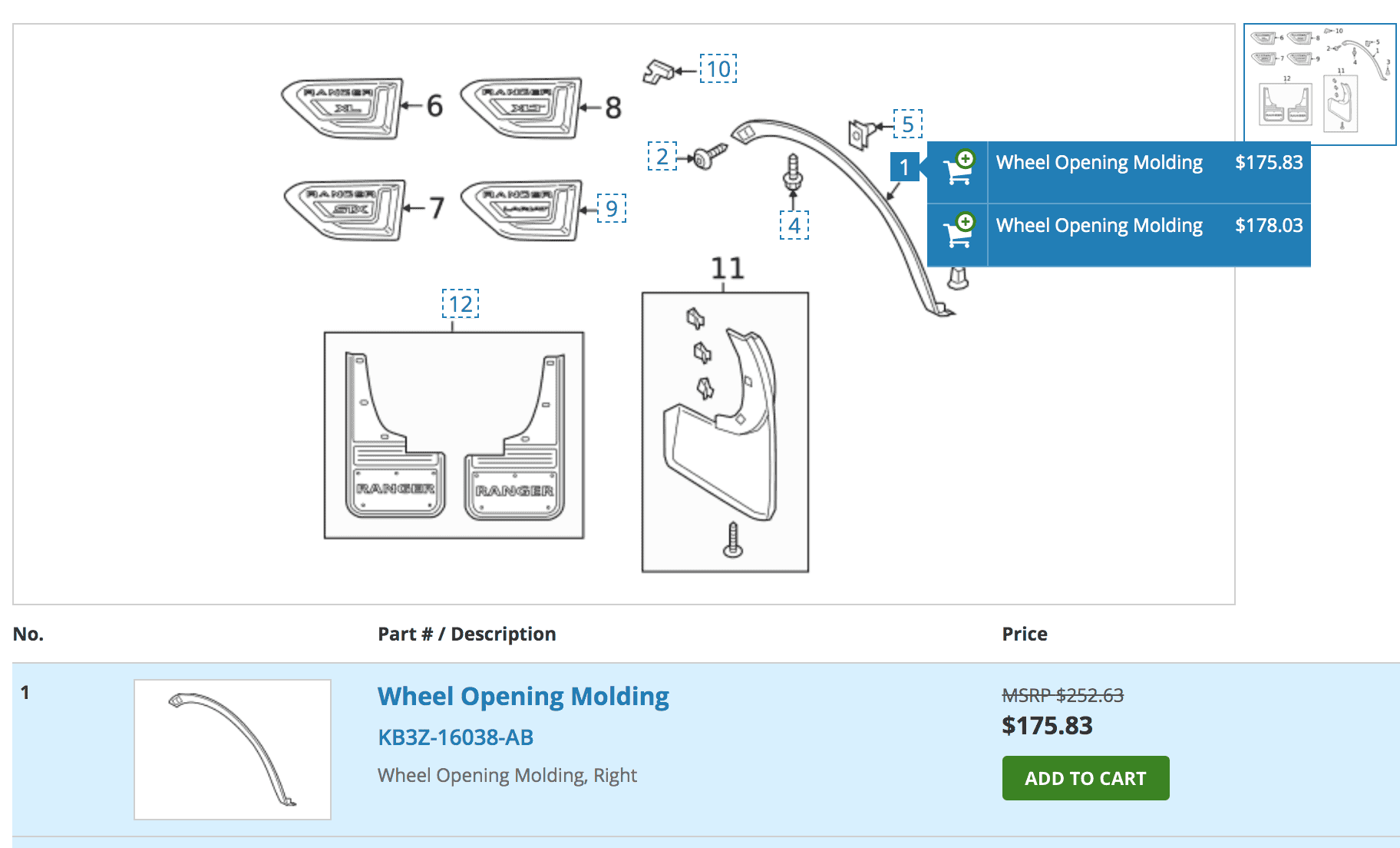

How did you guys get the wheel moldings off without destroying the clips? I struggled with that today and broke a few.
The blocking and crash bar access made sense, but I am afraid to try the next side until I figure it out.
You the fender flares or the felt liner?

I'm struggling with getting the lower half of part #1 off/on without breaking the clips on it. I've already broken a couple, meaning if I want it sit flush I need to replace the entire part. #5 didn't have much give :(.
